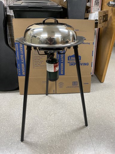

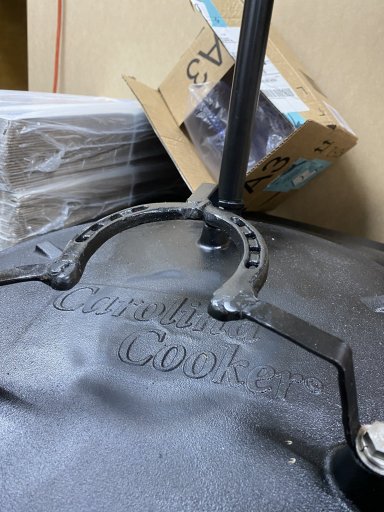

So I decided to build one and save the money. I also wanted to make it a little better . I built it from items I got off amazon . 100% Amazon . Total cost was just over 100.00. I did have to get out my welder and use it . My welding skills aren’t great but work .

Nice use of the preexisting threaded leg holes for your horseshoe holder. First picture had me wondering why you didn't just extend the legs. :grinning: My welding skills aren't that great either. I can make metal stick together though, amazing what a grinder will hide.
You did a wonderful job! It looks great!
