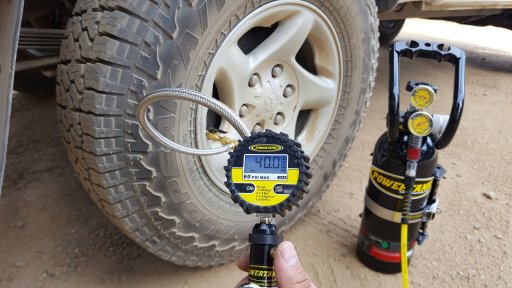

Personally, I use a 5lb Powertank and I love that I can fill my 32's from 20 psi to 40 psi within seconds. A 5lb tank can last me almost the whole year, but that's because I don't have to air down as much otherwise I would've opted for a 10lb tank.
If plans change, I'll just buy another tank. Removing the regulator is pretty easy anyway.

I have a 10# tank and love being able to fill four 35 tires in a few minutes. I can fill these tires 3 or 4 times with a full tank. If needed I can swap a tire with my impact wrench or run other air tools too. I like having plenty of air available for other things like blowing up a mattress or blowing the dirt or dust away there is plenty of dust in Nevada... lol
The cost? You can get a 10# tank for less than a $150... A fill up for around 20 bucks. So with the money I save over the cost of a $600 compressor I can do 22 fill ups or 352 tires...
You know what they say "One is none and two is a spare.."
I still carry my twin cylinder compressor for a spare. I got a tank because I was filling tires with my compressor it exceeded the duty cycle and shut down for about an hour after filling 3 tires so, I had to sit in the desert sun waiting for it to cool down... Plus it had taken twenty minutes to fill three tires.
So for me having both is the best of both worlds. Or I guess you could carry two compressors or a bicycle pump for a spare....
Either way they both fill tires so, it is up to you to decide what is bast for you.

I've had a 80cuft nitrogen bottle with a Victor high pressure regulator (200 PSI) in my Willys since I started building it in the early 90's. The small quality compressors were very expensive then and I used what I had and it's works great for almost 30 years now. I like nitrogen over CO2 because it doesn't freeze up when you use air tools in cold weather and never changes volume with temperature.
Sorry for the poor photo, I'm redoing the interior of the Willys and stuff is piled everywhere.

I daily carry air source is a Viair 88P. Works great for my samller stock sized tires. When I go out on trips I'll sometimes throw my 5lb CO2 tank in the back that I refill from my 20lb CO2 tank I keep in the garage for air around the property away from my compressor. On the trail the little 5lb bottle will refil my tires at least 4 times, and do it as fast as my at home compressor. I've never ran the 20lb tank out on the trail and for almost a year it was my shop compressor since my old compressor died. Regularly ran my impact gun and air ratchet off of it.
For what it's worth unless you just gotta have that Powertank brand name on your vehicle screw it and build your own setup. You can find used CO2 cylinders of various sizes for well under 100 dollars, I got my 5 lb bottle for 40 bucks and my 20lb bottle for 60. Just make sure they have a valid Hydrotest date or you'll have to fork over 30-50 more dollars to have it hydrotested. You can get high flow regulators off of Ebay for 70ish dollars.
Then instead of trying to find a place to refill the fancy powertank cylinder on the spot, you just go to a welding supply or gas supply and exchange the tank straight out. Take the hundreds of dollars you saved and put it in your gas tank.
