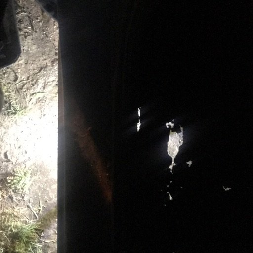

that's not so bad...seen worse.
i would check your front body mount though, it's kinda close to that hole. after beatin' on my crew for 20 yrs it needed new rockers and a piece of floor exactly where yours does.
for the size of hole you got , i would just use some flat stock, much cheaper than buying new floor. i put a channel in mine and just welded it in. it gets covered, so looks aren't a priority...

There are more than the big ones, but can’t really see them with out a light underneath, and even with flash off they don’t really wanna show up well, not really that worried about the noises except for maybe the doors, wasn’t planning on putting carpet or rubber floors back in, just staying with the bed liner
i'm not much for bodywork either. i did the metal work myself and then let my buddies shop take it from there....even if you cut out the old rusted and clean everything up and get it ready for welding, you'll save lots of money- prep is what costs, takes little time and effort to burn the pieces in.

I’ve got a small flux core welder, I’m not a bad welder at that, just not confident enough to fab the spot under the door, as for the rest, already have floor mats in it, the last truck I had was a 1978 Chevy Scottsdale, with no floor covering, just bare metal, got to hot on the feet during long drives, so floor mats were a must
Edit: I finally got a better look at the before picture of the floors in your crew cab, and your right, its not much different than mine are now, I know I can do the main floor pans, but I'm not sure about the rocker, that still has me a bit nurvis
