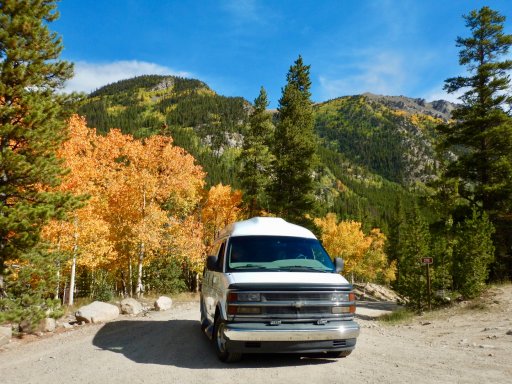

I did all the work myself except the brakes and airlift. It’s been a work in progress thru the years with what works and what dosent. When searching for the van years ago the main requirements were a hi-top, White because of the Fl. sun, 350 small block and 3/4 ton. Looked for months but couldn’t find a 3/4, all the van conversion companies usually use 1/2 tons to cut costs. The airlift definitely I a huge asset with carrying gear and trailering. It lifts the back around 4”, the HD brake system solved the small brake issue, things are massive.
AWD wasn’t too common back then, but seriously it’s a truck. It has more ground clearance than our Subaru Outback when you look at them parked side by side. When considering tires road noise and wear were a major factor with 98% of the miles would be hard road and highway. I went with Michelin Defender M/S. I never had a issue on any State or Forest road. We have been all thru Colorado and was even on the Alpine Loop. The van is a great base camp with all the comforts of home and when it’s time to strike camp after a rainy night,packing up wet gear?,we pull the plug and were back on the road. We take our Outback or when in Colorado rent Jeep Rubicons weekly in different sections of the state when we want to get deep in the back country but the van gets us 95% of the way. Renting sure beats car payments for years, high insurance, maintenance, impractical daily driving.
Sound like a van would be perfect for your work and office, lots of great and unique designs out there. If you have any questions for your build give me a shout! It really wasn’t a lot of $$ to build, sure beats dropping $175k for a new one. Pix is the Loop in Co!

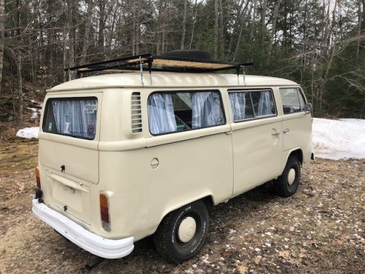

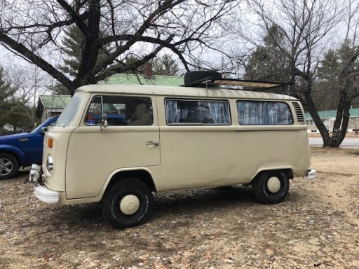

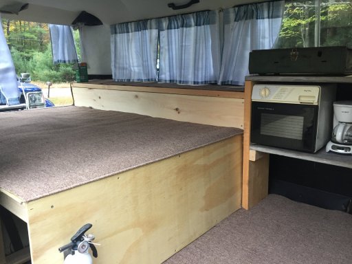

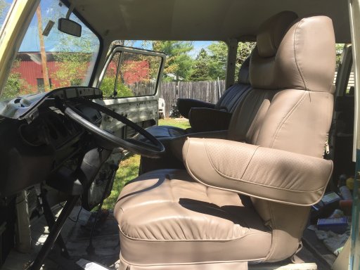

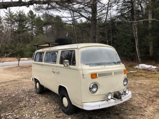

Hoping to be at the point to hit the trails this summer. Feels close until I look at my list :(. Yes, that is overspray on the windshield, it is delaminated and cracked so I pulled it out, cleaned up the pinchweld, then set just the glass back in for paint. Saved having to mask off that complex curved area. I love the front seats at the butt, but will be coming back out and stock going back in. As comfy as they are, they change the vibe and feel behind the wheel. I miss that VW bus slouch over the wheel :). Still have to wire the house, finish the cab area, replace windshield, bleed the brakes, replace muffler, and a bunch of little things.
