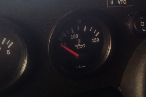

This is my oil temp gauge and you can see the on off on switch on the right side of the photo. Both sensors are wired to that switch and then into the gauge. So I just select easily between engine oil temp and transferbox oil temp here.
Reactions: genocache
