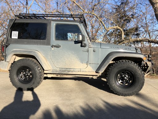

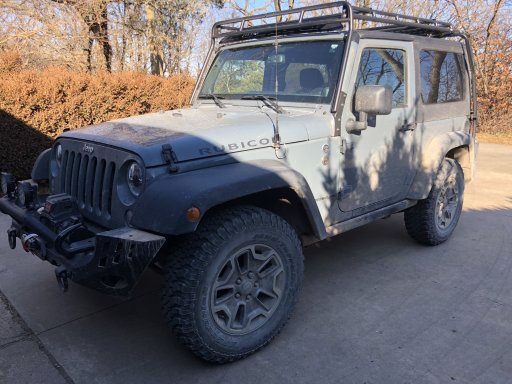

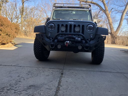

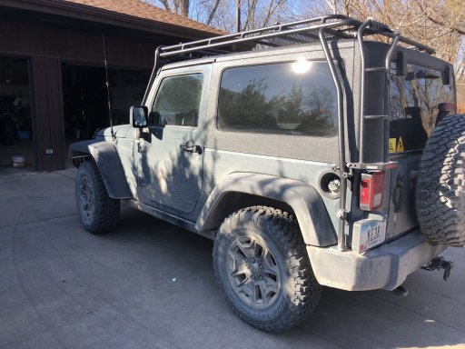

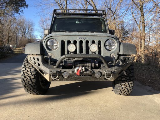

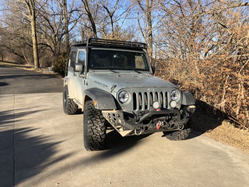

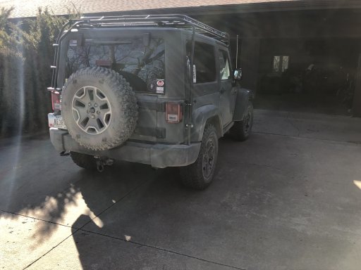

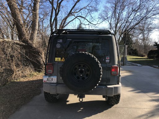

As mentioned elsewhere in these fori, I have decided to 'widen the stance' of Ruby a bit, since I will be installing the RTT soon. Ordered some steel 16" wheels with 305/70R16 mud terrain tires from 'The Tirerack' last week.
They installed the TPMs, mounted and balanced, and then shipped straight to my door. They arrived last night (UPS is running really late these days :) ). Installed them this afternoon...
Before (option OEM 17" alloy wheels with BFGoodrich 255/75R17 tires):
uuQIX4blS0GidvPMErYbcQ.jpg 40JTs3n+Tom6wOXFSHt6hg.jpg tcNkwxfATvyF9z6EpqAlBw.jpg %uVihPGuQ%GdoFA2tYrfVg.jpg
After...
ZqVVr%uVRlutjLTkgpjEbQ.jpg xIARag1+Qk6aByVVuIC7Zg.jpg WXH7Qq8gT9qSTnne9n3IRg.jpg jpaNYllPQIePG0Z5dJbK+g.jpg
What do y'all think :) ?

Looks like I don't need to replace the spare tire carrier right now either, although I did mess up and forgot to put the hubcap on the spare when i put it up there. Too lazy to fix right now, though.
Still 'thinking' about replacing the rear OEM bumper with one with integrated spare carrier, and possibly some fuel carry options...
One thing that just popped into my mind - what should I run for pressures? With the OEMs, I had 36PSI in all 4 on pavement; on the trail, I usually air down to 20-25PSI; should I run these tires at the same pressures?
