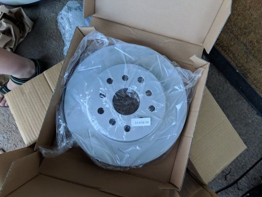

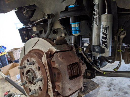

Whole buncha updates!! My jeep needed some new front rotors so I decided to go ahead and get a big rotor kit and also replace the front brake lines... Huge increase in stopping power!

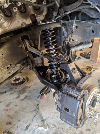

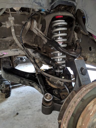

Here it is with the coilovers installed doing test fits... spoiler, it didn't work out. The shock had another inch of down travel and the ball joint was binding. Whoops... Update to this situation down the thread!!

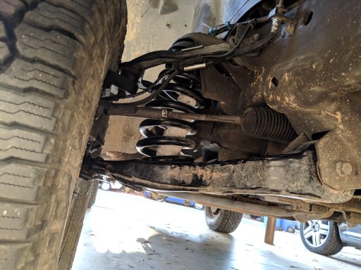

Back to the stock-ish setup...

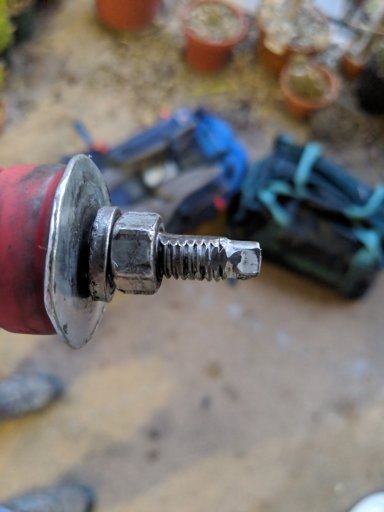

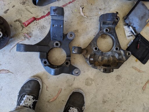

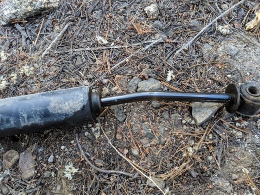

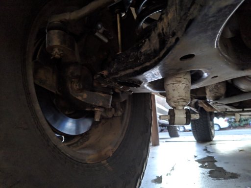

Soooooo.... after the trip we got home and during post trip inspections we found the front passenger shock decided to liberate itself from the coilspring mount and then go play with the spring,.. both lower bolts failed, so yeah. got some fixin to do. LOL
So... Last week I ordered some steel segments and sketched up a new upper coilover mount to go onto the top coil bucket. its VERY stout steel and the bracket is well made... So it'd be good platform to build a tower on. I'll be doing more measuring and test fits and so on. gonna start on a cardboard mockup soon to start doing fit checks and interference checks n all that good stuff. Yeeehaw!

LOL the carnage! Maybe that clanking noise wasn't coming from my truck afterall. :tearsofjoy:
So glad you 3 came out!
HAH, she was wondering why it was acting funny around some corners on the way back and uh, it made more sense when we got under it at home...

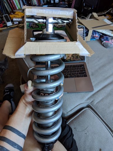

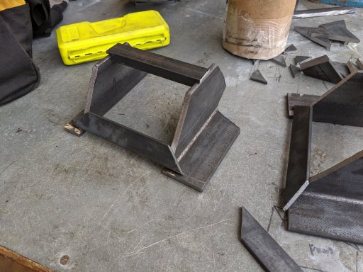

Welp, after a few more revisions of the upper shock mount bracket CAD model, i got to a point where I was happy enough with it to start making a drawing of the parts to make it and then I built a very rough cardboard model to start working out the overall interfaces of this thing. I still gotta check the clearances on the truck and to see if the upper coil bucket is going to be able to support something like this at all. I also need to crunch some numbers with the shear strength of the 1/2 bolt used for the upper mount and figure out if want to do some big ol spacers to support the location of it or if want to make some inner tabs to support the upper shock bearing. WEEEEEEEE.
Up next I'm going to do more checks on the truck and model the upper bucket to see if I even have space. There is still the change i'll have to just scrap this all together and cut the bucket off totally and weld a full on tower onto the frame. Of course that brings up a whole new set of issues, as we're planning on installing a camburg midtravel kit on this truck here soon and if we do that it'll mean incorporating all of my upper mount changes to work with that kit. The downside is it'll way add to cost but the performance will be worth it.
Esp with how she drives, LOL.
I also have small block for the rear coming for this truck, and the plan is to remove the overload leaf from the spring pack, add another short leave and then put the block in and see where it sits. I really want to go with a slightly longer shackle in the rear as that'll help down travel a bit. I'm sure i'll shortly have to deal with driveline stuff, brake lines and shocks going down that route, but who knows. The Rancho shocks that are on the rear are behaving OK but a upgrade to some mono tube ones is planned.

Welp... that didn't work, haha. Got some model changes inc but it should work out in the end.

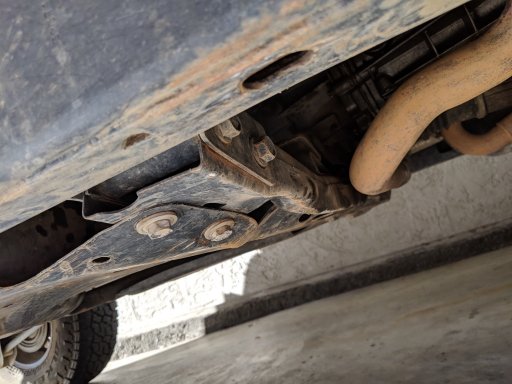

Some of the post trip carnage to my gastank skid and to the transmission crossmenber.

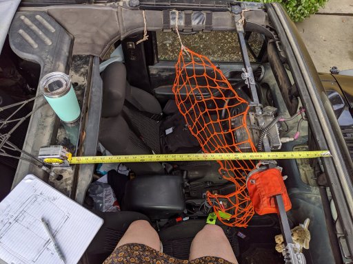

Finally got around to getting some projects going... FIrst, the heep. I started measuring and planning a new overhead console for the jeep. Want some more switch space, more radio space and some better storage options. plus a place to put patches. IMG_20191209_125800.jpg

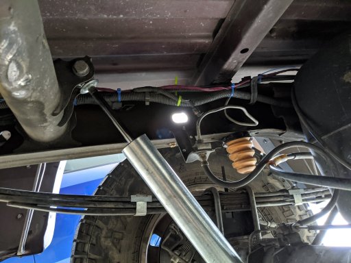

Got some rear lift blocks in the rear installed which brought the rear up and level to the front so no more negative rake on it. I'm getting ready to start on some of the bumper stuff and I have some fender flares. Sometime soon near rear shocks are going to go in as well the rears are, well, not quite long enough now.

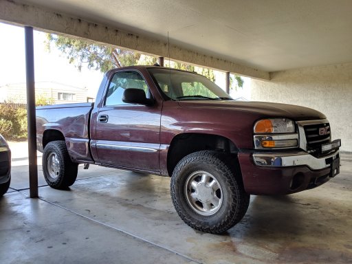

Got a major amount of work done on the front end of the GMC... they're no fox or king coilovers, but its still a huge increase in control for the front of the truck.
I still have to get some brackets fabbed up for front limit straps and find some UCAs for it but so far so good.
Also did a front end alignment on the truck, relocated the rear brake line (I really need a tube bender) and got measurements so I can make a spacer and get some taller/more progressive bumpstops for the rear. Relocation of the shock mounts and building a more progressive pack will happen at some point as well as ditching the block. So far it drives a ton better than it ever has. Next to do on the truck-o is getting some storage boxes for the rear done, some bed rails inspired by @JCWages , cleaning up the bed slide, and adding some water/fuel storage...

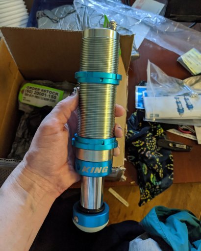

meanwhile... when a box like this comes in it's going to be good...
inside:

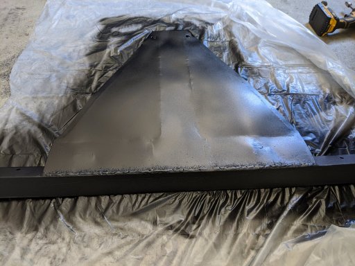

I also picked up a welder finally... so, there is going to be some truck fixin' soon. I've already put a basic front skid out of some scrap steel for the GMC, I'll have to re-do it at some point because my welds look like crap and I'm generally not happy with how it turned out, but... its on there and adds a degree of protection that wasn't there before so thats good at least.
during paint:
