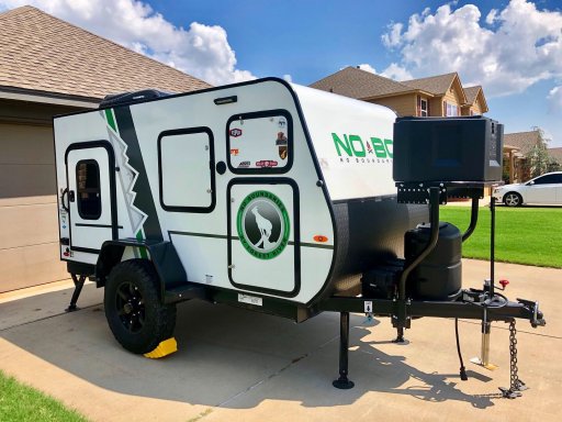

Very cool. I like the door above the stove slide out, I guess it accesses the storage area inside pretty well? We store clothes and towels. etc up there in ours and being able to open the door and grab some towels without going in is pretty sweet. The rack over the LP tank is nice. I see the power jack was removed and a side mounted hand wind replaced it. Good move. The power jack is more of a pain and very unnecessary for such a light unit...after seeing this, I am DEFINITELY swapping mine. I bought a 30amp twist lock and put a 6" pigtail on it with a male 120v plug on the other end. Now I can run a regular extension cord to the unit and plug into the pigtail. I find a 120v 20a recepticle is plenty for the a/c. and easier to find a regular outlet if youre not at a campsite with 30a plugs. You have a very fun and very capable camper!I picked up a 10.6 a couple days ago and just saw this forum and you all have done some awesome work!! I can’t take any credit but here’s a picture of the added storage box the previous owner added, you can take off the plastic container and flip the metal base to become more of a tray with tie down holds. I’m thinking about flipping it into a tray and strapping down a small generator, any thoughts...both on if that’s smart and also recommend the generator with enough power for the A/C unit? I live in Oklahoma but travel all around the SW and Arkansas so A/C is needed a lot and we stay fairly primitive. You can see he added an additional door above the cooler/stove that goes right into the storage spot in the cab, no water leaks from spraying it with a hose. He also added a telescoping ladder to the back which is not only used for getting on the top, but also used as the same concept for holding the ramp up when folded in and has a ratchet strap to the bumper so with the right angle outward and downward pressure it won’t collapse.

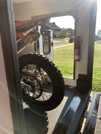

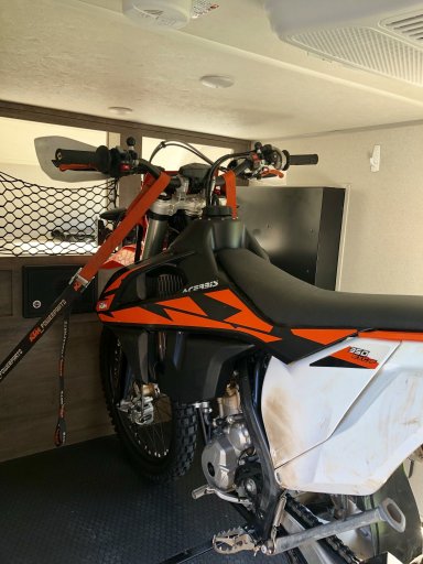

Also, I’ve seen some posts about dirtbike size and I have a 2018 KTM 350 EXC stock height and bars and it fits just fine. It was much more easy getting it in and out than I thought. Granted, I’m only 5’9” but thought having to get the bike up and in while crouching would be a pain, not bad. View attachment 116042

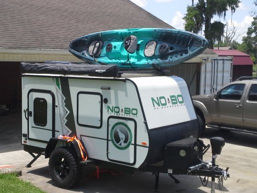

Very cool!!A few photos of the other additions. Quick question though, I have the installed permanent roof rails (seen in photos) , which model of crossbar fits into those so I can use the supplied rhino rack kayak mount? Previous owner had an entire full covered rhino rack for his RTT but kept that so just I’m just needing the crossbars to attach my kayak. Thanks in advanced.

mine came with these bars and kayak rack, i added the aluminium angle mounts for a low profile way to have solar panels on top and still use the crossbars for gear. also have the bat-wing awning mounted to the barsA few photos of the other additions. Quick question though, I have the installed permanent roof rails (seen in photos) , which model of crossbar fits into those so I can use the supplied rhino rack kayak mount? Previous owner had an entire full covered rhino rack for his RTT but kept that so just I’m just needing the crossbars to attach my kayak. Thanks in advanced.
