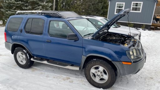

So I bought it and it does need work, the chain in the tcase is lose so it needs a new or used one and already priced one and my brother will install it. It only has 119850 miles and came from Oregon so it’s rust free. Got it for $3,840 out the door.

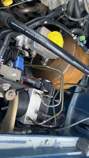

Thanks guys, some more pics. Looks like some new lines ac and break booster was replaced just looks so clean from what we are used to around here
very nice! sounds like you got a good deal and its a good looking rig

Tomorrow it’s going into my brothers shop for a full inspection, hopefully I didn’t get screwed over! I drove it 60 miles back and didn’t really feel like there was any major issues it had a little slop in the steering but it was quiet otherwise. Transfer case or front differential is the only thing I’m worried about but looking at parts it won’t be too bad if I do need to replace one or the other or both. I guess to get a 2 inch lift it looks like torsion bars and and add a leaf, shackle lowers or full leaf pack.

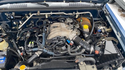

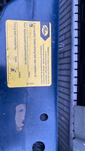

Well we figured it out after a few hours, the hubs are blown and someone changed the rear to the lower gears. So I need to figures out what hubs to get and I already have a rear axle with 29k miles with the correct gears. I figure I can sell my 4.6 axle to help pay for the other one. We did look it over good and found it was take car of tho, New oil pan, timing belt, water pump, wires and plugs, new tires.
I'd give the driveline u-joints a good look see; chances are with different gearing they endured some higher than normal stress (if used a lot in 4wd I suppose). Are the hubs manual?
Thanks for update!
The hubs are stock auto's, with the truck in 2wd they click and pop. Looks like the warn are 250 bucks.
