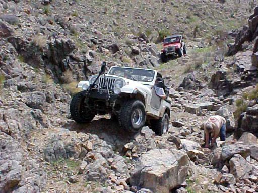

Heres a pic of my 79 CJ7 in the later 80's with a mechanical locked dana 30, 4.56 and 33" tires. Like I said, the dana 30 held up to me.
