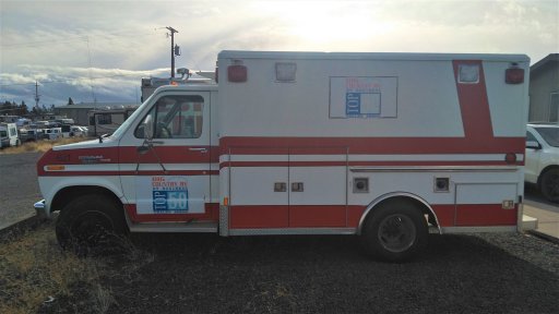

With both Jeeps, the Ram and the offroad trailer pretty much finished and recently selling two other 2 vehicles and my motorcycle, it was time to look for a new winter project. We were toying with doing the Sprinter conversion thing but I can't justify what people are getting for a used Sprinter with 250K and a Sprinter really isn't my style anyway. My wife stumbled across this for sale locally on the internet this morning and we picked it up today REALLY cheap. Plan is a complete camper conversion inside using most of the original cabinetry with a desert tan and black paint scheme for starters. Later possibly a 4x4 conversion. Nothing super radical on this one, we want a dependable long distance cruiser for mild adventures and traveling . Will post updates as we go.

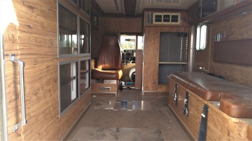

We got Unit 621 delivered to the house on rollback. It hadn't run in about 4 years. Did an oil change, charged the battery, put some Marvel Mystery Oil in the cylinders, fresh gas and it fired right up with a little help from some starting fluid. Did a complete tune-up, the front sparkplugs are alot of fun with a van nose and 460 engine. The brake pedal would go to floor and I found a leaky rear wheel cylinder so it got a rear brake job and diff fluid change. Found that it has a Dana 70 with 4.10 gears and trak lok. Now it runs and drives. We got most of the interior deconstruction done last weekend. Now starts the build out. The nice part is it already has lots of storage and lights both inside and out. The initial plans include:
New flooring
Kitchen in front with stove and sink with instant hot water.
Fold out bed and table arrangement.
12V/110V refrigerator
300 watt solar system
Roof Rack
Custom front bumper
Here's a couple pics of the post interior removal:
