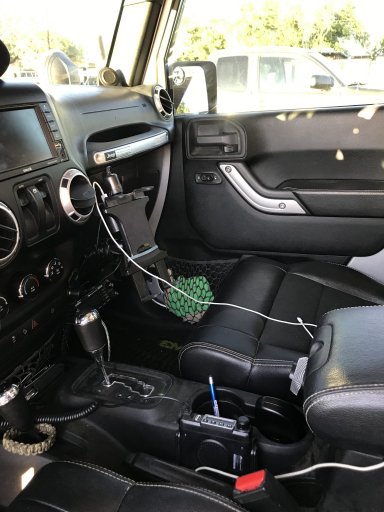

I'm curious as to how bright the handheld display is at night? Does it have a setting to dim it?I installed the MXT275 in the JL today. I'm temporarily using the little antenna that came with it, though, until I can fabricate a much better one. Whichever is in use will be hanging from the dash, while the other will sit to the side. My navigator (kid) can monitor one, if using both. It worked out well because the glove box opens without obstruction. I mounted the base on the panel under the steering wheel. It has a speaker, in addition to the one on the handset. That will help at highway speed, I'm sure. The handset alone is much louder than the Uniden. I think the Midland is a little bit of a better design.
