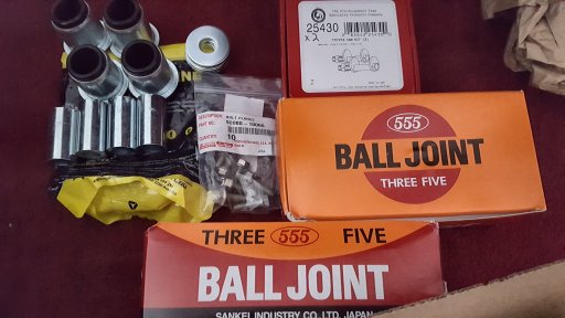

No complaints from me, I'll take experience any day. One thing though I did forget to ask is for the ball joints... little bit of confusion with the actual brand. Done some research and seen where at some point in time, the dealerships used Sankei 555 brand as a replacement. I know everyone says use OEM only for more of a guarantee and stay away from the cheap versions if your not gonna use OEM. But on some of the forums, people have said to stay away from the Sankei 555's as well. Do you know the actual brand you used when purchasing new ones, or at least what brand the originals used to be?

555 is an OEM supplier, but if you were to buy '555' labeled LBJ's, they actually had a different grease inside of them versus the OEM counterpart.
I went ahead with the 555's anyway knowing that many people in the past have used them with success, and knowing that I'll be replacing them every 100k or so.
Replace the bolts that hold the LBJ's in place; I consider it cheap insurance.

Sounds good on all, yeah I plan on this thing lasting longer than me. I don't mind not buying the most expensive, or the "best" quality every time. Some parts you can get away with going cheaper at times but when its an item like a ball joint, I'd rather go with what will definitely work.

Standard maintenance, lower ball joints, and you'll be good for a million miles!
I've got 244k on mine and it runs like a champ.

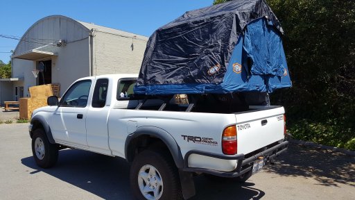

Went to Tepui today -
Been meaning to buy an RTT for awhile now, but today was a total impulse buy.
