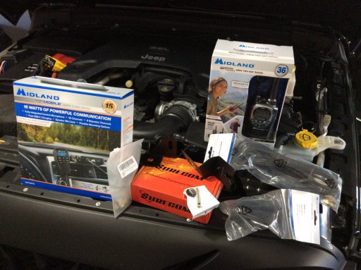

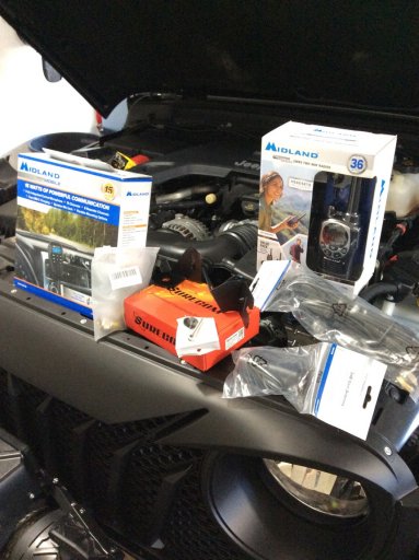

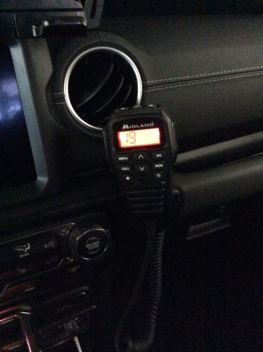

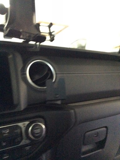

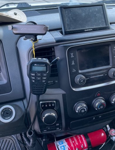

Radio installed, not so bad! Only thing is the SWR meter is saying it’s running a bit higher then I would like but have a bunch of coiled up antenna cable left over so I ordered a coax cable cutter and crimper set and I will take out the excess cable hopefully that will help... if that doesn’t fix it I might order a different antenna to get the number below 1.5 on the meter! Here are a few pictures! Also if anyone knows how else to lower the SWR numbers let me know

I have temporarily misplaced my mic mount so I used a small loop of wire that also holds the charging cable for my phone. I might just leave it that way since it ended up being more convenient than where I was planning on mounting it anyway.

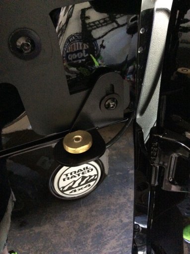

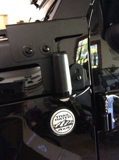

2.6 SWR is definitely not Coax related… either antenna placement or poor ground connection of the antenna as the Ghost antenna is a severely compromised antenna. It is basically a coil of wire wound to give resonance near GMRS frequencies. For best mobile applications look for a 5/8 wave antenna like the Comet we all mentioned earlier I. This same thread… but as long as you are below 3.1:1 SWR your radio will handle the mismatch without harm to your finals.
Read the fallowing post linked below in regards to tuning the Midland Ghost antenna (and antennas like it).

Yeah the SWR was 1.5 on channel 1 low power, then on channel 22 it was 2.6 low power I don’t know ‍♂ what GMRS radios normally run at but I liked my old CB’s running about 1.1 on the Meter on the bottom channel and the top channel, but maybe this is different ‍♂ really don’t know anything about this! Don’t wanna damage the radio, thanks for any advice! Tomicon
The spread of frequencies isn’t really that wide. I’d think the SWR would be closer across the band.
Do you have a bare metal connection for ground at the antenna? Even a short piece of metal braid should be fine as a jumper.

This is a picture of the antenna setup and I had to open the slot on the steel antenna mount with a step drill bit to get a bit of wiggle room. Everything is tight, those were the readings I received on a new digital SWR meter. Thanks
