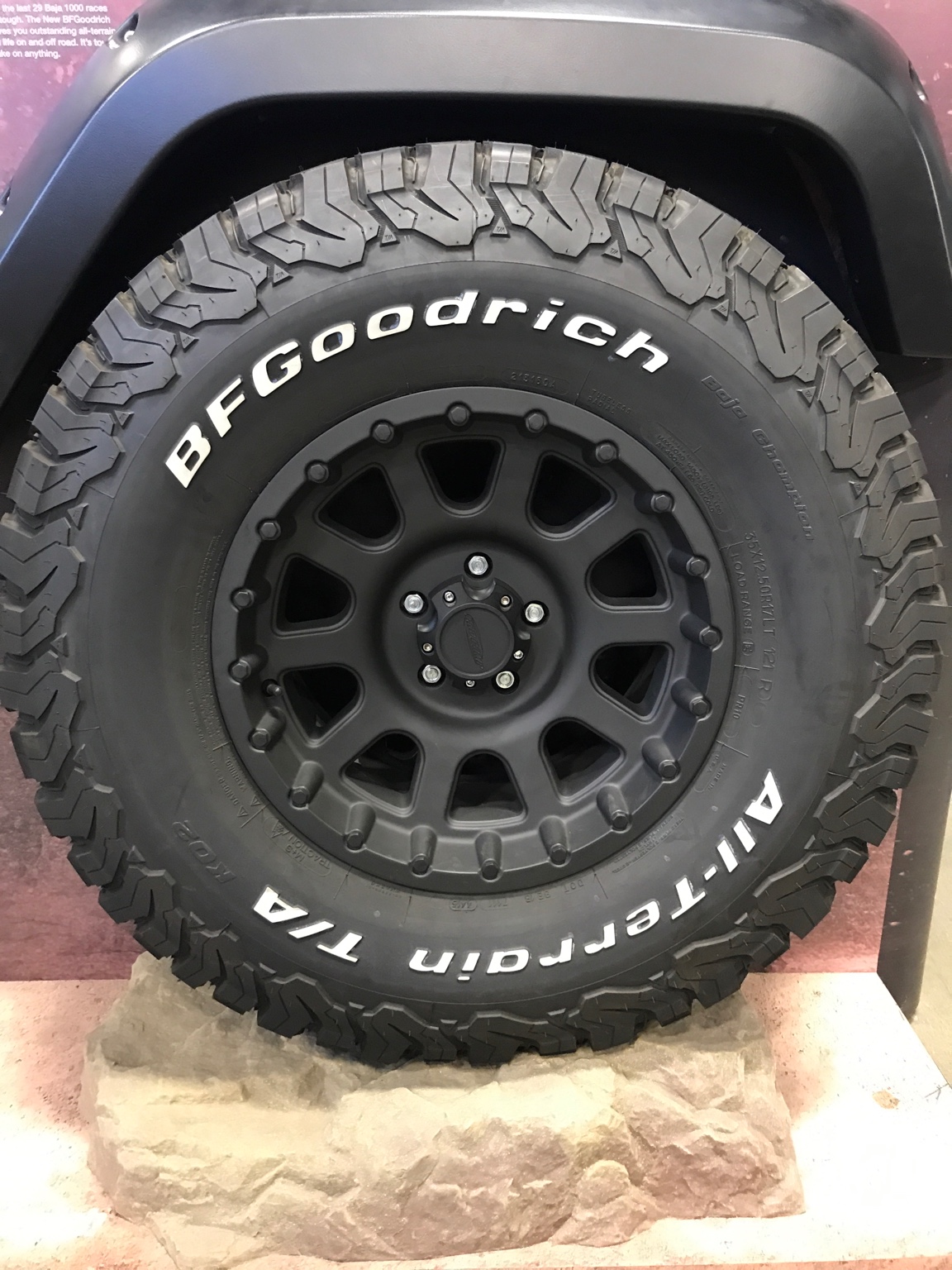

I'm stoked, ordered 35" All Terrain KO2's with ProComp 7032 wheels (like the one in the picture).
I will be getting the lift done before I install new tires but I have a question about gearing.
-What gears does the stock 2016 JKU come with?
-Are there gears in the front AND back diff that need to be changed?
-What is a good price to get them installed at the shop?
-What gear ratio do you recommend?
It's my daily driver which I take off road just about every weekend...
