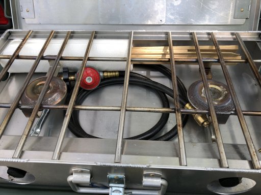

If you are just going to boil water get a Kelly Kettle, I use mine in the desert on twigs of sage. I like white gas and have an old Coleman single burner, but propane is so much cleaner to cook with. I took an old Colman 425E dual fuel and converted it to propane burners. Keeps that old skool look!
