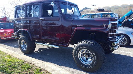

It was definitely interesting, I'd never been to anything like that. The amount of people there was crazy. I took two pictures, a Willy Overland, and an Oldsmobile that made me giggle. Apparently Broken Spoke overland was there, and I missed them. My van (the back anyways) did make it into the background of someone's picture, but no love beyond that.
