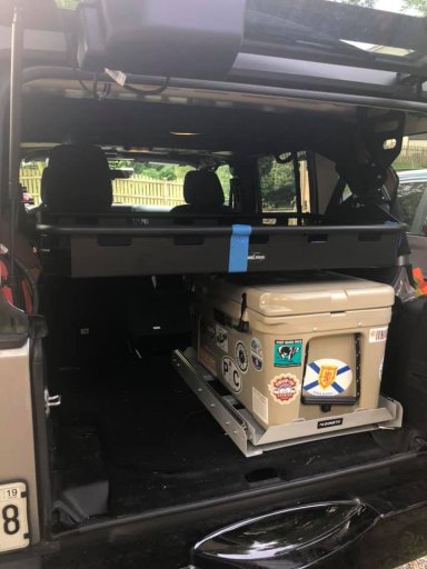

OK so I wanted a shelf for the longest time and maybe some sort of drawer, well in the end I think I'll be happy with just the shelf. I got this off of Amazon for like $180. I unfortunately had to cut a section off because when I slid my cooler out I wouldn't have been able to open the lid lol.

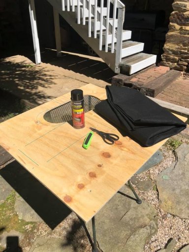

So with that being done I started to work on the platform that my fridge slider will be bolted down on. I went with 1/2" plywood from Home Depot. Its just shy of 3'x3' piece. I added felt to it so it would look a little bit cleaner and my boxes would slide in and out better.

So I used this glue to glue the felt to the wood. I also wrapped it around and stapled the underside for extra hold:

Here are the pictures of the shelf, as you can see, this is why I had to cut a section out. I couldn't get the shelf anymore back due to the FrontRunner Roof Rack mounts being in the way for the shelf mounts, and the cooler slider couldn't go back anymore due to the large awkward cooler that is Yeti:
