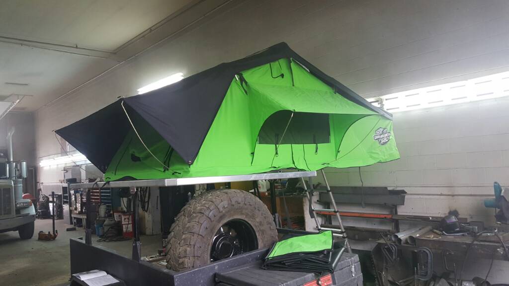

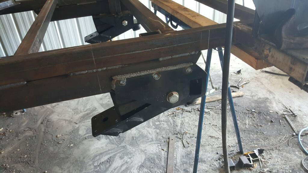

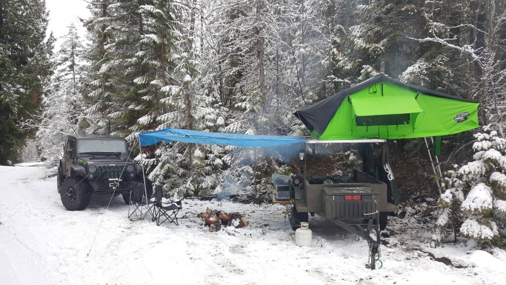

Yes it goes up and down about 18" if I want it that high. I'm using gas struts to do the lifting, each on will pick up around 75- 100 lbs all combined it should pick up 300 - 400 lbs all together. I'll try to get pics up soon. As for the suspension they are timbren axle-less trailer suspension they are working great. Trailer empty on a forest service road and no bouncing . It rides smoother than my jeep. I have the heavy duty 3500 lbs with brakes,
This is the suspension with out. The spindle

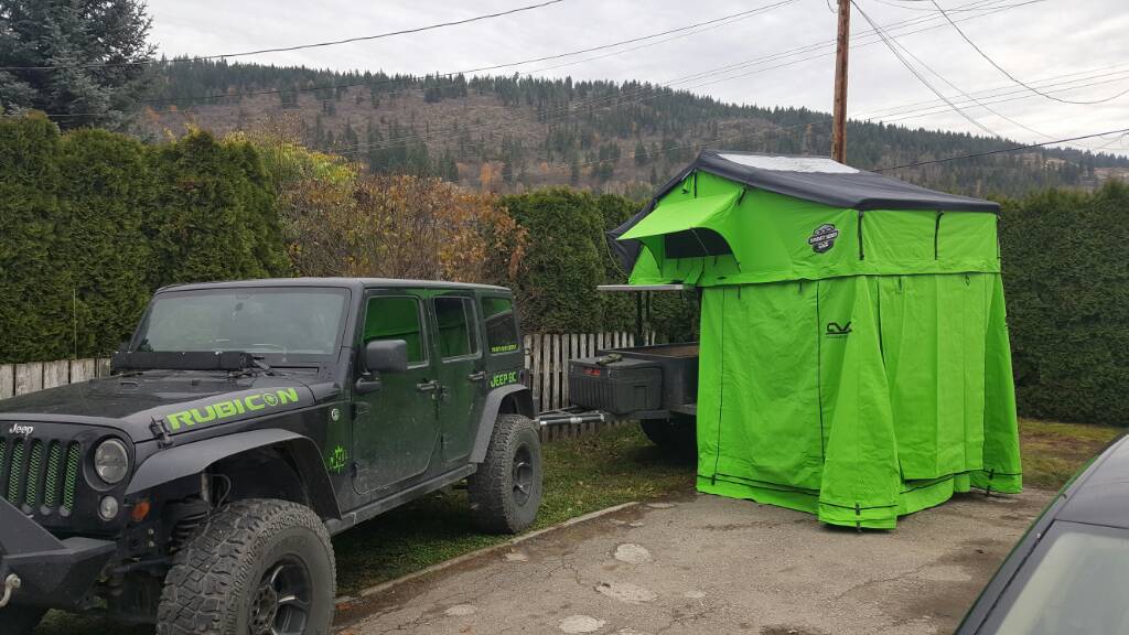

I built this as a dual purpose trailer. I only have a jeep and a vw jetta so went I need a pickup the rack comes off the trailer and I haul stuff for the yard or other projects with it other wise it would have been a bit smaller. There will also be 2 Kayaks hanging from the rack as well

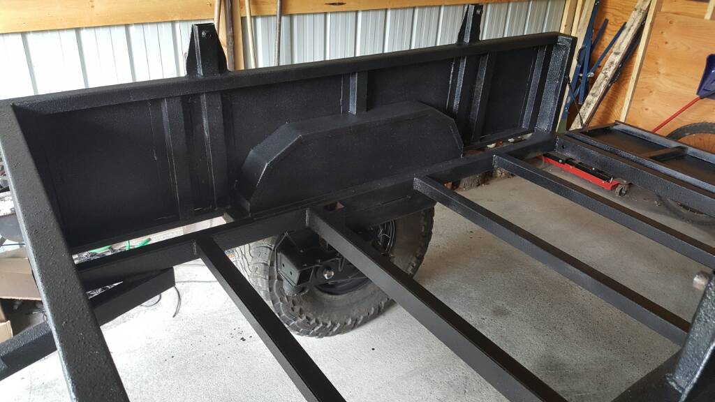

TO the OP. What brand of Rock Guard did you use? Was it a spray on or brush on? I absolutely love your trailer build. I'm trying to get some ideas from this site for my build. Also, what is the reason for the fenders to intrude into the bed area? I was just wondering because it would probably be easier to load items into the bed if it was just flat all the way around the inside of the bed.

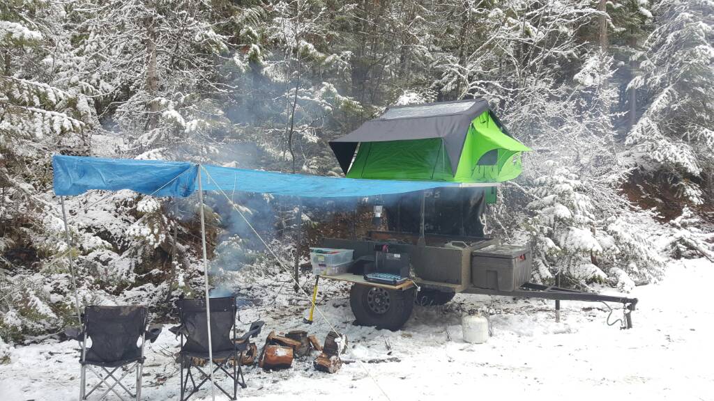

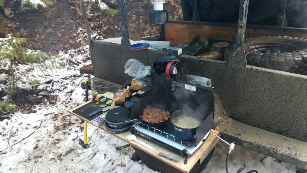

It was paintable rock Gard sprayed on with a shucks gun then I rolled flat black tremcad over it to seal it up. The reason for the fenders and side steps is for putting up and down the tent as well as while camping the one side is part of the counter for the kitchen. There's 49" between the wheel wells so I can still carry ply wood. The main body and the track width is the same as my jeep so if the Jeep fits through the trail so will the trailer
