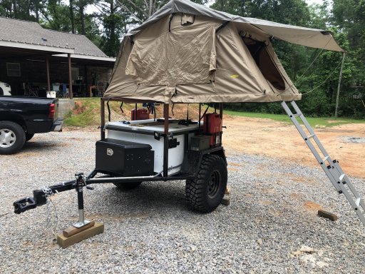

My homemade trailer.

After I added two jacks to the rear corners it became very stable.
That's great plus I'm sure it is easy to level out. Great build. Do you have any idea what the cost of the materials you have in it is? Also how hard was it to get plates? I know in some states, home built trailers can be hard to get plates for.
Less than $2,000 in materials including axles and articulating hitch. Plates were no issue at all here in Louisiana. Electrical system was about another $1,000. All in all with RTT, Alpicool fridge, 2KW inverter generator, metal, wood, electrical sys...Everything together was under $5,000.
That's really not that bad at all. I imagined the cost was going to be like 8-9. Good work!

did you put in a straight axle , torsion, or Timbrens? cant see in the pictures and it looks great. Very similar to what I have in mind for myself.
I originally used 2000lb torsion half axles but the leverage and weight of 33" tires proved to great during extrema off camber situations and bent the heck out of the spindles on the first trip. I had a local machine shop build me a piloted adapter to weld onto the original axle drop bracket and bolted JK wheel hubs to it.
