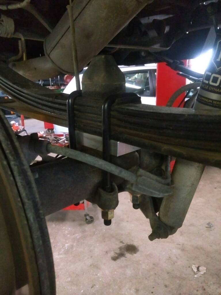

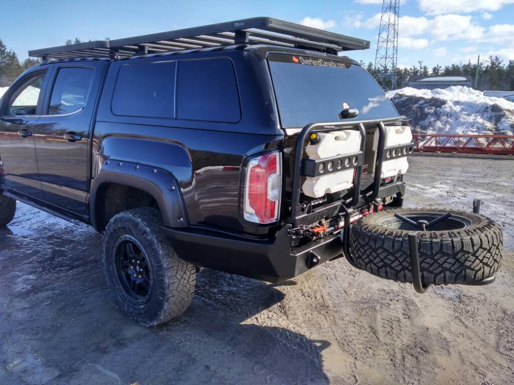

Stuck a one inch block under the leafs to compensate for the bumper weight. Not ideal but the truck sits level again

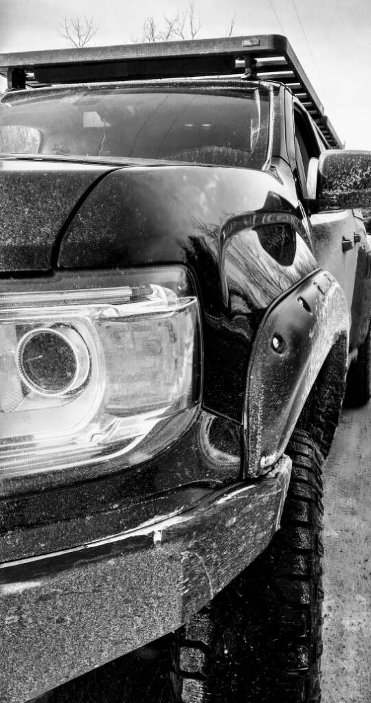

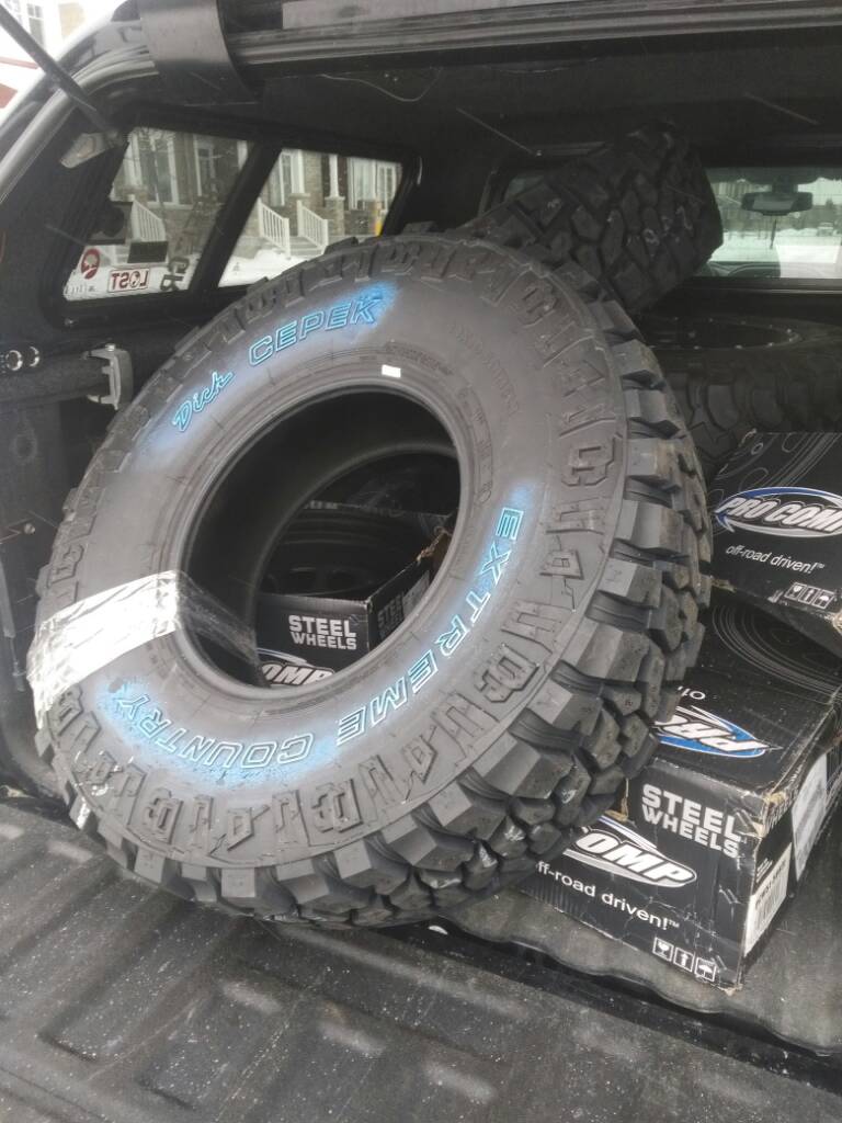

New tires, Nitto Ridge Grapplers. A bit more aggressive than most at tires. I am blown away at how quiet they are, simply amazing.

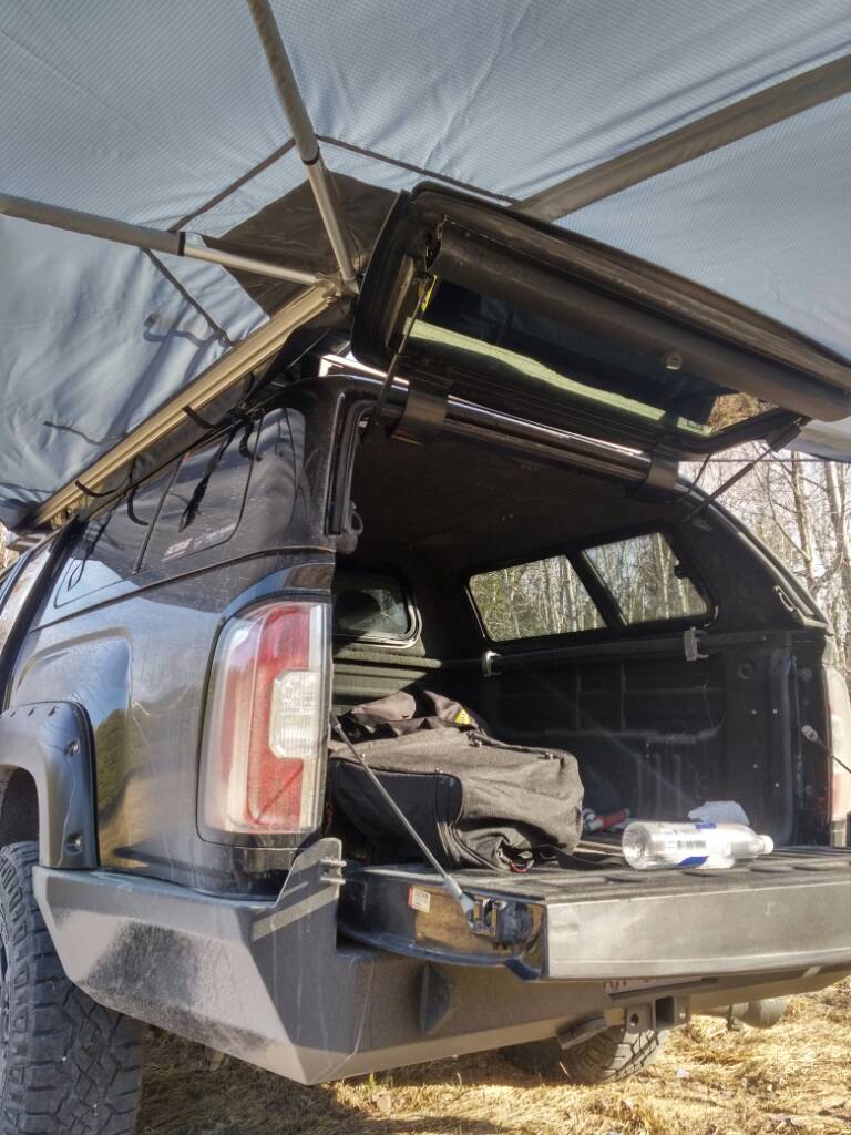

Took the awning, cb antenae, etc off for the winter. Salt season where I live is about to start.

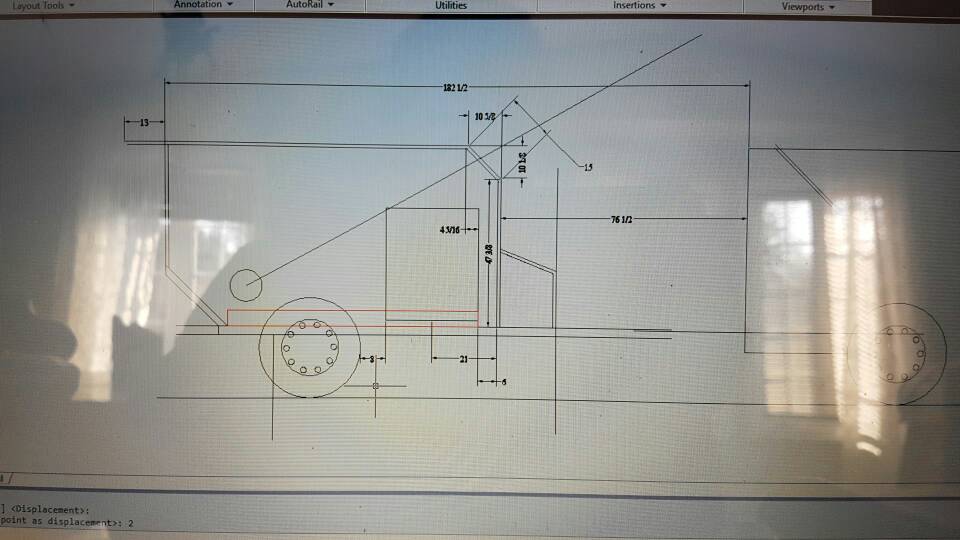

Took quite a bit of drawing and redrawing to get it right, but it's finalized. Rolling chassis should be done by weeks end.
Bought a queen sized, 6 inch memory foam mattress. Very comfortable.
Rear swing out had to be able to open with the trailer connected, this impacted the design in a negative fashion. Was hoping to get the distance between trailer wheels to rear wheels the same or similar to the distance between front and rear wheels.
All in all the design is solid. 2x3 framed chassis. The box will be 1x1 framed. Aluminum for the exterior walls, floor and ceiling. We're still debating on how best to do the corners.
Spare will attach to the rear of the trailer.
Interior will be insulated then finished with white gloss pvc sheets.
A few things left to buy. A roof vent, a trailer light package, etc.
