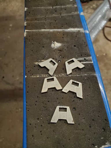

Havnt had much time to work on ghetto trailer. Got sick last weekend and spent most of the week trying to recover. I did make up some gussets to got with the extra bracing I havnt made yet.

Not a whole lot of progress on the trailer lately. Been busy with the family and the wife's honey do list. Also did a little bit of work on the TJ so I could drive it again. Made up some gussets to keep the control arm tabs straight. Got 1 burned but still not happy with how my welder is working. I was hoping to be able to skip a trip to work to burn everything in on the bottom but I guess that's just how it's gunna have to be. I may be able to get up next week if I play my cards right .

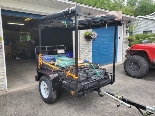

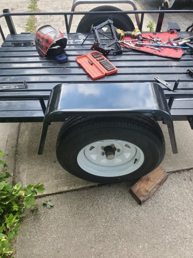

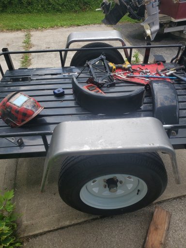

Well I havnt had much of a chance to do any work on my offroad trailer. But I do need a trailer to tow behind my jeep to an offroad event to haul my camping gear next month as well as needing a trailer to haul camping gear for mywlself and the family next week .... so I'm shifting gears slightly to give myself extra time for the offroad trailer.
I already have 2 trailers that I use for different projects ( 3 if you include the boat trailer), so I am taking the utility trailer I use most and modifying it slightly for use behind my jeep. As I've mentioned before, I have all kinds of parts laying around so I figured I would put some to use.
I plan on building a removable rack to go on top of the trailer so I can mount my shower and awning on top and still haul all the gear I need in the bed of the trailer. For this I made up some pockets for the rack to sit in on the side with some 2x2 square tube I had in the garage, and I removed the fenders because they were too small for my extra set of tires ( still not large tires by any means. Only around 27" tall.) And to mount them I had to flip the bolts for the springs son that they pointed inward ( this trailer has sliding leafs and the bolts that hold the leafs in place actually held the brackets for the fenders). The rack will be made of 1.5" square tube and once I get everything build I'll drill some holes to either bolt or bin them in place.
The fenders I also had sitting in a shed for a trailer I don't have anymore so I welded them on for some extra coverage.
Only took me a couple hours to get the work done with a little bit of trial and error, and just the change in tire size raised the trailer 4".
Overall for a quick job I think it turned out well and will meet my requirements short term ( without any real offroad use in the foreseeable future for this trailer).

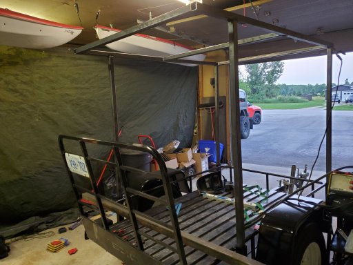

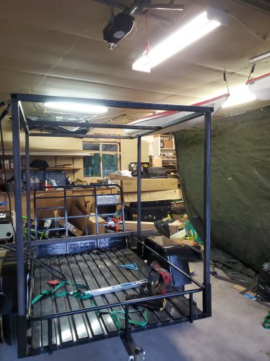

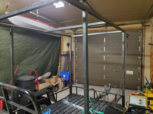

Threw a rack together last night when I got the kids to bed. It sits high and I'm torn about this. I made it so that I would t have to adjust anything to deploy my awning, but it now won't fit in my garage with the awning and shower mounted. It's not a huge deal.. I could make the top slide up with more holes in the legs of the rack but I have a bar welded across the bottom of each pocket to support the rack while it's sitting on the trailer. Oh well, not a big deal either way. It's coming together and should hopefully take it's first trip this weekend. I need to pick up more paint and drill holes for pins. Also I did a bumb move and didn't measure the bolt pattern on the shower and it just barely fits but I will need to address a bitbof a hardware issue ( the metal straps are curved and the radius of the curve sits too close to the cross bar). I just need to cut some flat bar and put some holes in it and it should be good. Hopefully the awning fits.

Loaded the trailer up and hit the road for an extended weekend with the family. It did well on the road and through the back roads ( didn't do any offroad travel with the little ones in the car) we had to adjust some of our gear prior to leaving to make sure that all food related items could fit in the car when we went to bed/away from camp as the park had active bear warnings posted.
We got caught up in some rain shortly after we arrived and I was glad to have the awning ad it provided most of the shelter until the rain died down.
But we did manage to ketbthe kids out on some hikes, nature walks, beaches, and playgrounds to tire them out while we were out and about.
Lol the park staff had a sense of humor. This was in a turtle tank in the visitors center.
We did get caught in more rain and thunder storms through the evening and overnight but all in all was a decent trip.
I'll still have to use this trailer for a while until I get the other one built up for now it's working out well.

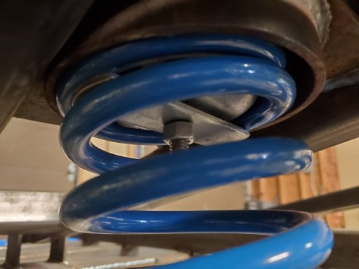

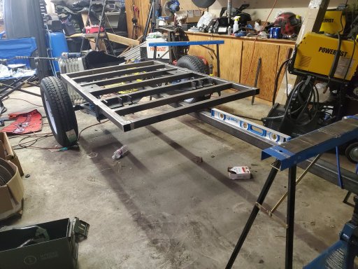

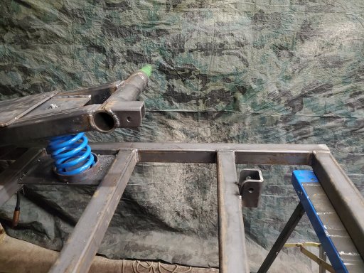

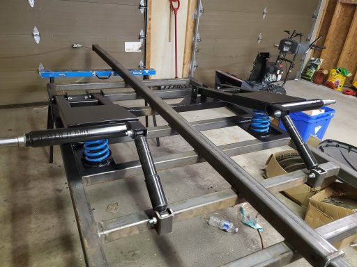

Finally getting back around to working on the trailer some more. It's been a crazy year with the kids, work, and other projects/maintenance on things that this build got shelved for a while.
I managed to get a few hours and finished welding up the control arms and got them test fit with the bushings installed. Now I have to take it apart and spray them with some paint before I mount the hubs and put wheels on it so I can have it able to roll around in the garage. I need to buy some more hardware because some of the original parts I bought or had for this were used on other things while this was on hold.
Still a fun project and I'm excited to see it with some wheels ( only small trailer tires for now).20240224_160644.jpg20240224_160817.jpg20240224_163034.jpg20240224_161948.jpg

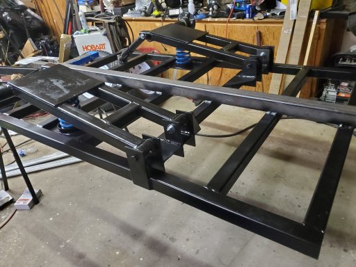

Painted the control arms and got everything mounted back up, installed the hubs and wheels and finally dropped this thing to the ground. One of the shocks has a clearance issue under load that I need to address but it's coming together finally. May be a slow process from her on getting more materials together but it's moving along again.

How did you get the measurement on the center of the wheels or hubs ? I am starting a build on a 4x6 trailer also using straight axel. Thank you in adavance
I wanted the axle to sit a bit further back than most because I wanted bit more tongue weight, and when the drawers slide out of the back I didn't want it to want to tip backward constantly ( I will still add some stabilizers). It also has a receiver in the back that will I can add a bit more weight and still have the trailer stay steady behind me.
Instead of centering the axle at 3' I moved it back 1'. When building I set the springs just ahead of that mark and layed the axle out where I wanted it. Then I layed out all the arms with those measurments in mind.

Got the trailer out for a run around the block and it tracked great, was very quiet behind my Jeep and even as a bare structure with no weight on it ( though the base is fairly heavy itself) it wasn't bouncing all over the place like my other trailers.

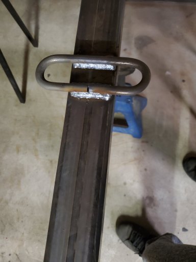

Got it back in the garage and stripped it back down for a coat of pain on the under side, all except for the tongue that I plan to weld some zip tie tabs on to run the wiring down the side of the tongue/spine to the back for light. And I also got the loop for the safety chain welded on and the actual ball receiver made. 20240305_195059.jpg20240305_195110.jpg20240305_195129.jpg

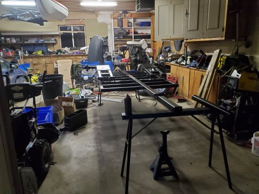

Not a whole lot of progress but some layers of paint layed down, replaced a mangled grease cap on one axle, tacked my zip tie tabs in place down the "spine" so hopefully the next time I flip it over it will be the last.20240306_200255.jpg20240306_204444.jpg
Also I really need a bigger garage .... I have all kinds of tools and when I start working on something ... a lot of them come out .. then friends come over with issues wit their cars/trucks/boats and everything comes out.... then I get side tracked on another project for a while and ..... Basically my garage is chaos lol. 20240306_204700.jpg
