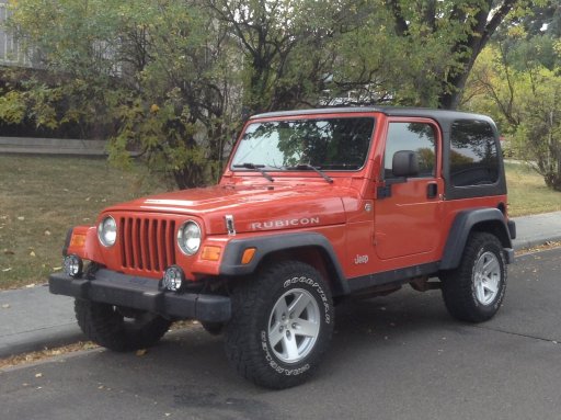

My buddy's new Rubicon.

We had to cut the bolts off. Now, try to get the tie rod end out of the trsckbar sleeve. Rusted in pretty good. We used penetrating oil last night and left it. I'm going heat the sleeve and hope it frees up.
Usually I buy the complete kit... if one joint is bad, the rest are on their way out... and then I don’t have to worry about trying to mess with rusted parts.

Well, we got the tie rod end replaced on the track bar. It made a huge difference to the jeep and it steers SO MUCH BETTER now. There was an additional tie rod with the parts to the jeep, we installed it and it worked perfect. So that's one thing off our list of to do's. Next up is bleed the clutch system, brakes and U joints on the front axle. After that, we will be doing the little bit of body work she needs. I LOVE this jeep. It rides so damn good compared to the other TJ we tested with the rough country suspension on it.

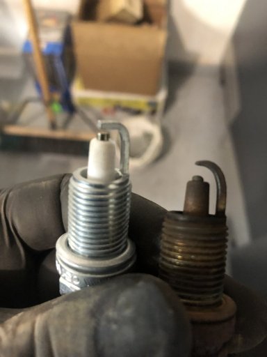

No wonder it had a little stumble in the motor....The spark plugs were the original NGK. 193000km on them. BRUTAL.
I also did the brakes yesterday, bolt down the custom fabed roof, greased all the johnny joints and other greasable points, and changed the oil. The rig is vastly better than it was a week ago.
