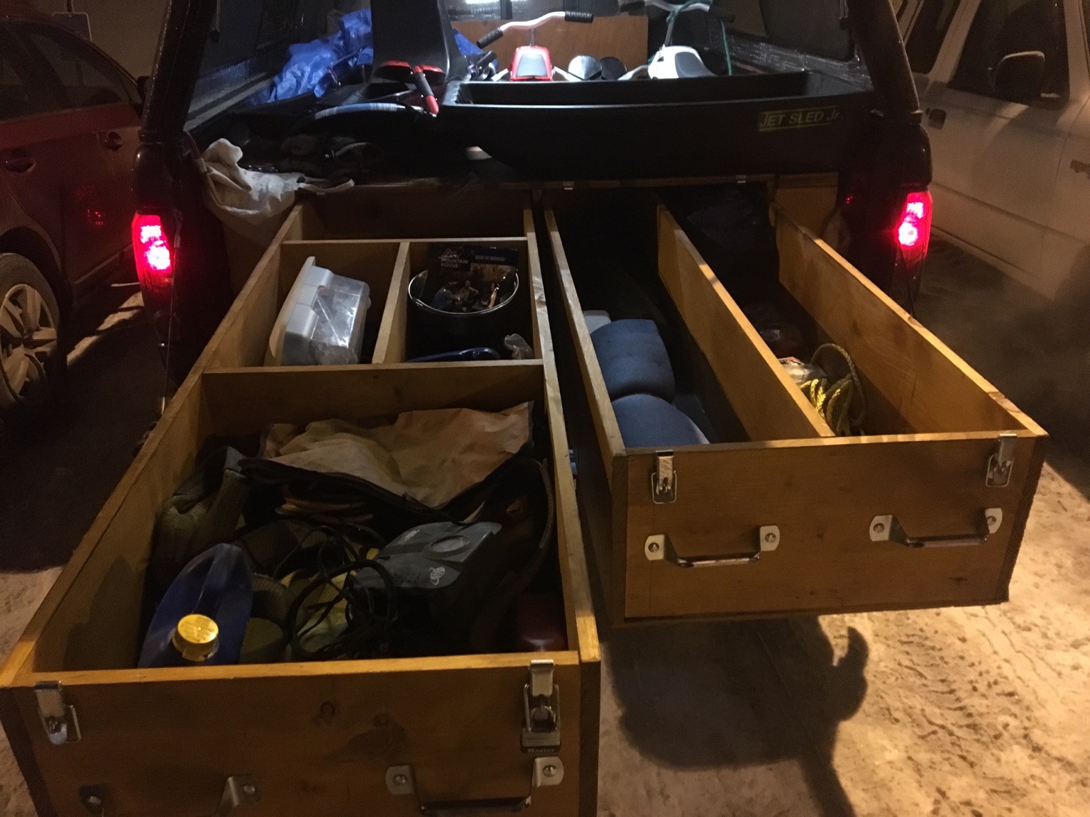

With weather in the negatives, are you using more than reflectix for insulation? And what kind of tracks did you use for your drawers? I like the older F150s, nice truck.
Reactions: GRIMGPR and Anon
Anon

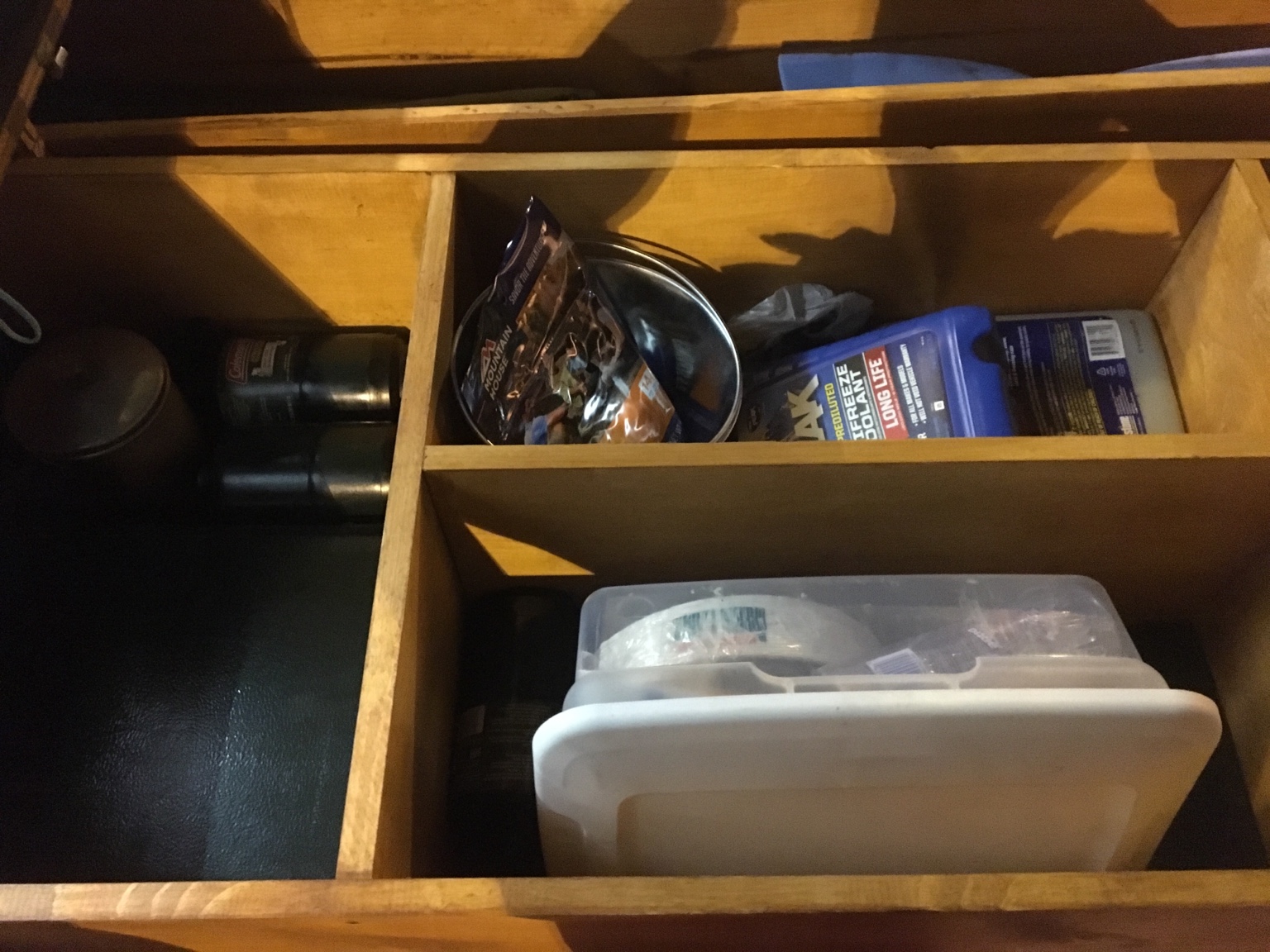

Thanks! I've put a lot of work into it so far over the past year. I'm only running the reflectix so far and it seems to be working well. Definitely makes a difference and doesn't allow moisture to build up on the surface of the canopy anymore which is nice in itself. I didn't use any tracks (technically) the "tracks" are in the pics. So to avoid to much friction sliding wood on wood, I laid down two metal strips (carpet seam transitions?) per drawer to allow them to slide better. I also waxed the hell out of the bottom of the drawer. This helps them slide significantly better. The stain caused them to stick a little bit, but it went away after using the drawers for awhile. Now, fully loaded, even my girlfriend who is a whopping 110lbs can pull out the drawer with a good tug. I think the main reason it was sticky though is I made the drawers just a little to wide to begin with. Either way, it made its ruts and works perfectly. I would not go back and use real tracks. They're spendy for heavy duty ones to handle as much weight as I carry. Much better for me to just run the wood with the metal sliders.
Anon
Obviously, not exactly organized or fully loaded at the moment, but it works fantastically. I usually organize it per trip and take most stuff out that's of value in case my truck gets broken into.

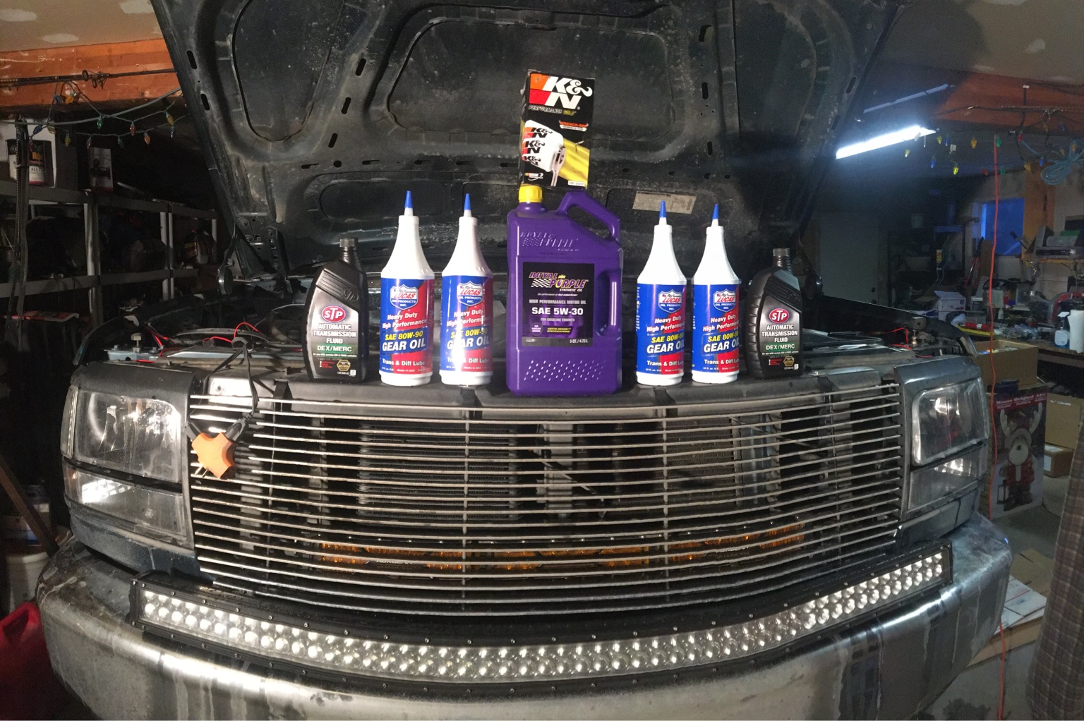

Got some much needed maintenance done the other day. Changed out the T-Case fluid, Front Dif, and converted to running Royal Purple. Next step will be to install my Shorty Headers I have laying around in the garage and will be regearing the axles to from 3.31 to 3.73 gears so I can run 33x11.5 tires and still have adequate power. [emoji1303]

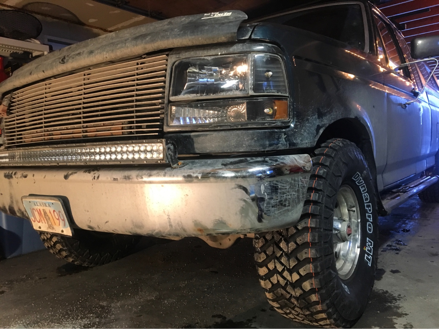

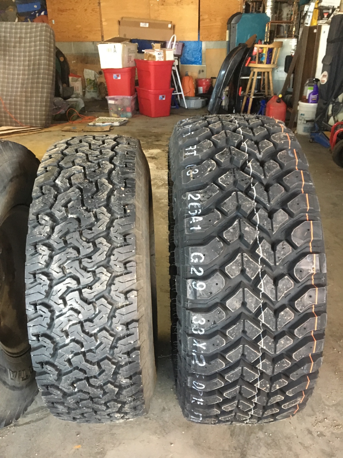

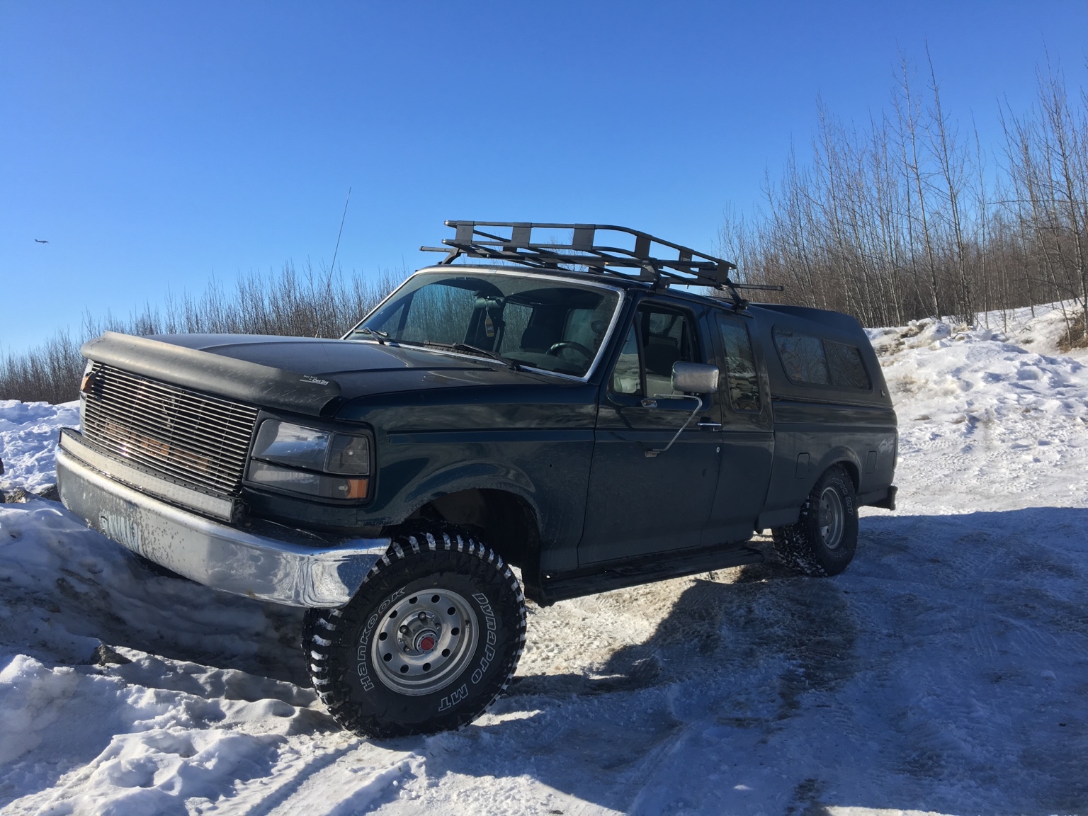

Well, with a wonderful tax return coming my way, I decided to get a head start on doing a much needed upgrade to the truck. Just went out and bought 2 33x12.5R15 Hankook Dynapro MT's [emoji1303] Upgraded from 31x10.5R15 BFG All Terrain KO's and the difference is beautiful.
Just have to wait for my tax return to buy 3 more tires and put on my 3" body lift.
Reactions: GRIMGPR
Anon
Finally got the tires on and she is lookin fiiiiine. Only had to trim my front bumper just a tad, but that's okay. Decided not to install my body lift and simply save up for a 4" suspension lift. Tax returns got me a new K&N Cold Air Intake and new body mounts to replace a couple rubber ones that are now starting to crack a little. All of which is in the mail now and will be updating as things come along!

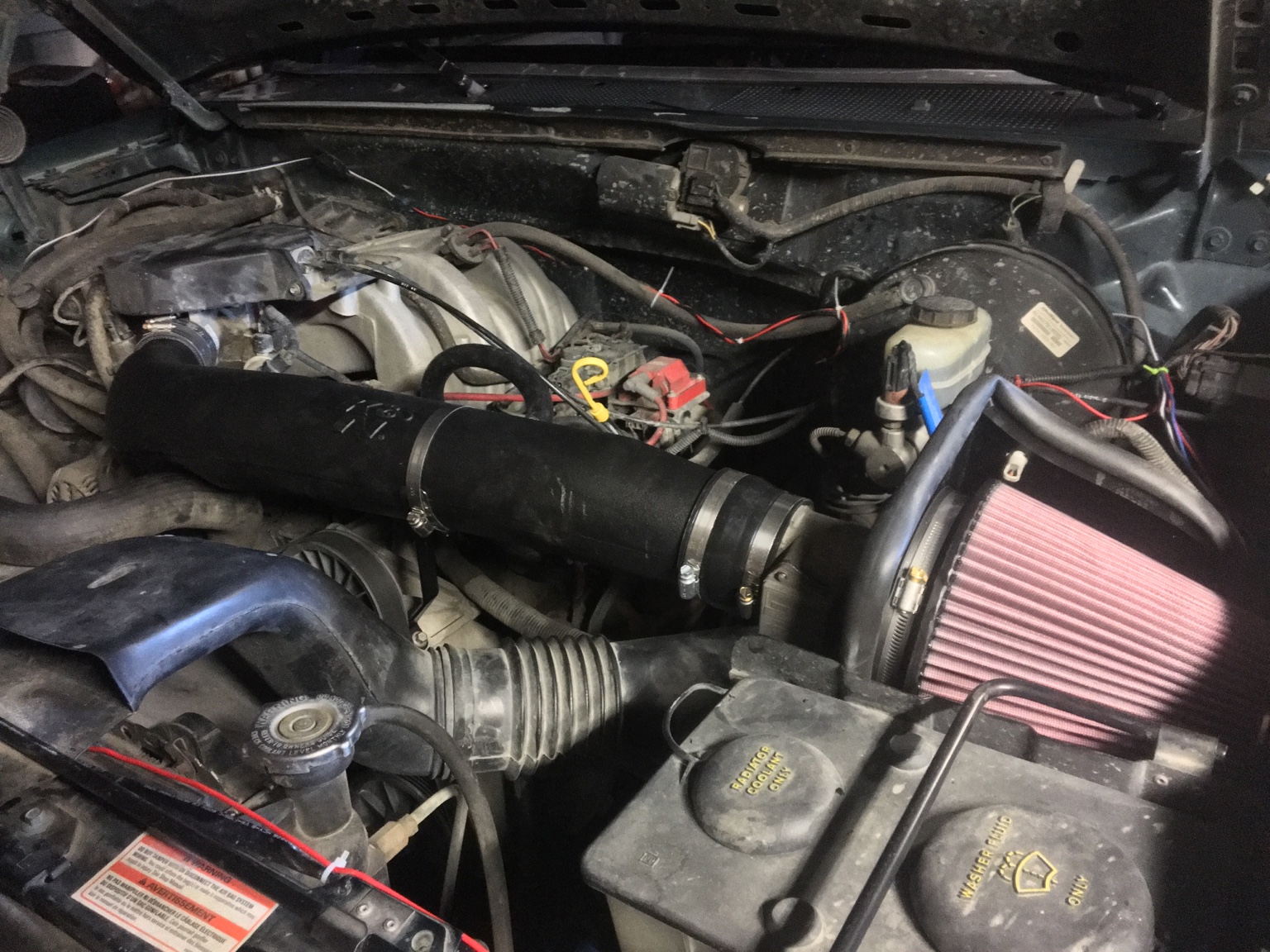

Decided to order some small performance parts to give the truck a little extra mmph and to improve gas mileage a bit. I gotta say, I am NOT disappointed.
Just got done installing a K&N Cold Air Intake System and an AirRaid throttle body spacer.

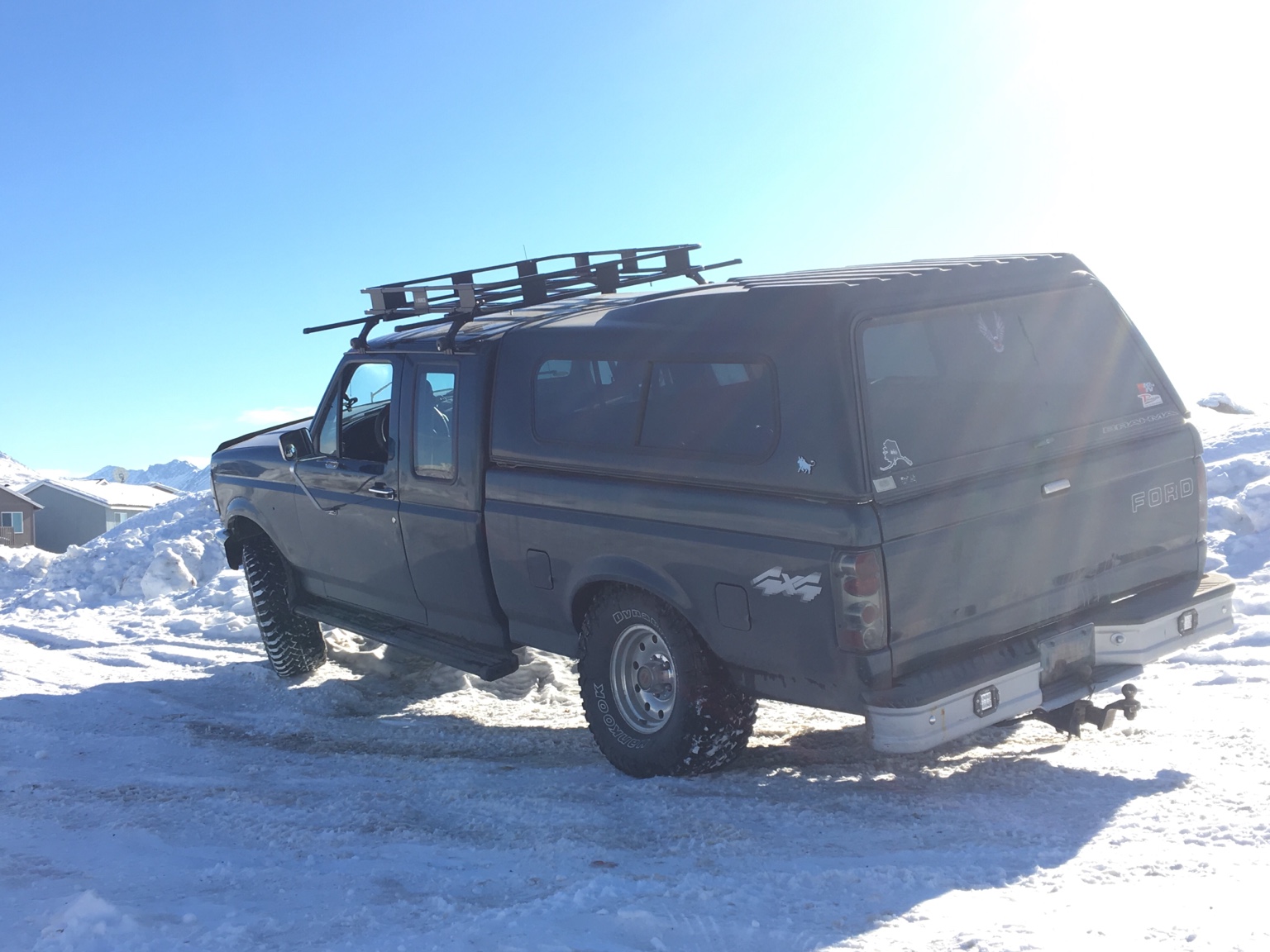

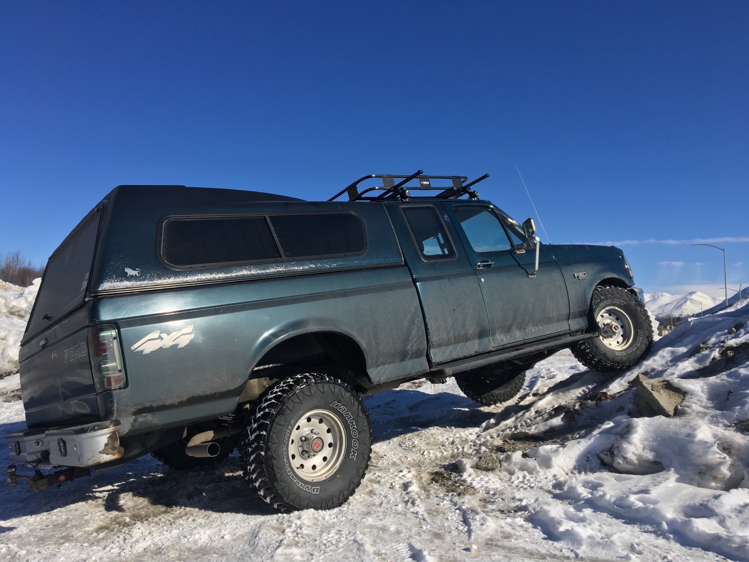

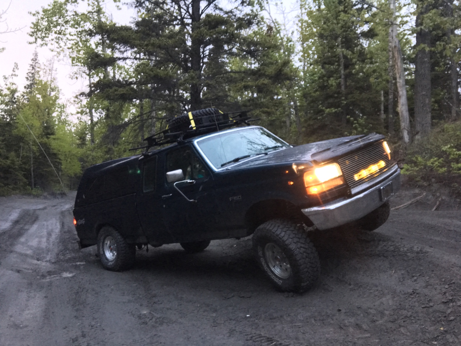

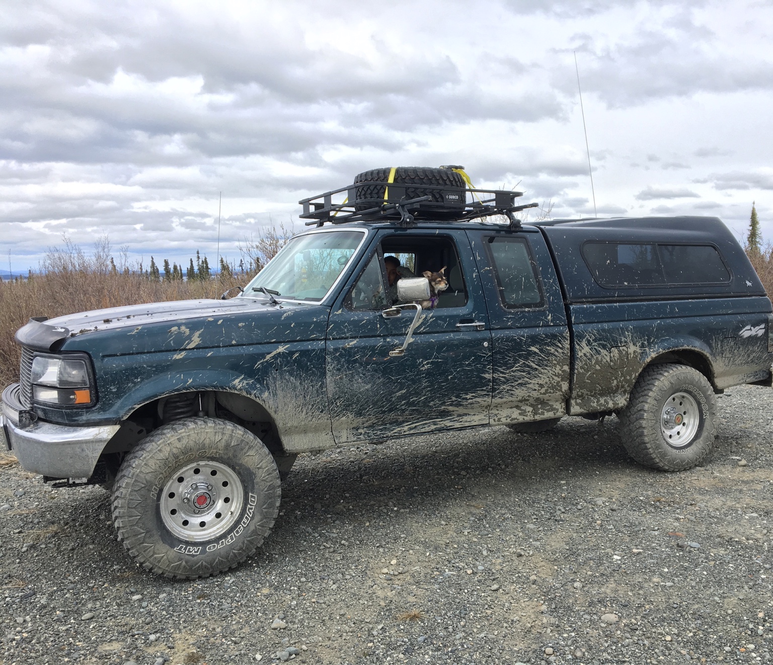

Put the roof basket on and decided to see how well she flexed with the new tires. Not bad in my opinion for running 33's and no lift.
Decided to go with the Surco Safari Rack and I'm diggin it. Now, just to get the mounts for the accessories.

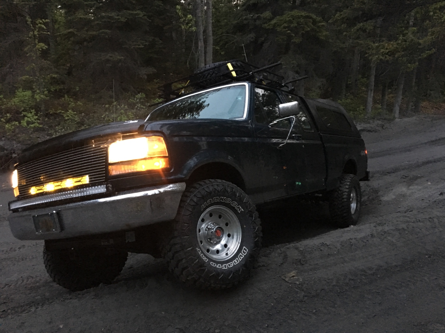

Well, finally got a BUNCH of work done to the OBS. Just had my 4" Rough Country Lift Kit installed and I am not disappointed in the slightest. Has a nice smooth ride on road and is well equipped to handle off-road terrain. I also am now part of the 4.10 club. Had both axles regeared from 3.55 to 4.10 gears with a Posi in the rear end. No lockers yet, but this will do for now.
Decided to do a break in run to Jim Creek, AK just off the Old Glenn Hwy. Always a beautiful trip [emoji631]

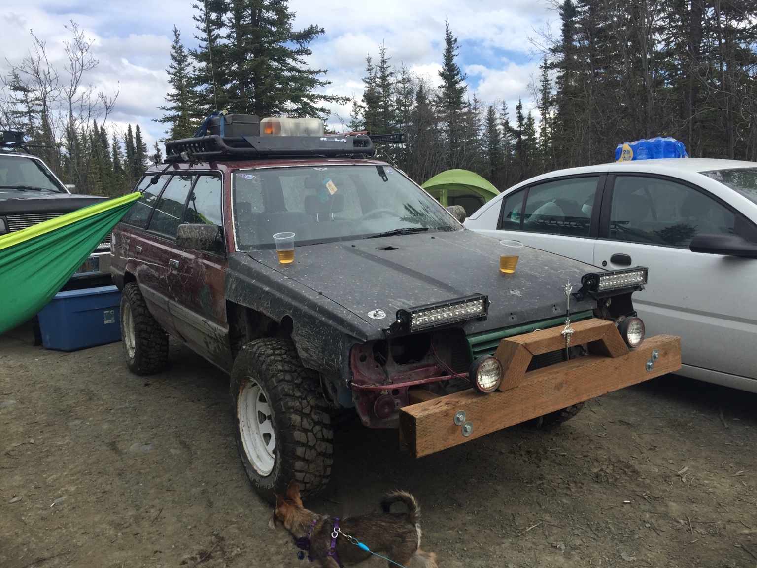

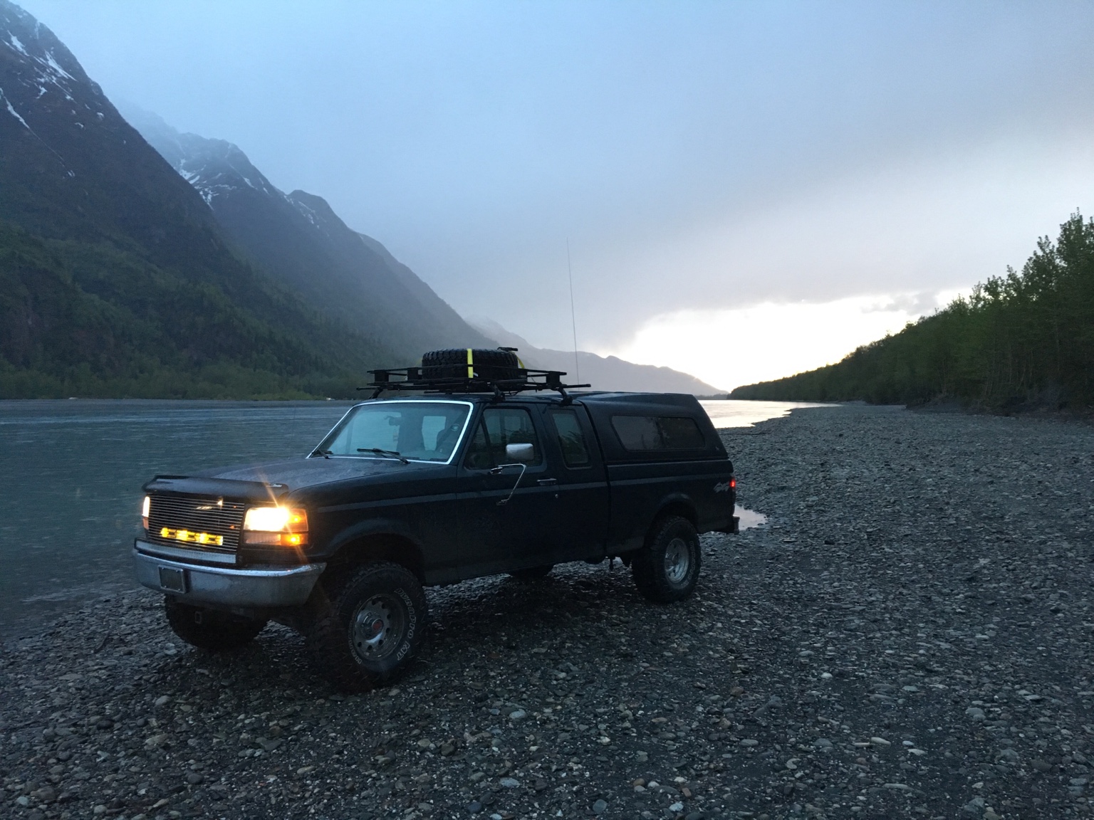

For Memorial Day weekend, the lady, pooch and I all decided to head out to Lake Louis in AK for some fun. Got to break in the new suspension a bit (a lot) and do a bit of fishing. Needless to say, we all had a great time! Even got to mob my toy (1987 Subaru GL Wagon) around for its maiden voyage and she did pretty well despite blowing out a shock and shredding the timing belt lol

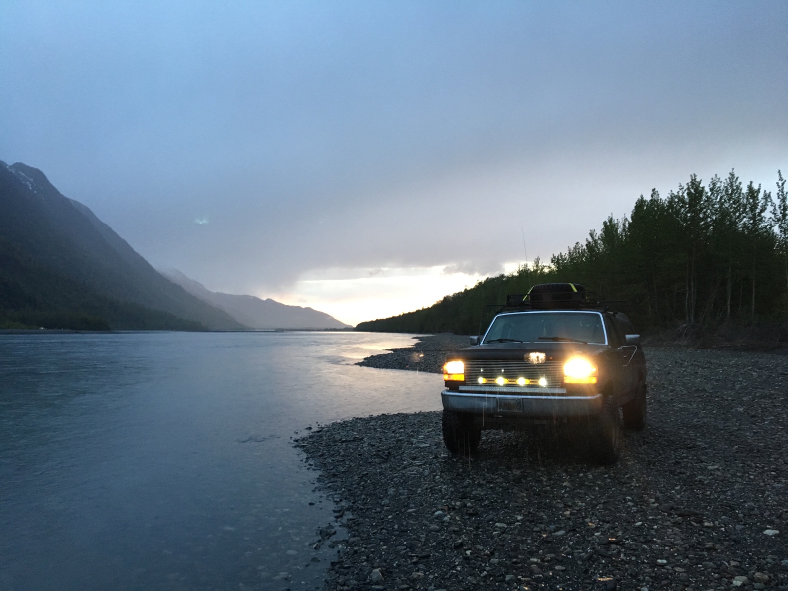

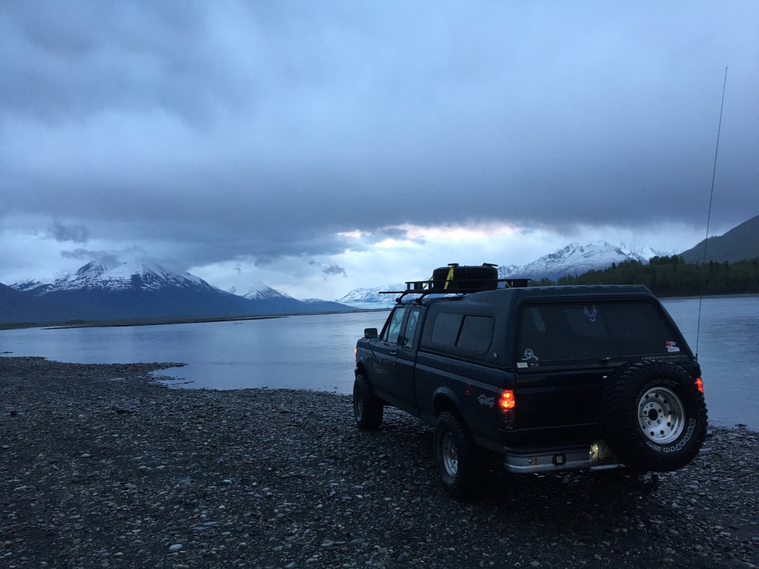

Well, just got back from an amazing 2 week camping trip. Decided to travel my own state and play tourist a bit. Left from Anchorage, drove the Denali Highway, then into Fairbanks. From Fairbanks we hit Chena Hot Springs and enjoyed our time there. Camped at a few places in between all that and had a fantastic time.
After Chena we headed out and did some fishing on the Chena River and decided to test out the 4x4 a bit by driving down the river in water ranging from 1-3ft deep to our own little private island. Lunch was made and some fishing ensued. No boat needed [emoji1303][emoji631]
Lots of other stops here and there for fishing and to get off the pavement a bit and explore some trails. Eventually made it up to the Arctic Circle off of the Dalton Highway. With our ultimate goal being to make it to Deadhorse, we didn't stay long. We took our pictures and hit the road eventually making to Coldfoot.
Once in Coldfoot, we enjoyed the lovely price of gasoline at like $4.50gal and the restaurant that was there. Service was excellent and we enjoyed a much needed meal consisting of BLT's. It was then I noticed some play in the steering so we decided to pull in and make camp just outside of Coldfoot. Took a look underneath and my Tie Rod end was hanging onto dear life. Being in the middle of nowhere where even buying one tire can cost upwards of $400, we decided it was best to just turn around and try again another day. Breaking down was not an option and can get VERY expensive that far north in AK. No repairs and just a tow, can run $600+ depending on where you are and where you need to go.
The trip back was a nice babied limp all the way back to anchorage doing about 45-50mph. With more fishing of course and stopping at Denali national park. The trip did not disappoint and I recommend it to all overlanders who travel to AK.
