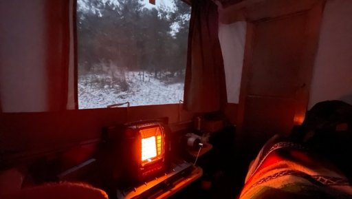

The Little Buddy saved my camping trip (and maybe my life). I bought one for a trip a couple months ago and when I got up to Cloudcroft, NM it was MUCH colder than I expected it to be and dropped into the low teens overnight. I fired up the Buddy and kept it on all night. At one point, I even had to turn it down because I started to sweat. My set up is a small popup (Fleetwood Neon) and instead of having the heater in the big bed with me (super unsafe), I slept on the foldout sofa with the Buddy on a hard container next to me. It is now part of my essential cold weather camping gear.

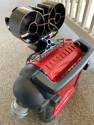

I have used one for a few years now and really like it. Do yourself a favor and use a line filter if hooking up to a large propane tank. I did not at first and ended up disassembling it 3 times before I got the oil out of the lines.
I have not run it overnight in the tent so can’t comment on condensation.
I added a wood stove fan on top to push the air in our direction. Works great. Here’s the description of the one I bought on Amazon: CRSURE Wood Stove Fan, 8 Blades Double Motors Fireplace Fan.
I have the same Buddy Heater and was planning to get one of those TEG Fans. How has/does the fan move air for you? Does the fan help with condensation? When using my heater in my truck shell, I also used a 12v oscillating fan to move the heat and to help with condensation.
