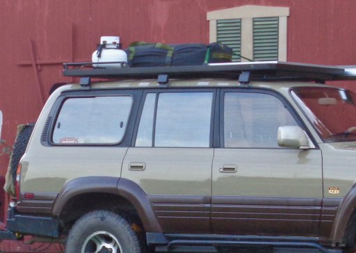

We use the Mr Heater Portable Buddy, the small one and it keeps us nice and warm in our Jet Tent 25x, (8x15 approx) in 15 f overnights. I found this compact, short and squatty 5 lb Worthington bottle mounted with a slightly modified bottle rack from Frontrunner. 5 lbs will keep you warm for at least 4 nights and if you are conservative ya might squeeze in 6 nights. We usually warmed up the tent before bed, but once bedded down, I'd turn it off, wake up around 4AM and turn it back on, sleep till sun up and awaken to a nice cozy warm tent.. View attachment 19345
Where did you find that short bottle? google is failing me.

The ones i'm finding are not the shorty ones, so maybe that fell out of style. Not a big deal.
