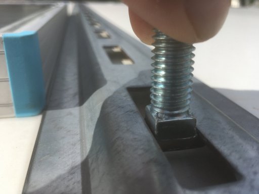

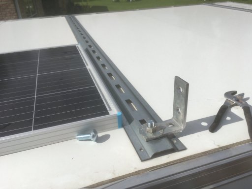

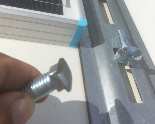

I may just try your solution next. I ended up using some spare tire mounts that just have a threaded rod and nut on the end for bolting things down, but those can get expensive if you need a lot of them.
Right now I'm trying to decide what materials to build my cabinetry out of. I want something very light but decent looking.
here is what i was able to do for the roof mount. like i had said, a 1/2" carriage bolt is to big to fit thru the slot, so grind the sides to make T-bolt and then grind down some of the domed head otherwise it bottoms out before you can go in far enough to get the square shoulder past the bracket slot and rotate 90 degrees and then pull up to engage the square shoulder. that also acts as a back-up when tightening the nut. (you can click on the pics and it'll zoom in a better view) i'll probably go with 2" aluminium angle since i have a lot left over in my shop. mount the angle and set the panels in the angle and screw to hold them in place.
for cabinets, i'd just go with birch plywood. i used 3/4" because i plan on moving the modules in and out and i also like a bit of overkill, but i'm sure 1/2" birch would do equally well.
