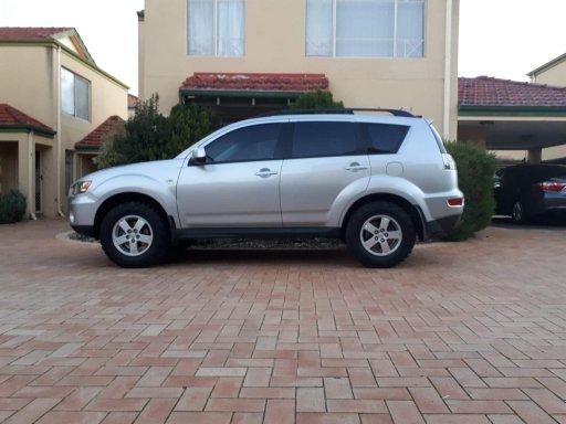

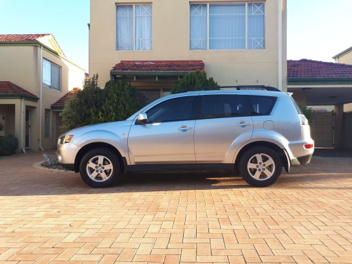

Love the build, i bought a 2012 Outlander ZH (4wd XLS 7 seat) a week ago (below image everything is stock) and have been trawling the internet to find ways to mod it for off road to make it look less soccer mum and more beast so happy i found your build.
Mods done:
-35mm lift, Dobinson springs
-Larger tyres Cooper Discoverer-M-S-225-75R16
Mods to do:
-Black rims (might plastic dip current ones)
-Nudge bar (but would love a custom build like your pics) Outlander 63mm NudgeBar or Outlander 76mm NudgeBar
-Decals/partial wrap (low priority)
Input and advice welcome!
By the way this is my first real car previously i had a Hyundai Getz. So please go easy on me i have never done any car upgrades or modifications before.
Stock on left (215mm clearance) and 35mm lift and larger tyres right (265mm clearance)
Mods i want to do:
-30mm lift (parts on the way) Dobinson springs This is the only lift springs i could find in Australia
-Larger tyres (Current Cooper Discoverer-AT3-215-70-R16. stock size) Max legal increase 50mm in diameter Cooper Discoverer-M-S-235-75R16 not sure if they will rub even with the 30mm lift, and can't find anyone else with this size fitted or Cooper Discoverer-M-S-225-75R16 but i really want the additional clearance the larger tires would give me.
-Roof top tent (already acquired)
Hey mate! Welcome to the forum and nice Mitsu! I always liked those. They look good when they’re all beefy!
I have heard good things about Dobinson lifts but no first hand experience. I have a 40mm strut spacer lift. Another option is a 30mm spring kit from H&R. I can’t recall the model number but should fit your rig too.
I have 235/75-15 tires and 1.5” wheel spacer AND an excessive amount of body material removed and have a verrrrrry slight rub. Before the lift I did my over fenders and the tires would have for sure rubbed. Your setup may be different then what u experienced.
Maybe you can find someone with a setup like that and swap tires for a trial run?
I ended up doing full bumpers as I had all the material and tools at my shop. Plus, I hit a deer and needed to get the car fixed ASAP [emoji13]
Good luck on the build and congrats!
Reactions: steve20286
