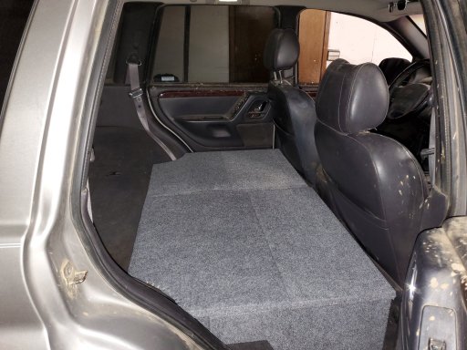

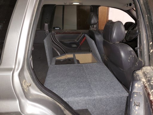

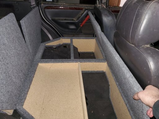

Good to see another WJ build on here, looks like you got a good start going. Like others have said there isn't much out there for the WJ for off road parts or pre fab drawer setups. I did something similar to what @tjZ06 mentioned with removing my rear seat and built drop in boxes for storage. I made it a 2 piece setup that matched the split of the rear seats so I could put one side or the other back in if I were to have passengers in the back. Makes for a decent amount of extra storage and having the entire cargo area flat I use mine to sleep in
Nice job on the seat delete! We removed the 2/3 section from ours and built a dog platform for our GSD that was much lower and easier for her to get in and out of as she was getting old. No that she is no longer with us, we just pulled it back out and planning on reinstalling the seat. I will miss the storage for the heavy stuff, and your pics make we want to build a new version .. lol but now the WJ is mainly a day or overnight trip rig, we could use some back seats as we have deleted the other rigs.

Spot for the dog was another reason for building mine as I did, we have a Great Dane/ Mastiff mix so that setup gives her plenty of room. I put up a pet barrier on the edge of my boxes so she gets between it and the front seats then pack all our gear between it and the rear hatch. The amount of space gained with the boxes apposed to just folding the seats down was impressive. I used to keep all my tools, recovery gear and random crap in the spare tire compartment but with the boxes I was able to empty it out into just one of the boxes and had the whole other one for camp gear.

@MrWilsonWJ really nice build on the rear seat delete. I've got two kiddo's, one pretty fresh and the other just a few years old so I'll be keeping the rear seat in tact but will be building out the rear cargo space. We get about two weeks a year to get out there so it won't be anything too crazy, but I do want it built out for emergency preparedness as well. I enjoy studying online maps throughout the forest systems to try to find hidden gems to explore while we're out there. I appreciate the photos, they will help me, no doubt.

@MrWilsonWJ, You could sell the dimensioned plans for the rear seat delete and save us all some time trying to copy it! very nice.

When I built those I used osb because I had a sheet laying around and well didn't feel like going to buy a sheet of plywood. While they are still usable and good shape some of the screws have pulled out for the lids so I'll be pulling them apart to rebuild out of better material at some point. If people are interested I can pull all the measurements and post them in my build thread. Not sure when I'll get to doing it though.

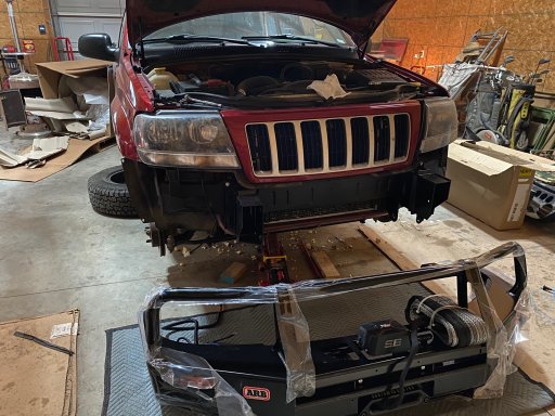

Winch has arrived in the mail. ARB front bumper is set to arrive next week on a freight truck! Going to get the factory bumper/facia removed this weekend. Also rebuilt the rzeppa cv joint on the front drive shaft at the transfercase.

Gaining on it, waiting on a few extra hands to float the bumper for mounting. I tried with just one helper and we found we needed more hands. Not the easiest task, lining up the mounting holes.
Winch installed well. I had to clock both the motor and clutch ends of the winch. For anyone curious, it is possible to click the smittybilt xrc 3 series (install manual said otherwise) the fairlead that came with the winch was not compatible so I swapped in an offset fairlead from a local company, custom splice, which was a cool addition. Been fixing a few little odds and ends while waiting on some willing helpers for the bumper.

Finally, it’s mounted, winch is hand-spooled and ready for a tension spooling. Ready for some trips this year now and it’s maiden voyage.
Bumper and winch look really good! much better than my DIY winch/towbar setup.
