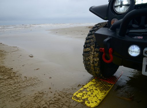

This is some testing I did with Traction Jacks.
