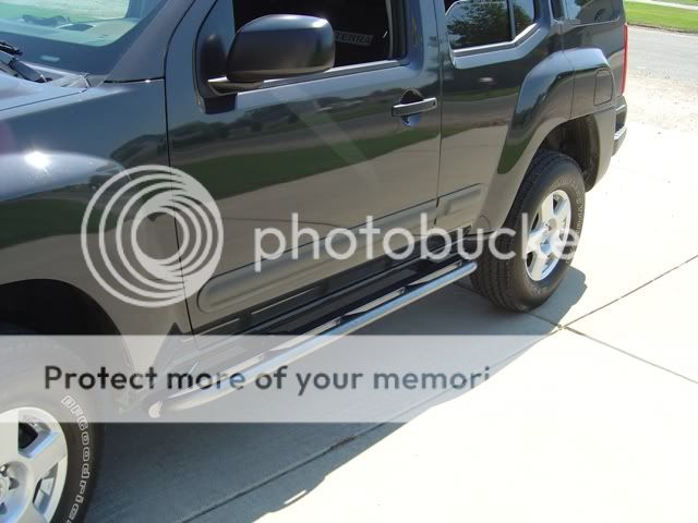

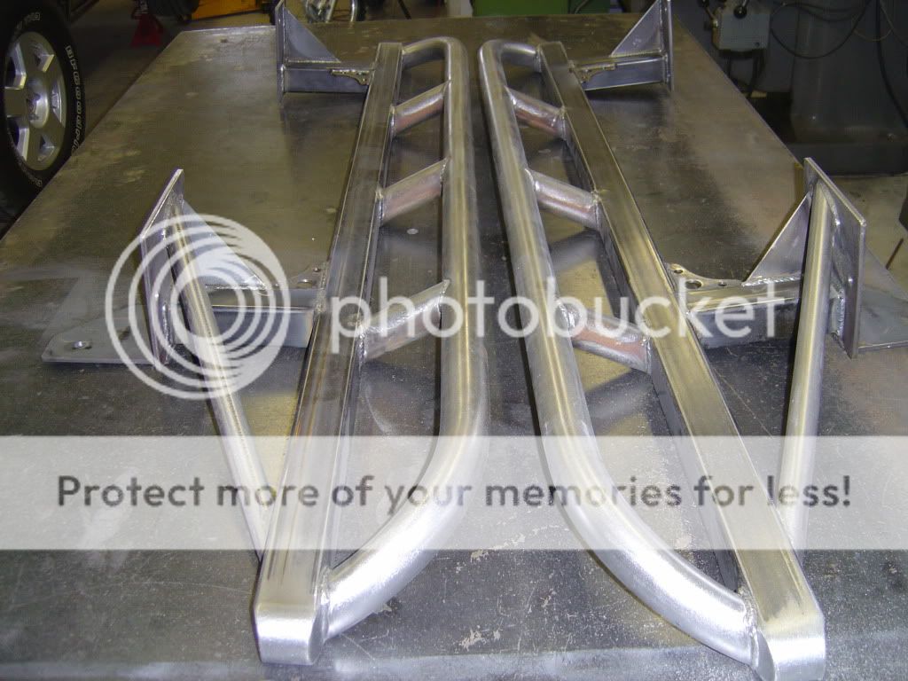

I first started off with a PRG advanced coilover kit (radflo coilovers, UCA's, AAL's, bilstein rear shocks) and built some sliders. What an upgrade from the stock suspension!!

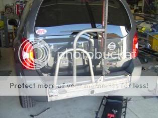

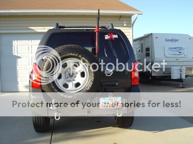

Then a rear bumper followed.

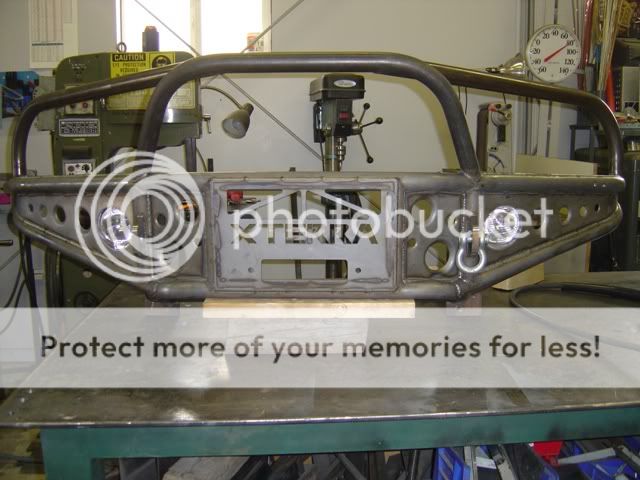

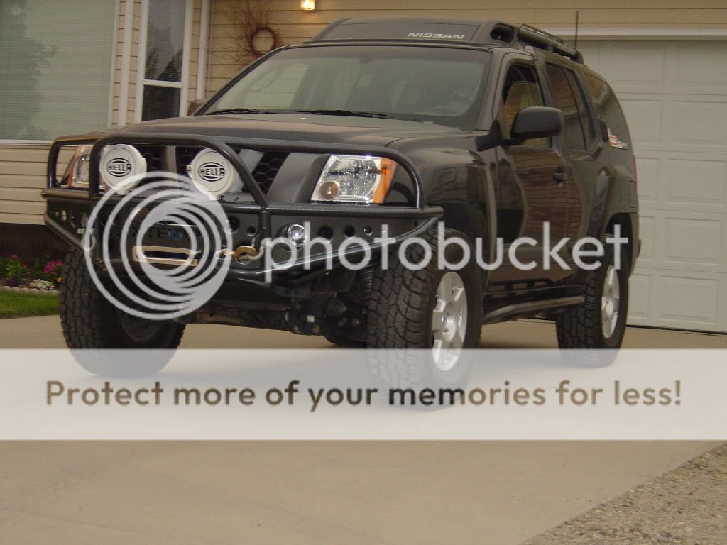

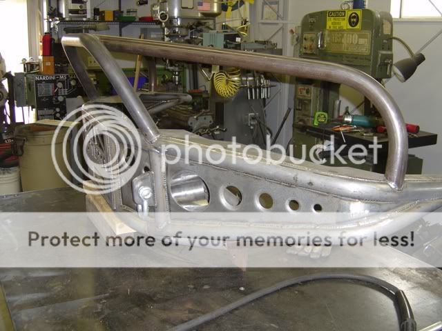

Then a front bumper build & some skid plates.
Lights, wiring, etc

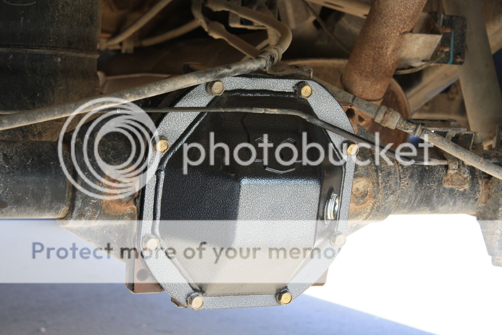

Diff cover

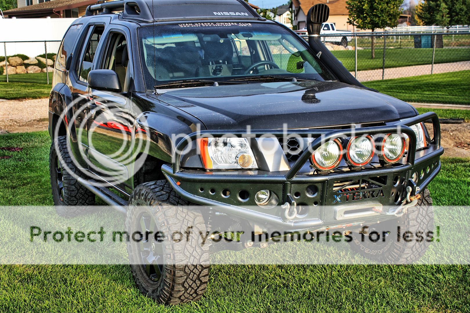

Another new bumper with some subtle upgrades and backup lights this time.
Stayed pretty much the same for the most part for several years. More gear, full skids, more gear... Well used and enjoyed

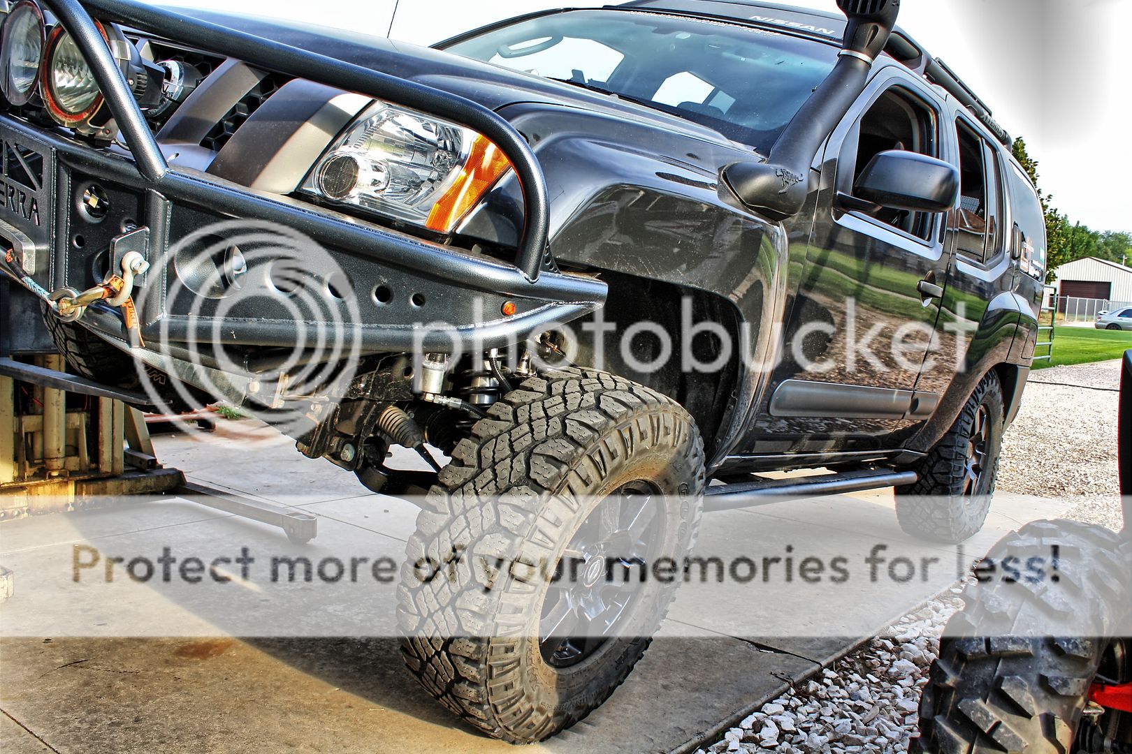

A snorkel somewhere in there

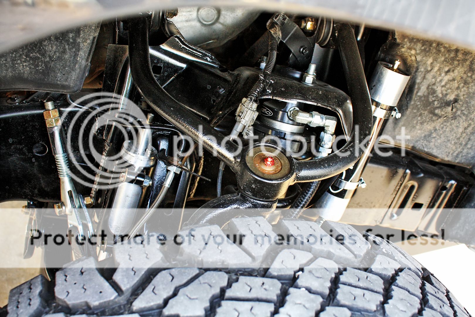

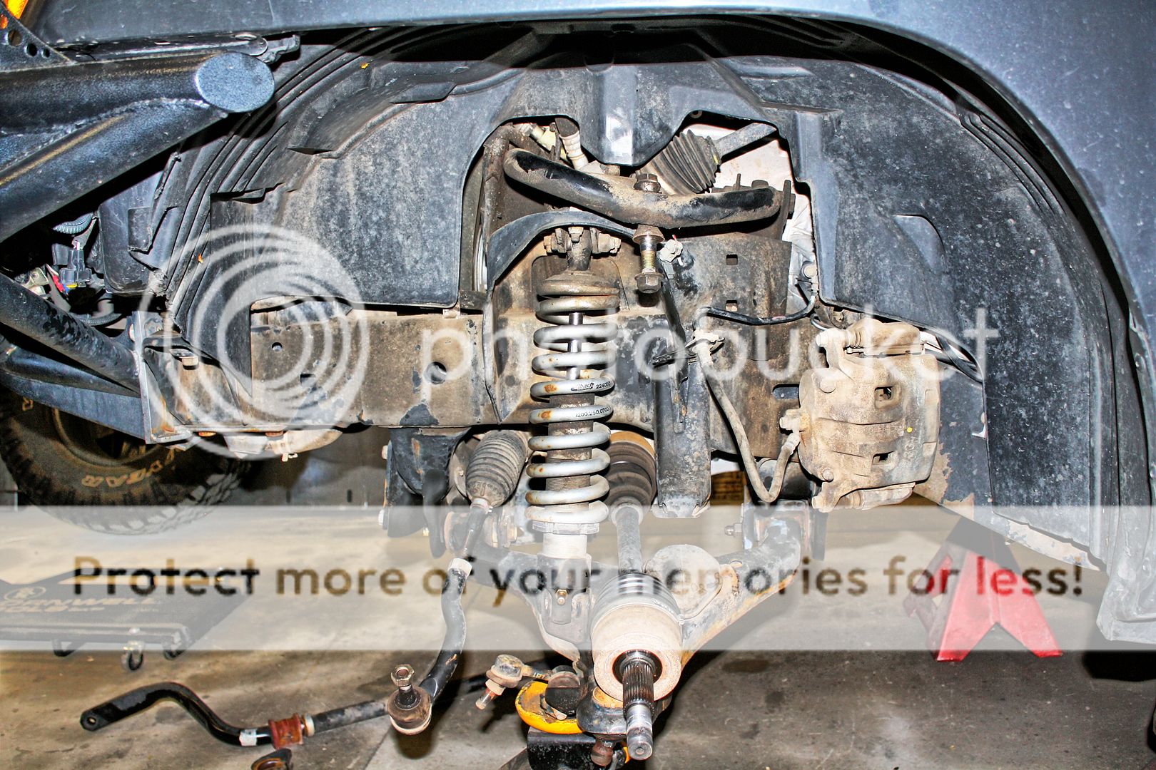

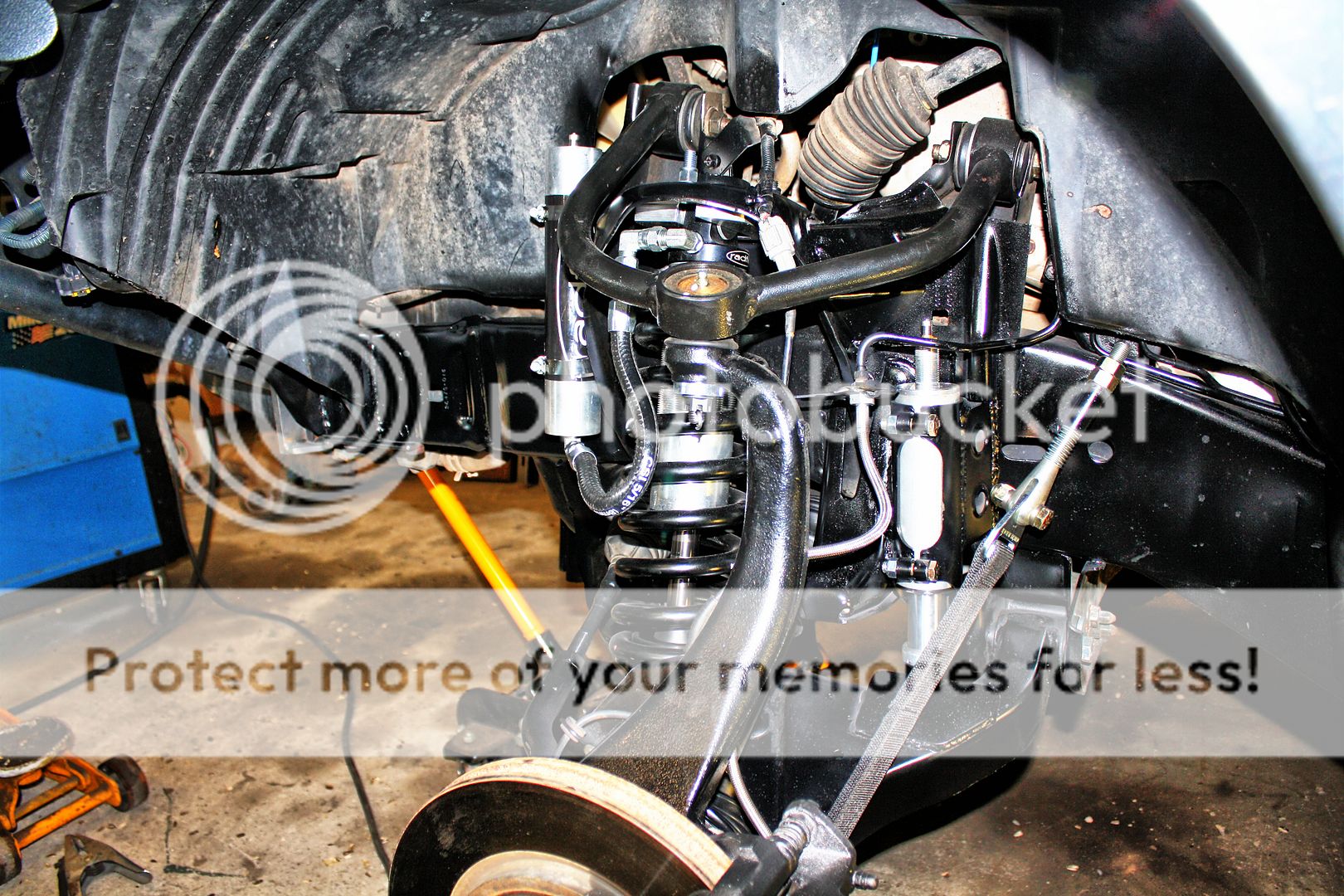

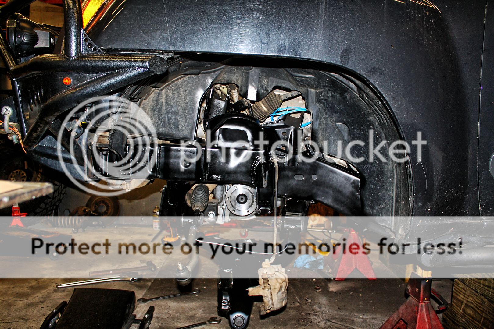

Figured it was time to do the TITAN SWAP as it's referred in xterra forums.
Unbelievably, all the front suspention and diff from a titan truck will bolt up to an xterra or frontier.
Wider stance by nearly 3" and with a good coilover and aftermarket UCA, almost doubling wheel travel to near 11".
Brand new M205 front diff, CV's, LCA's tie rod ends, Braided brake lines, Rough country UCA's and new Radflo remote reservoir coilovers made for the titan swap.

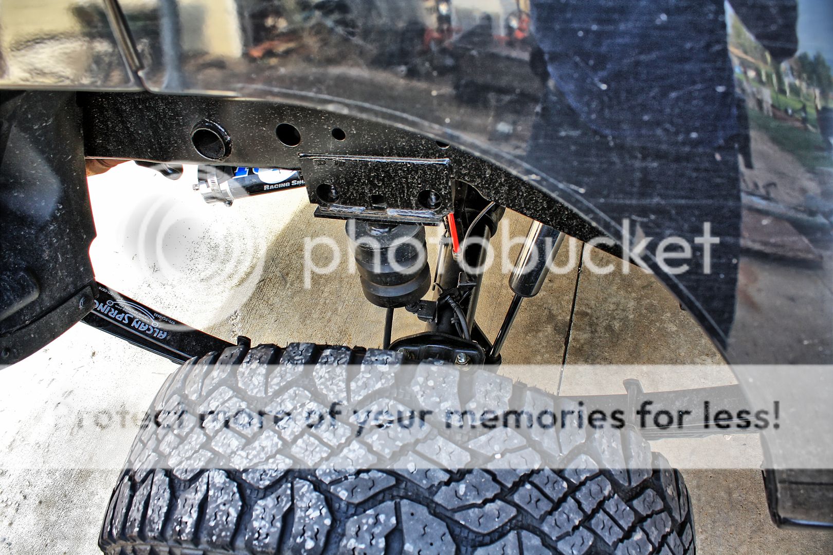

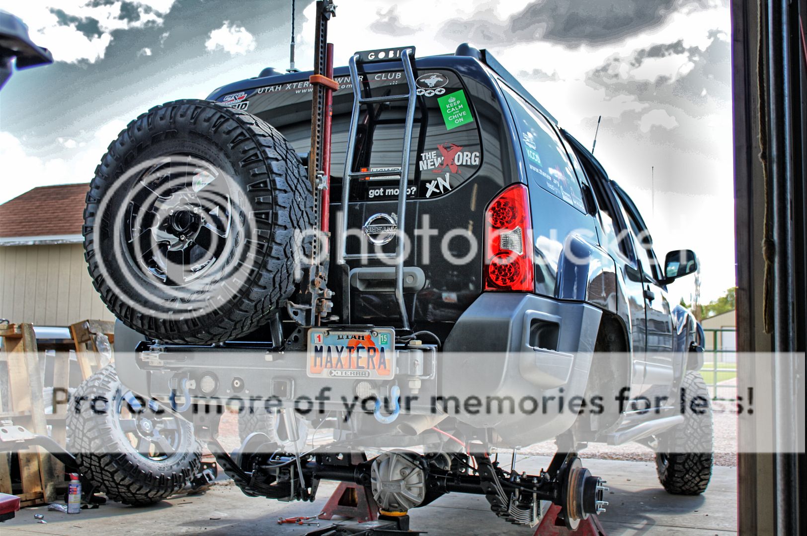

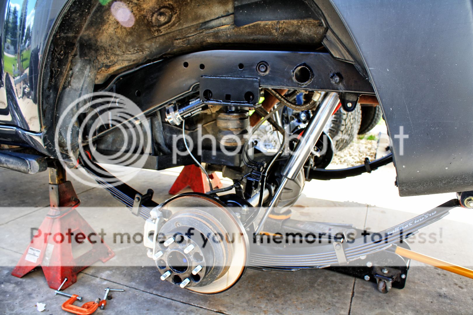

Rear end got an almost brand new M226 (dana 44 variant e-locker rear), Alcan springs 3" lift, #450 heavier rating, Custom tuned FOX remote reservoir shocks, U-bolt flip kit, HD aluminum diff cover, Timbren bumpstops & relocated brake line mounts.
Well used old suspension components coming out
Some new stuff going in and frame all cleaned up and repainted.
Added radflo hydraulic bumpstops to the front along with limiting straps to finish it all off.
Rear all put together and checking flex.

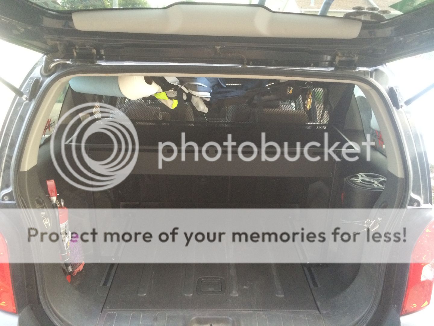

A new rear cargo shelf build

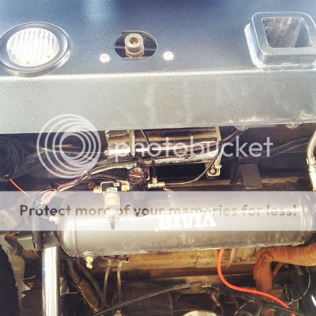

Viair OBA setup for tires and ARB front locker operation.

Oh, I also have a GOBI roof ladder there on the back that I got in a group buy. I think the only piece I didn't make?

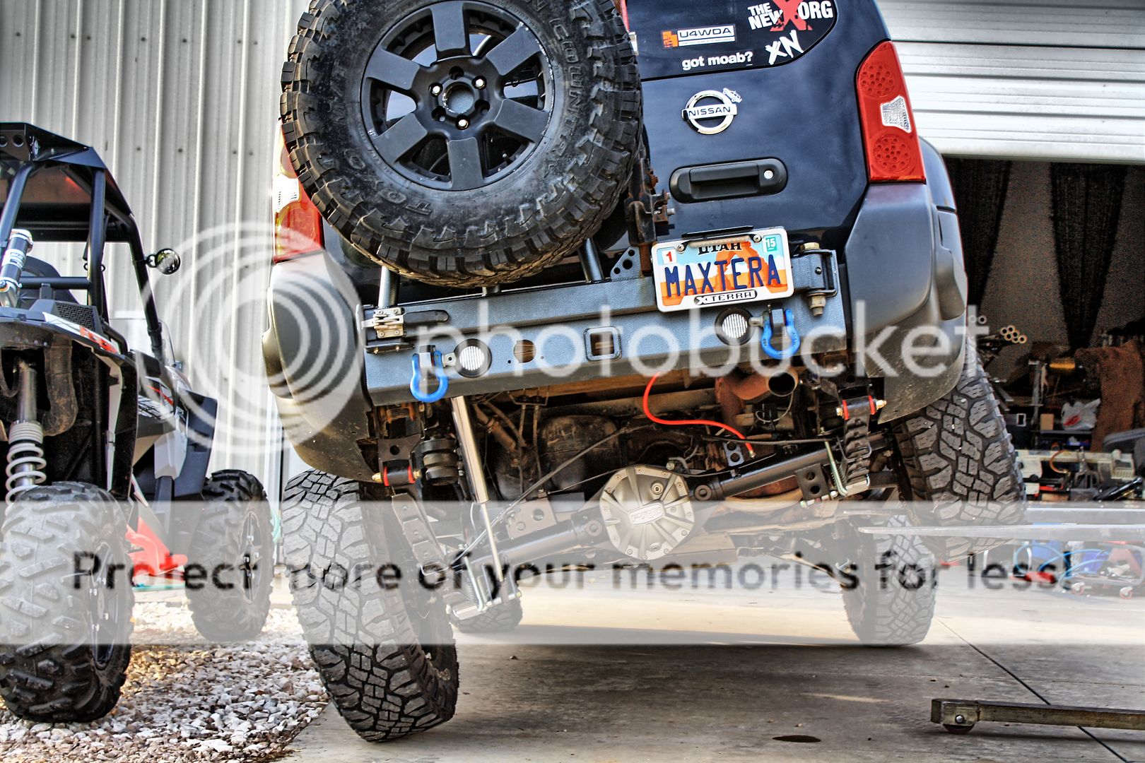

Came out with a new gas can carrier model rear bumper and after several tries to get one done for myself (always ended up using it to fill an order) got one for ME!
Added axe/shovel mounts behind the tire and the LED marker lights in the swingarm. Working exceptionally well!

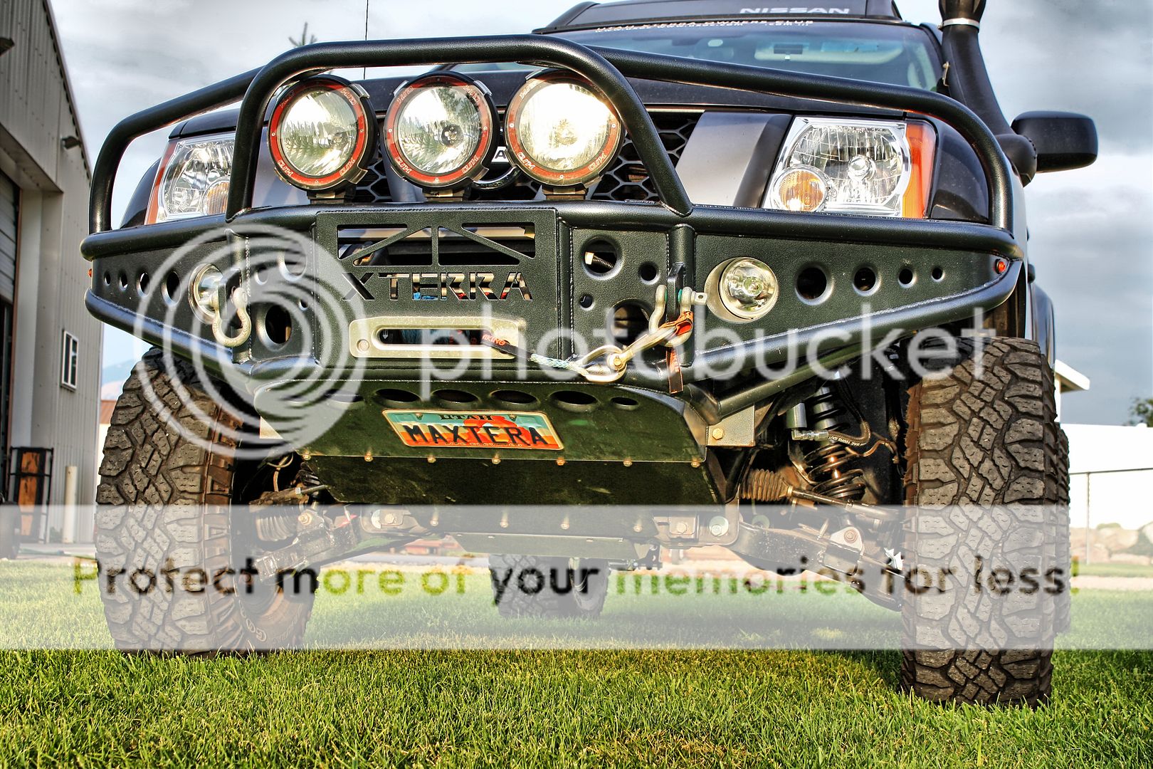

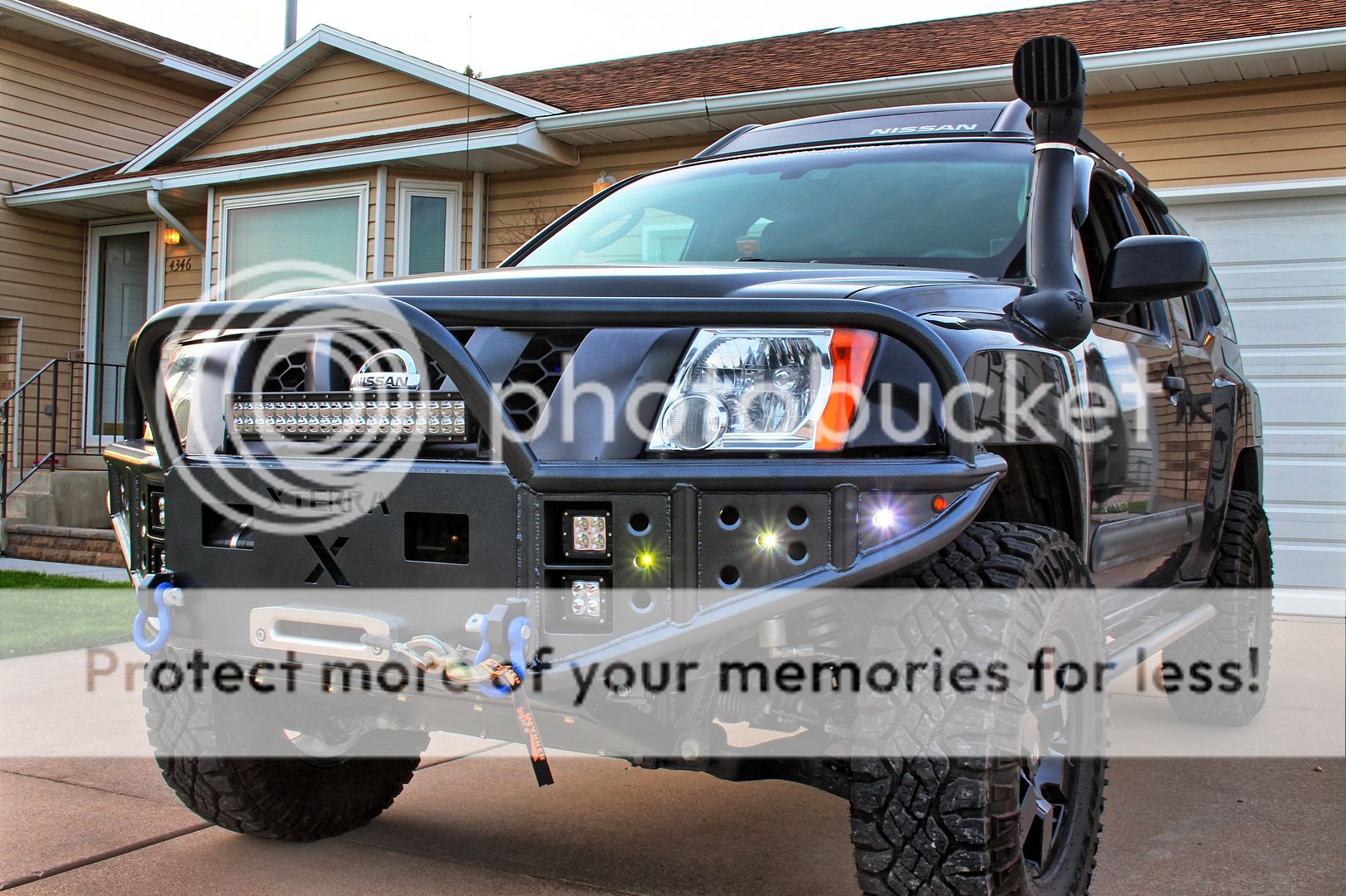

Then, in anticipation of the body lift, a new front bumper with adjustable mounts as the old one was welded up solid and I didn't want to cut up and re-do (but I really loved that bumper!:tearsofjoy:).
Built in LED pod lighting and daytime running light LED's in the wings.
Replaced the synthetic winch line and went with a flatlink this time (much cleaner).
Added VLED's switchback turn signal/marker light LED's and man, are they bright! You can almost drive with them at night if you don't hook up the dimmer wire to the headlights to tone them down at night.
Got the bumper in a little tighter and higher this time, though I never really had any problems with it before.

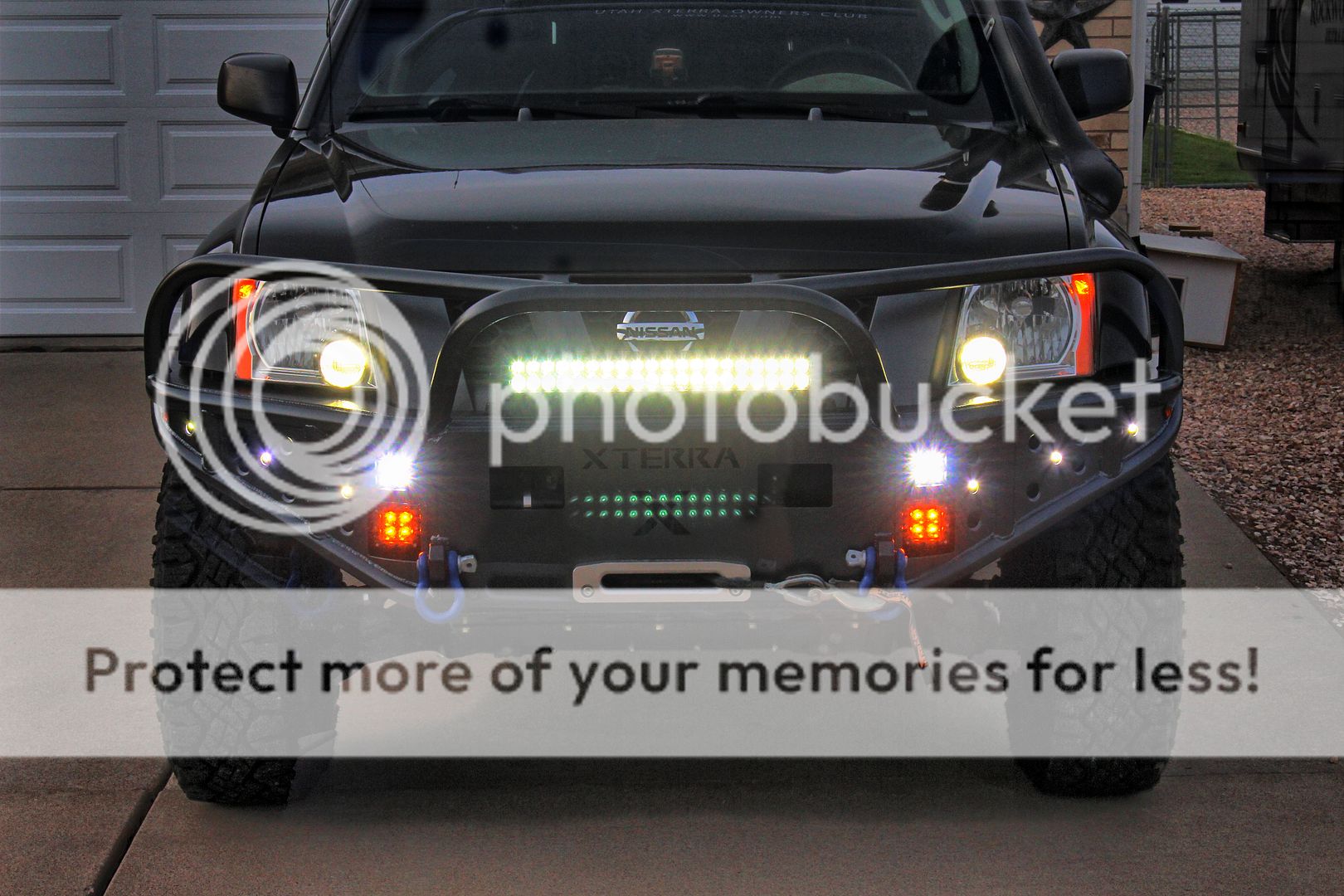

Got my Aurora 40" 10w elements hybrid light bar on. Also the switchpros controller hooked up last week.
Gotta say, the controller is awesome! So many different programming options, and the blink/strobe option is fun.
Ran a group of 14 across the desert all day, with pretty heavy dust. All those with leds, you could see them (Amber or white) ,whereas incandescent couldn't cut thru. The said the strobe really caught the attention.
Got four 18 watt floods to put on the side of the new roof tray, and I think I'm going to get this flood bar/Amber strobe for the back for dust light/rear lighting
https://www.superbrightleds.com/moreinfo/specialty-high-power-led-spot-lights/18-off-road-led-light-bar-with-integrated-amber-led-strobe-light-head/2056/4282/
Except for rock lights, I'll be done.
