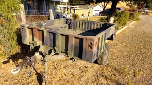

Looks like it's in great shape. If you don't mind me asking what do those usually go for and where did you find it?Just got my m1101 can’t wait to start building it. View attachment 123983

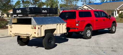

First got rid of 37” tires and got hitch so it would ride level. View attachment 123984View attachment 123985

I used 1 1/4” square steel 1/8 thick to make rack. I basically made a bed slide for rack so the whole tent slides over so annex doesn’t drape over side of trailer. No issues with weight. Tent is Cvt mt Denali summit series and around 500 lbs between 3 of us sleeping.What is the thickness of the square tube you used for the top? Have you had any issues so far with the weight of the RTT and people sleeping inside?
