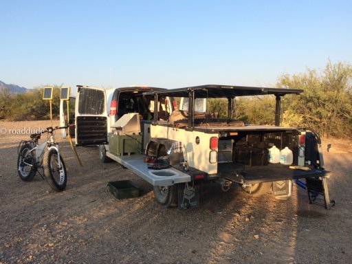

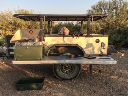

I have a galley setup similar to the one you have in the drawing. Here's a pic of mine without awning or tent yet:
And from the opposite side with everything set up and attached. You can just see the end of the galley table with faucet:
Makes for a really pleasant basecamp set up. Not a M101a1 trailer, but damned similar. In fact made by the same folks who make military trailers for govts around the world.

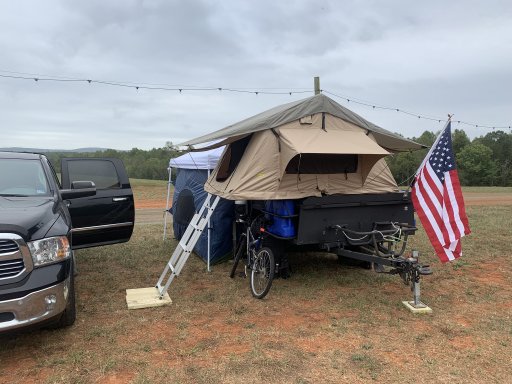

I have 2 M101A1’s. First is my primary build and they one I use all the time. Aluminum split top with a truss support for a Smittybuilt RTT. Have 210 aH of battery with 100 watt solar panel set up as primary power and ability to run a 900w gene if necessary. I put in a 46 gal water tank with a 12v on-demand 3gpm water pump. And at request of my significant other, a 3gpm on-demand propane water heater for a shower. I carry an extra 24gal of water in 6gal containers for a total of 70gal. Longest trip was 11 days, totally off grid. Pic 1&2

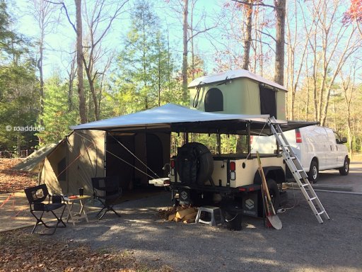

The second one is a project trailer for my son and I. We have a raised aluminum truck cover. Have a single bunk with under bed storage. Have 90aH batter with 100w solar charging. There is a 8 gal solar water tank on top with faucet for shower hook up. Pic 3&4
