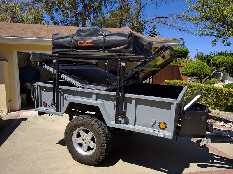

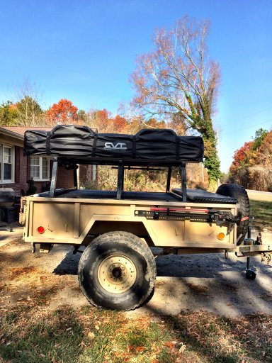

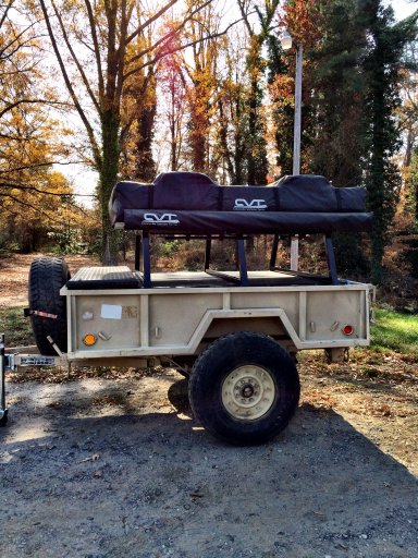

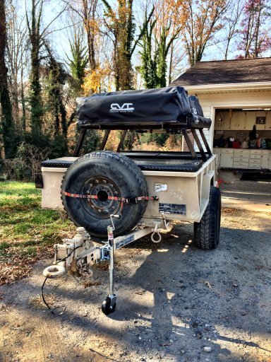

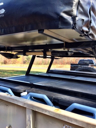

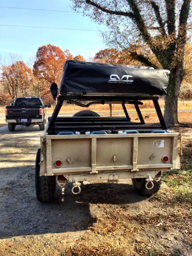

I'm finally making some progress on my trailer build, M101A2 with a Tuff Stuff Overland RTT. Had a local fab guy weld me up an aluminum rack (I haven't ventured out from steel in my welding yet), and I have just about completed a homemade tonneau cover. 1" aluminum square tubing and 1" blue foam board sandwiched in between two FRP panels. Already converted it to 12v, changed out the hitch for a 2" ball, and replaced all the lights with LED bulbs.

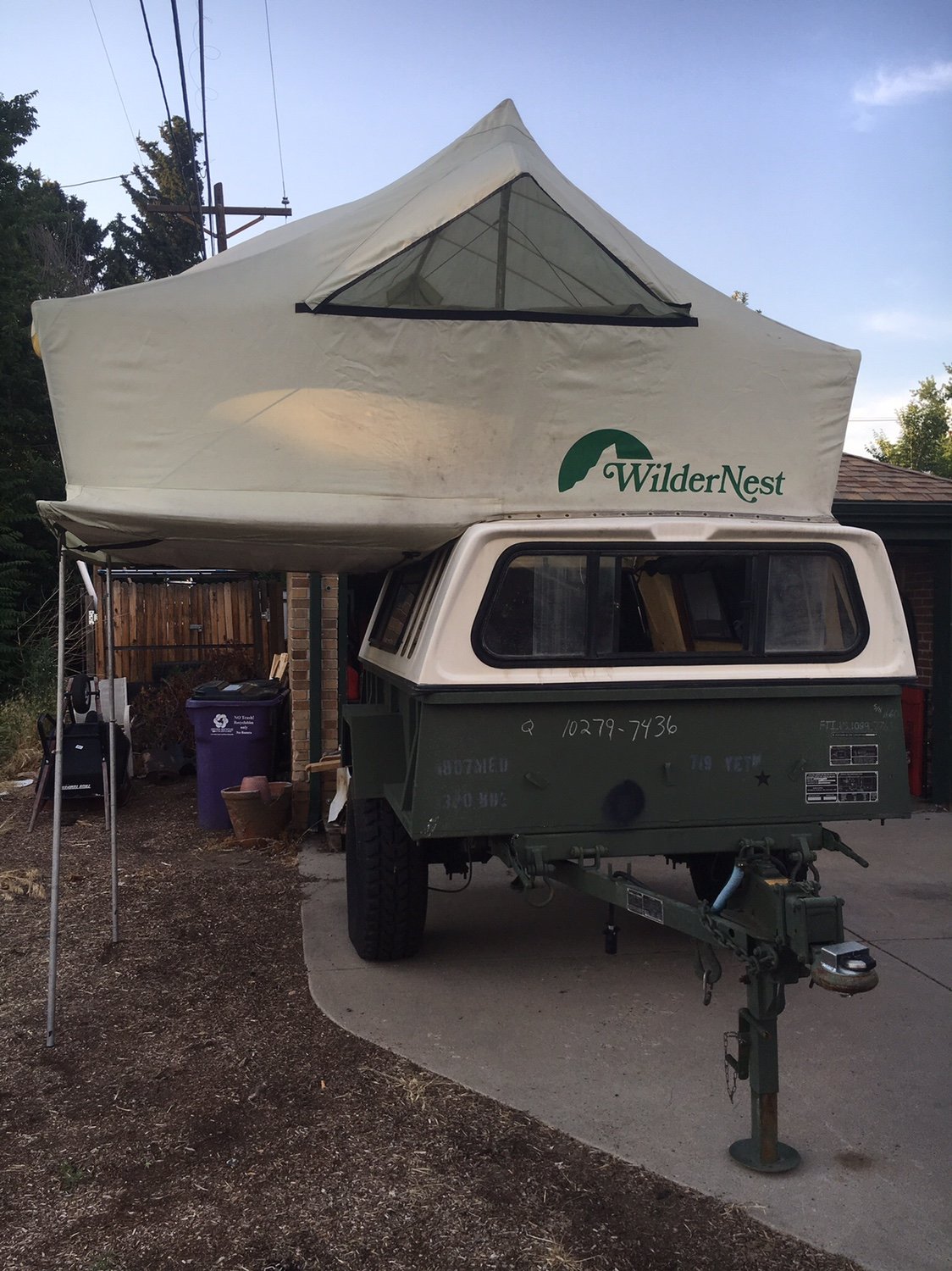

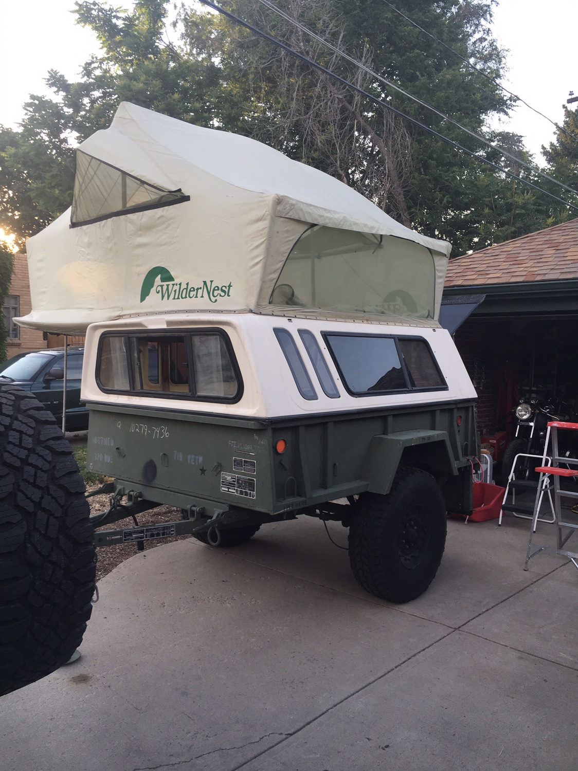

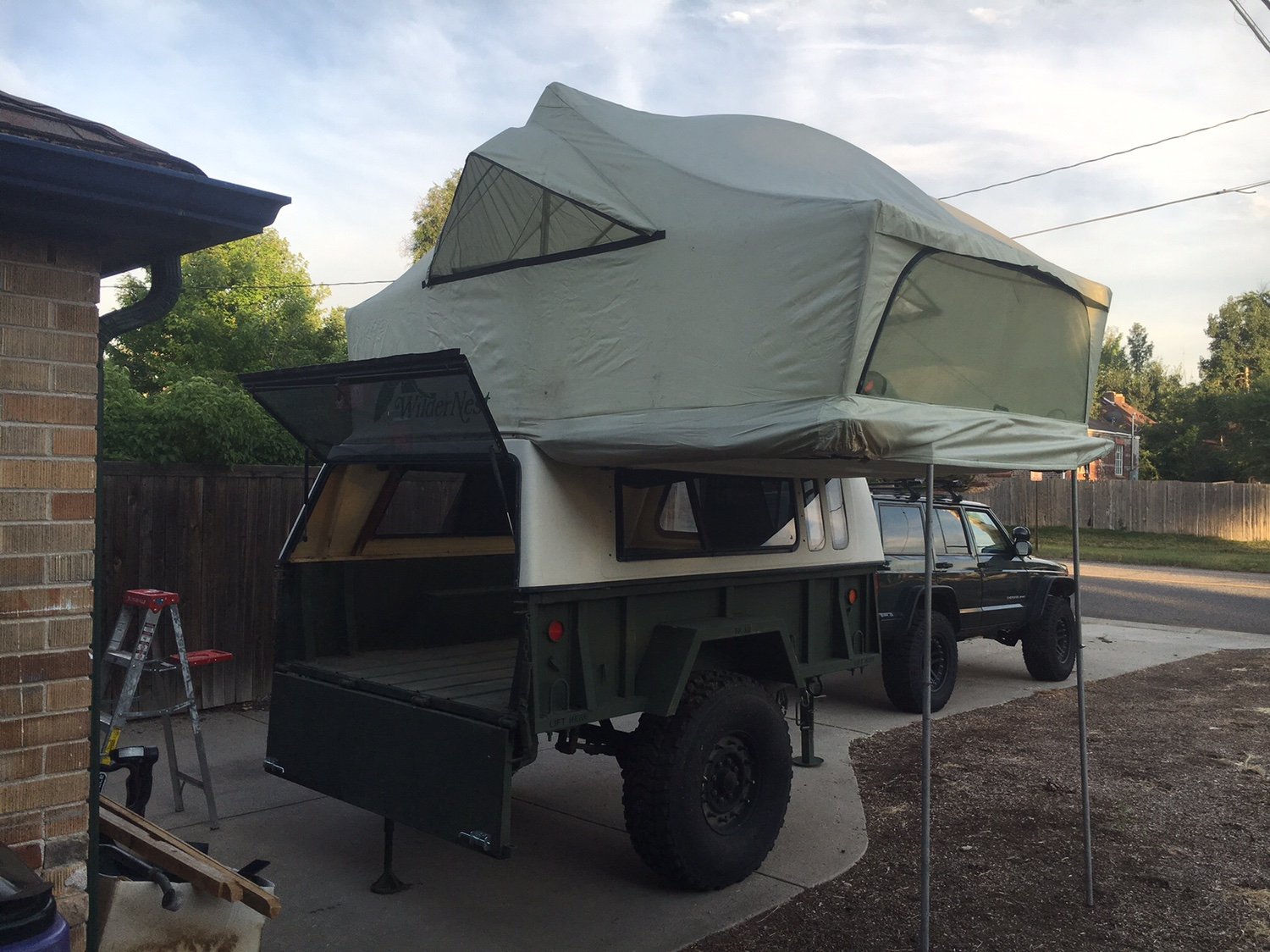

He is my M101A3 with a Wildernest cap. The project stalled when my back went out. I’m between surgeries right now, but hope to get back to it very very soon.
That's pretty interesting, how the tent snaps to the truck cap. You gain access to the tent from inside the trailer, goes straight up and in? I don't see any other way to get in from outside. Interesting set up!
303JETSET
1,402
Denver, CO, USA
James
Totten
12343

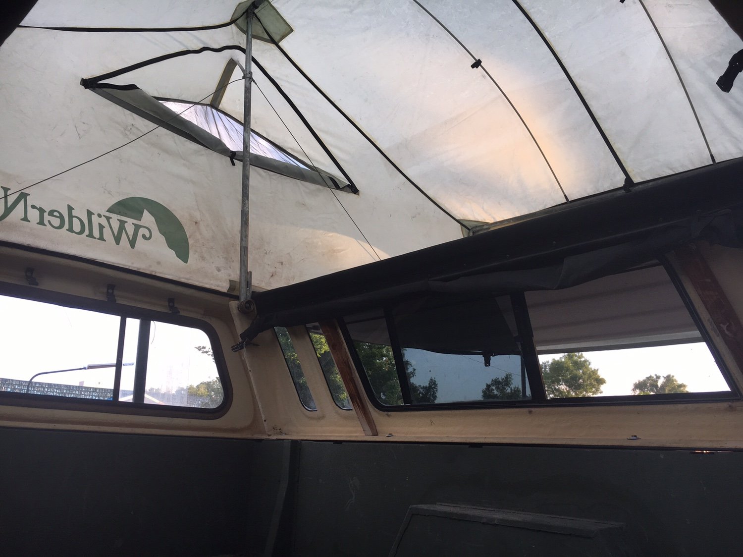

The top of the cap flips open. More than 8’ head room at the peak.

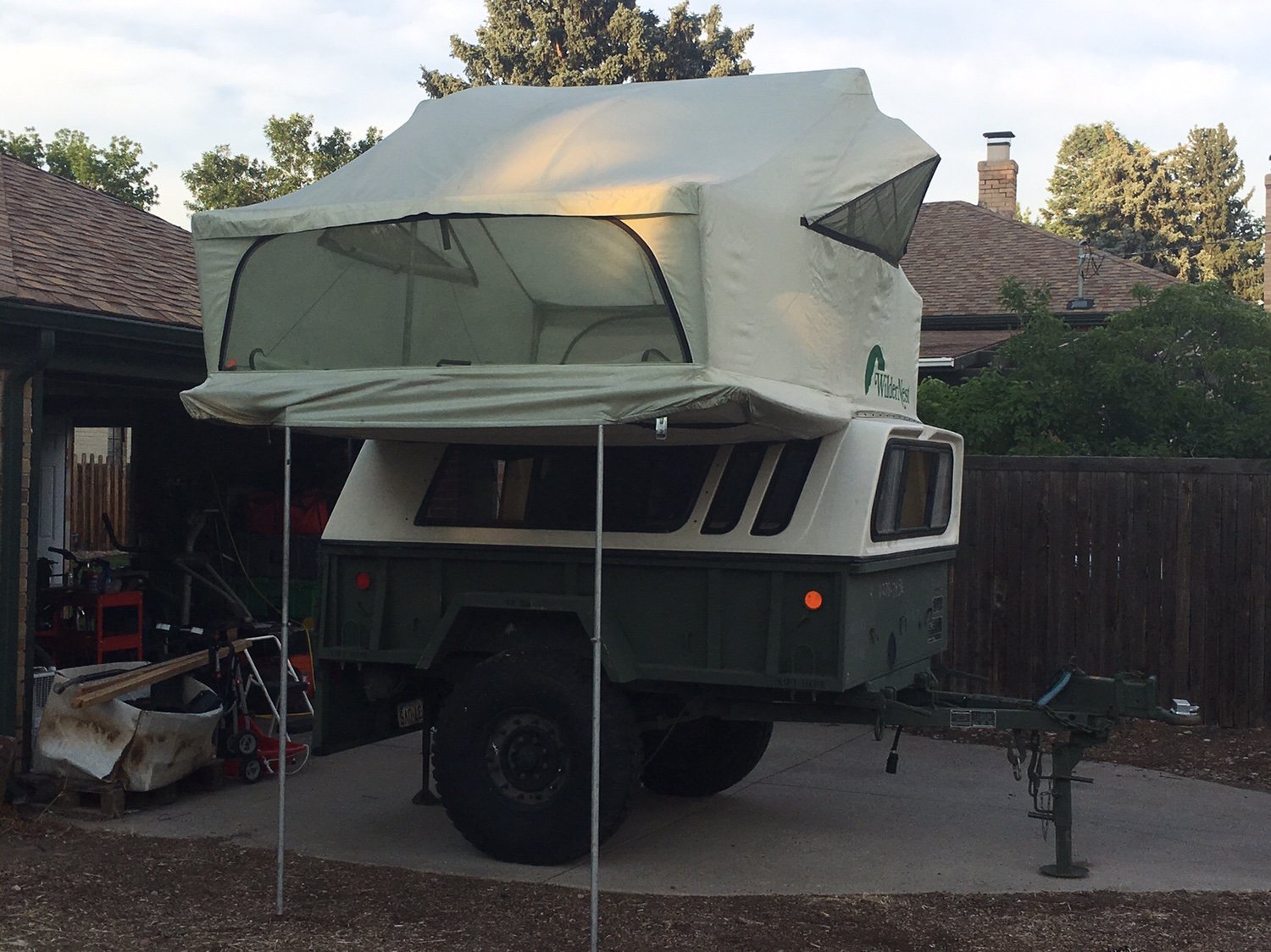

First one I've seen like that, though looks like the style has been around awhile. Thanks for the add'l image!

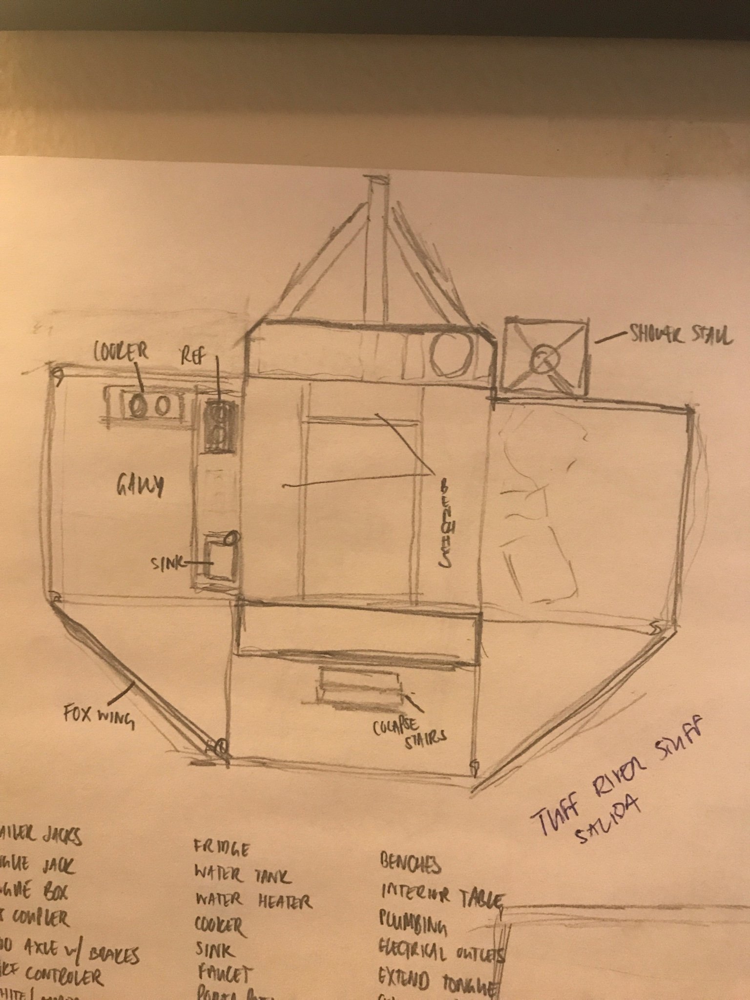

It is an old design. The Wildernest company was based out of Boulder, CO but went out of business in the 90’s as I understand it. As soon as the doctors tell me I can get back to my life, it will be getting a full build out to include axle with electric brakes and matching pattern to my XJ. Here is a pic of the plan.
