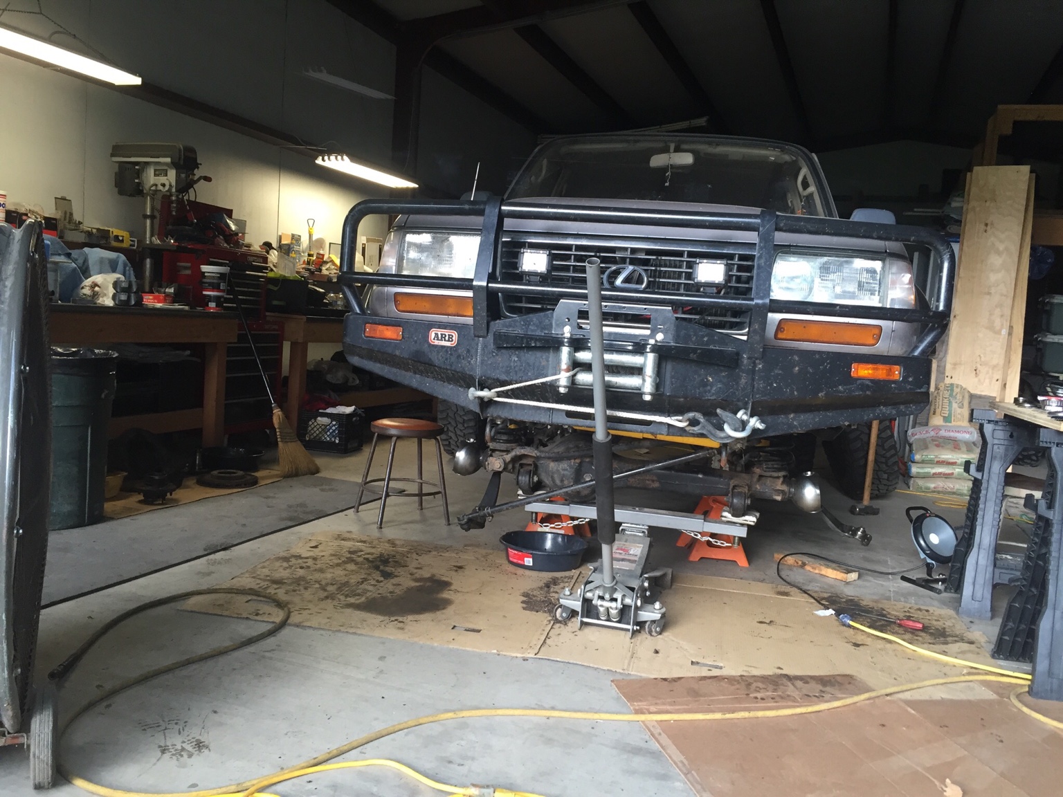

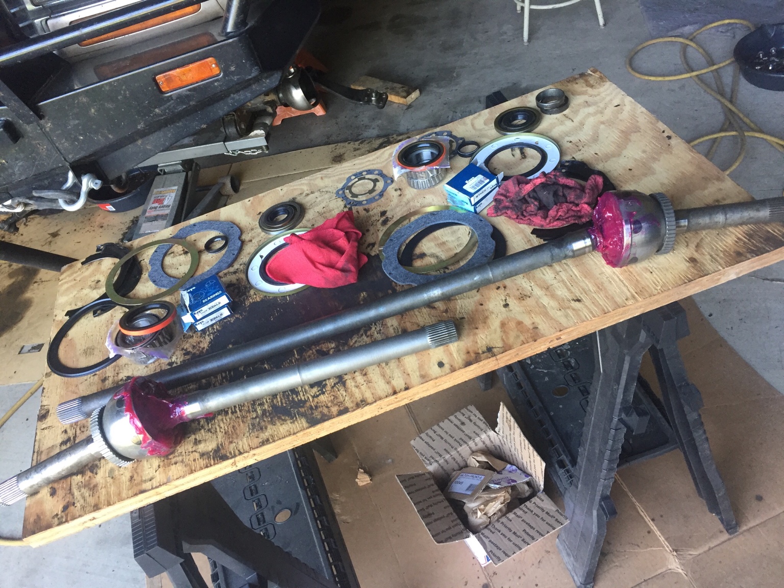

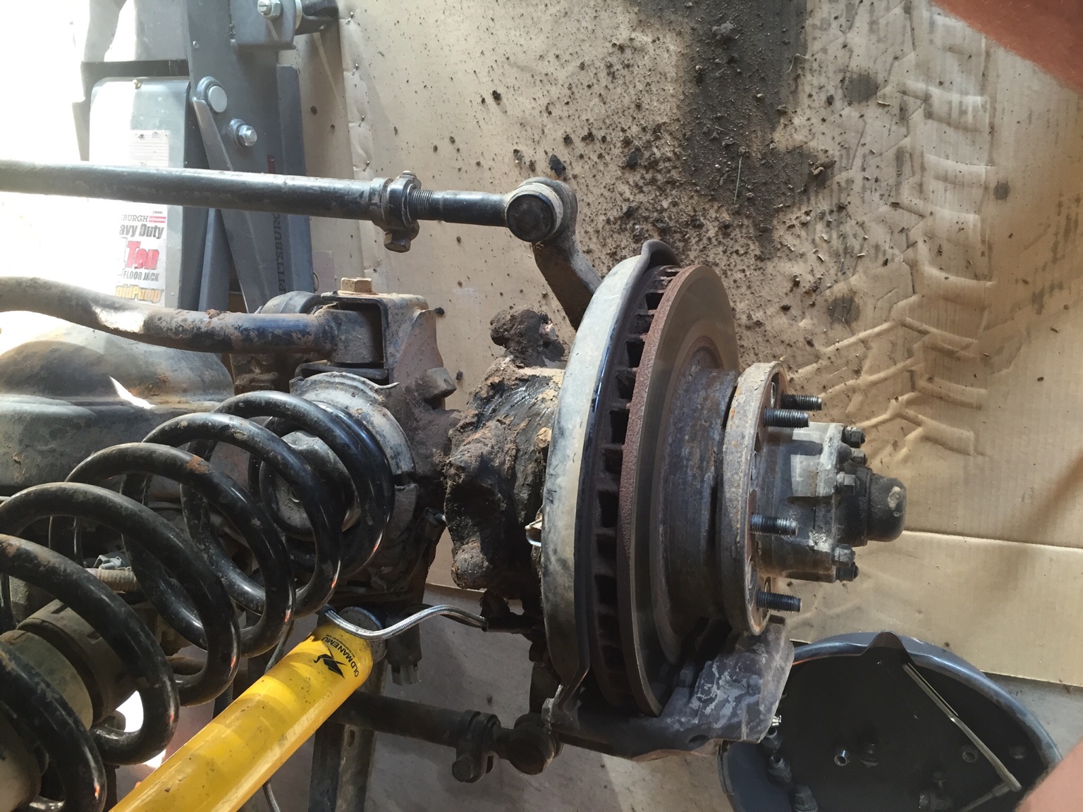

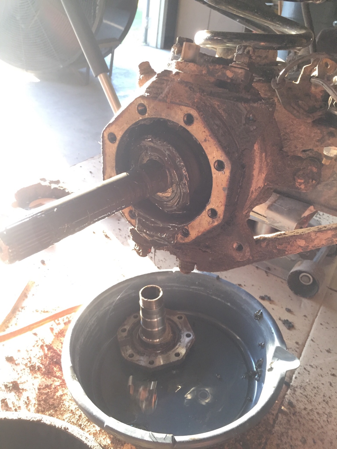

Started on the front axle rebuild this weekend. Seems to be a lot of "while your in there work"
started breaking it down to remove the knuckle

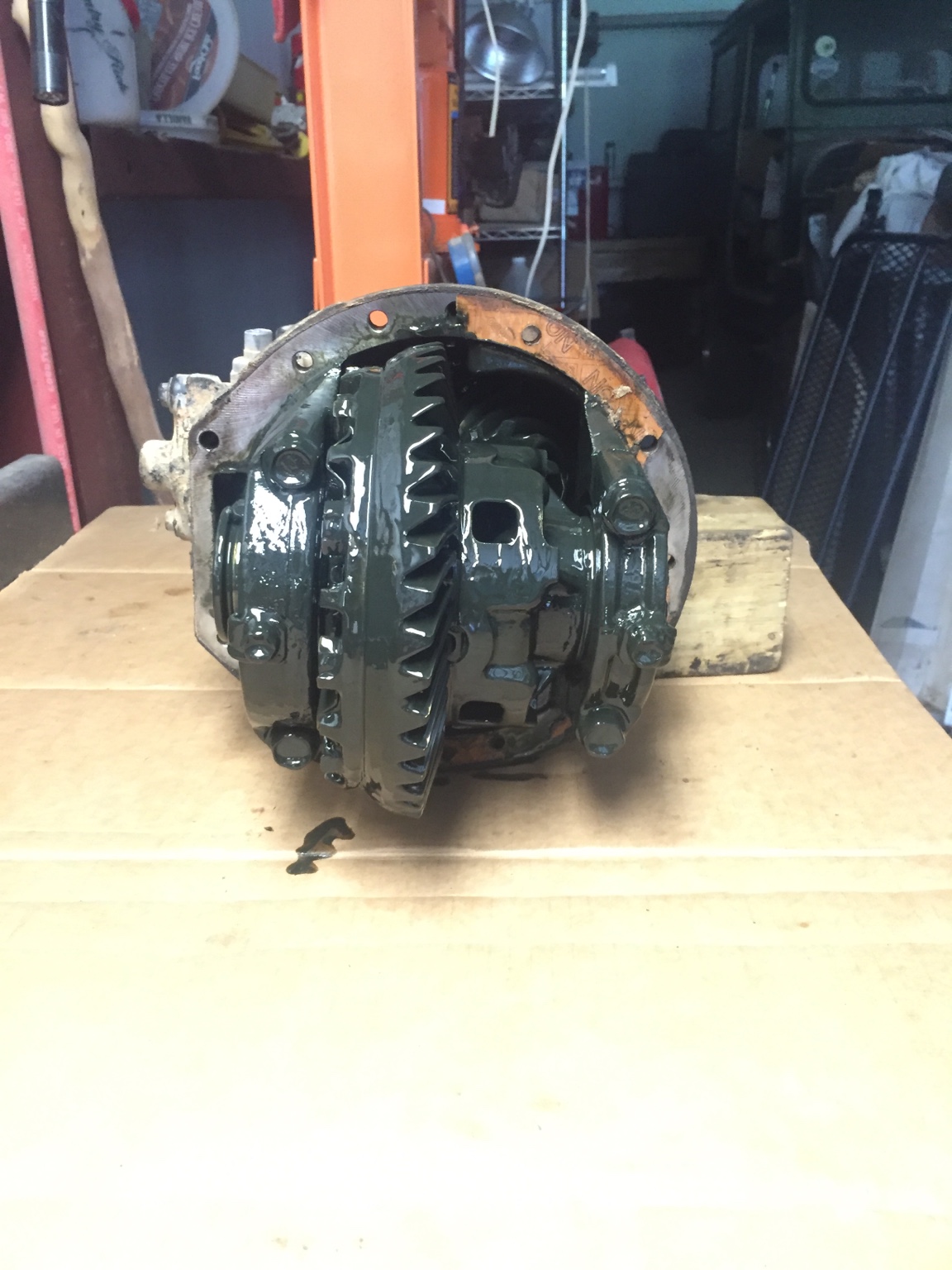

got the inside of the knuckle housing cleaned and the birfs cleaned out and re lacked with grease
took down the driveshafts to get them worked on and the front differential
fluid was really nasty. Next weekend we will start the re-assembling everything when the new parts come on. Have to replace the spindle because of of wear from the bearings.
