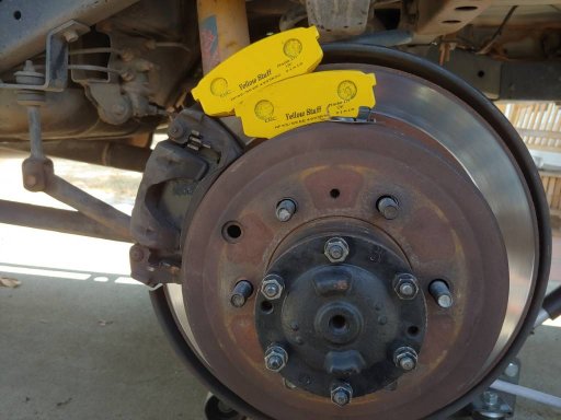

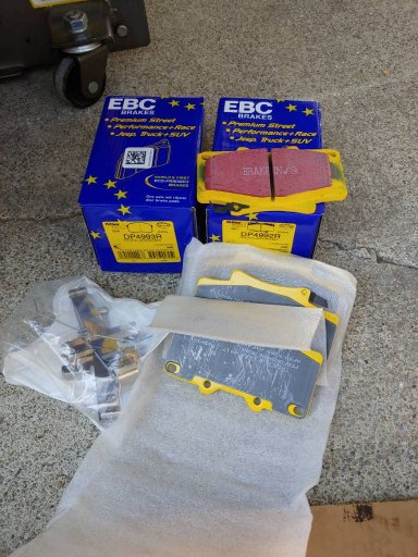

Ebc yellow stuff pad swap. I can't believe a LC can stop this fast. Best upgrade ever!!! No regrets except for the extra brake dust, but who really cares when you drive a 4x4 anyway since it's usually dirty and dusty.

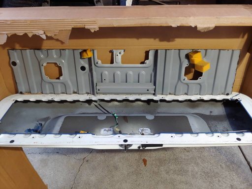

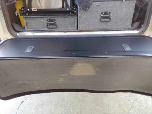

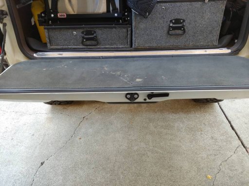

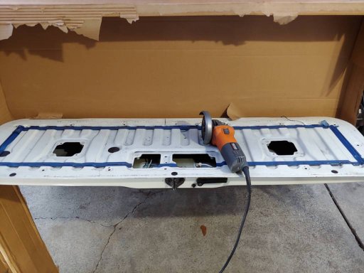

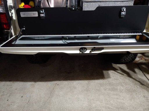

Back Bay Customs tailgate storage mod. Easy install. It's stupid expensive but all Cruiser things are always expensive. Don't but a Cruiser thinking parts are going to be cheap. Cause it ain't. Go buy a Taco or 4R if you want slightly cheaper parts.

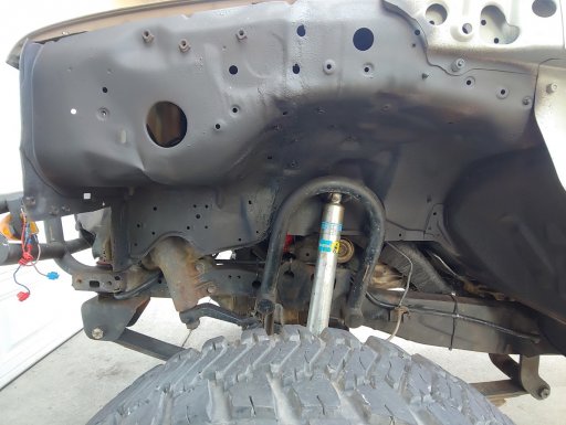

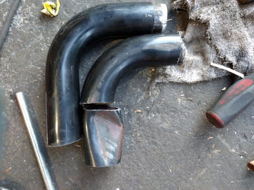

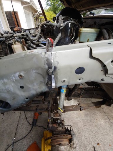

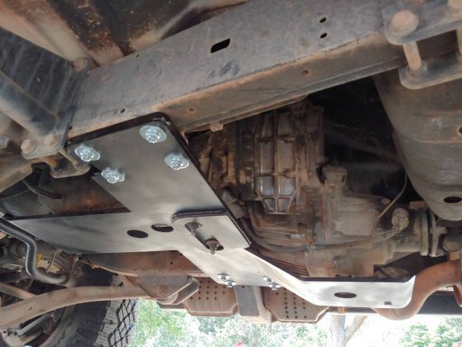

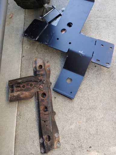

Iron pig off road cross member armor. Had to mod the cross member cause my sliders interfered. Cutting half inch thick plate aint easy.

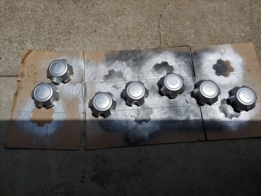

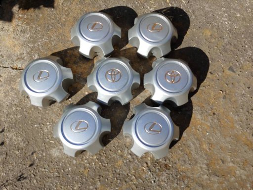

Refinshed my LX and spare LC wheel caps.

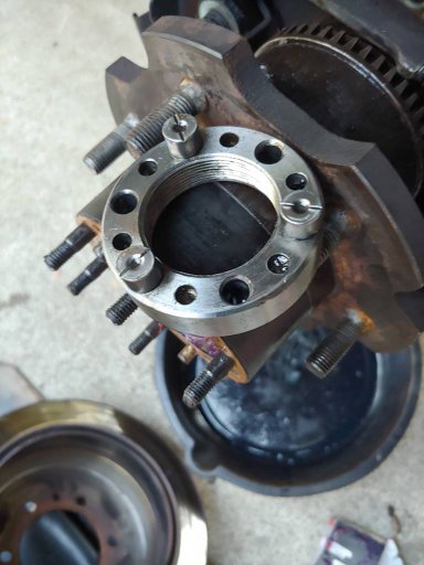

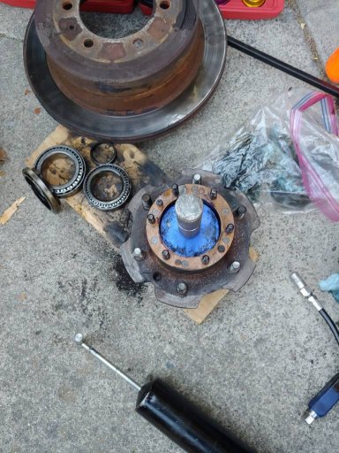

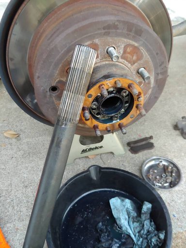

New wheel bearings anf seals for the rear. It was leaking all over my brakes.20180720_133101.jpeg20180721_172627.jpeg20180720_190600.jpeg20180720_181805.jpeg20180720_183823.jpeg

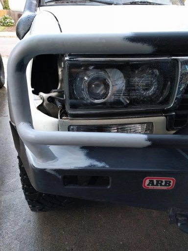

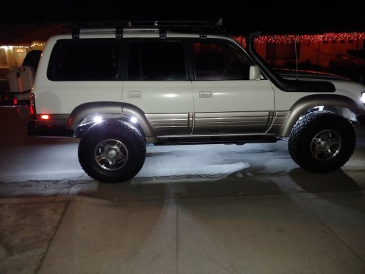

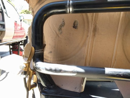

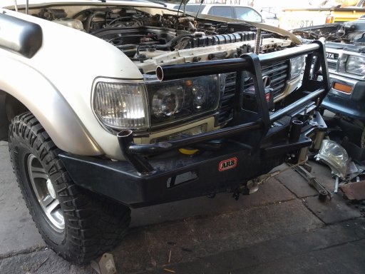

Repaired the ARB Bumper and sleeved the inside. Good as new!

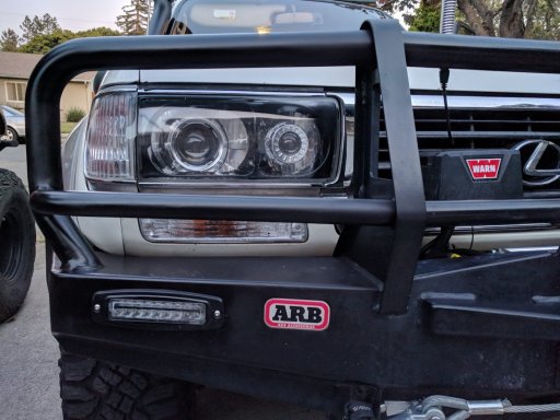

Also did a mod and went with a LED turn+fog light combo $20. Had to cut the ARB bumper and make the hole a tad bigger.
I just touched up everything with Cardinal Semi Gloss BK01.

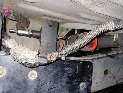

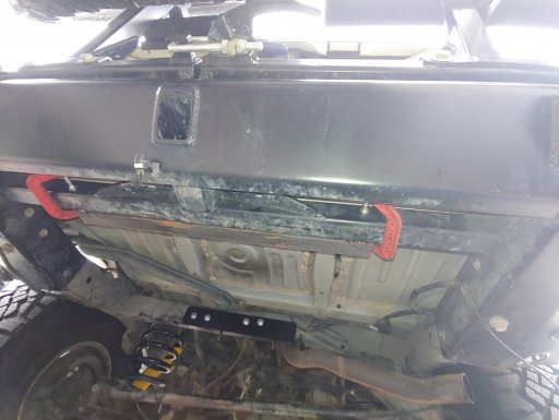

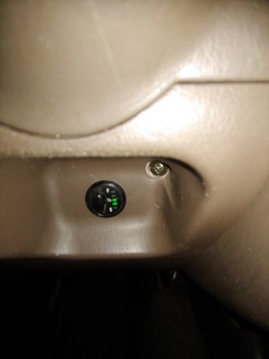

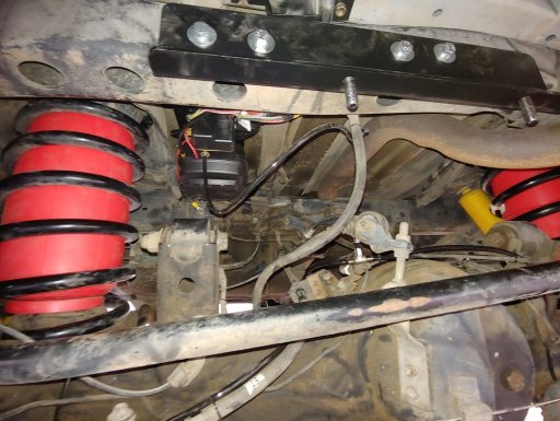

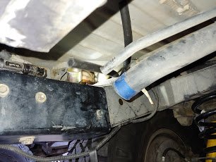

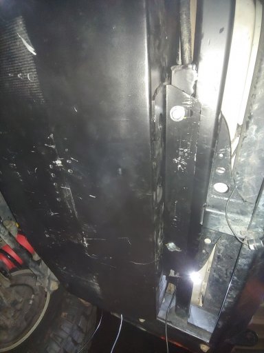

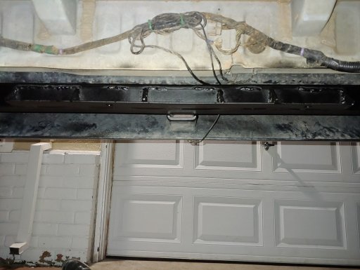

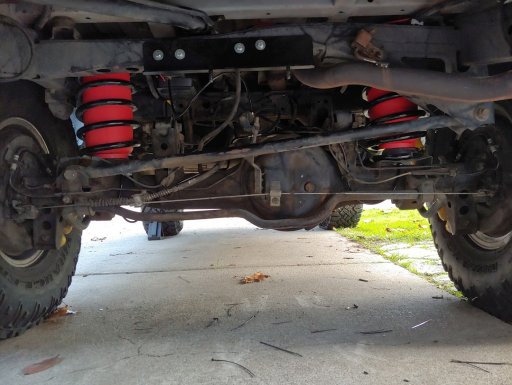

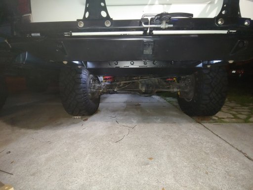

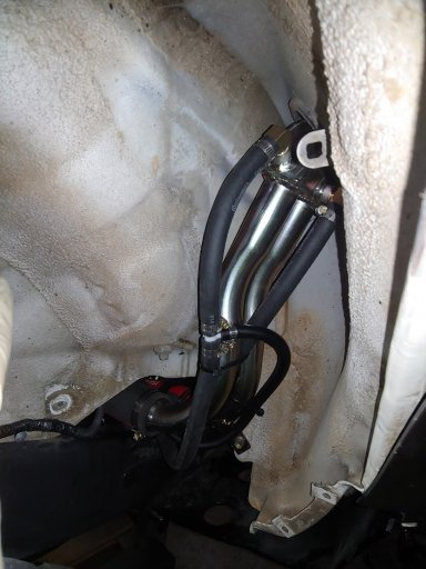

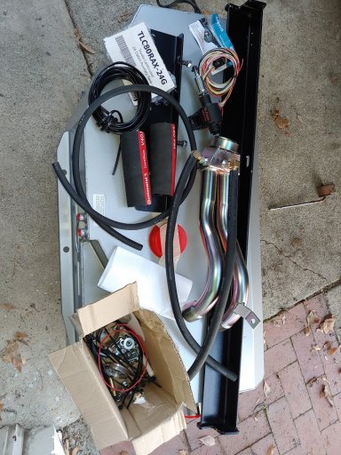

LRA 24 Gallon Aux Tank Install + AirLift Airbags & Wireless compressor to combat the extra weight. Fabbed my own bracket for the air compressor/regulator and couldn't fit more perfectly in that little spot right next to the spring.
The included rear bracket doesn't work with the 4x4 labs rear so I had to do a bit of fab and make my own rear bracket to hold the rear tank. I made sure it was strong and gusseted the crap out of the angle iron, then welded it to the 4x4 rear bumper. Had to make another simple bracket with nutserts for the ext. fuel pump.
20181211_155126.jpg 20181215_142628.jpg 20181215_162608.jpg 20181215_162640.jpg 20181215_184129_HDR.jpg 20181215_204438.jpg 20181215_204551.jpg 20181223_153451_HDR.jpg 20181223_153527.jpg 20181223_153625.jpg 20181223_190928.jpg 20181223_191028.jpg 20181223_192252.jpg 20181223_195554.jpg 20181227_213507.jpg

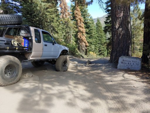

Rubicon @ Marlin Roundup 2018 (Crawler)

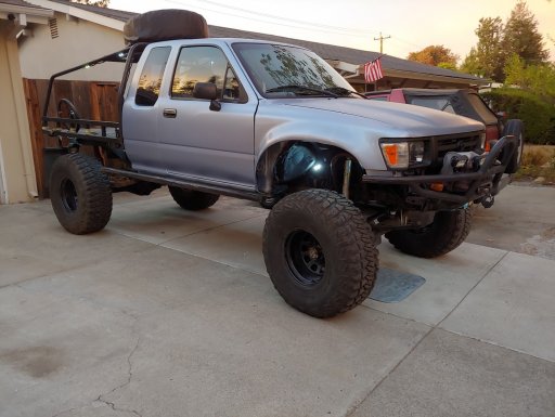

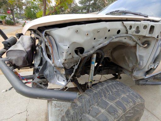

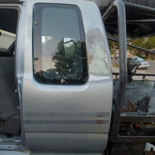

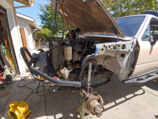

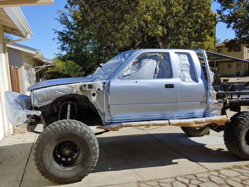

Oh and if you noticed my pickup (crawler) was a different color. I rolled it @ Rubicon a few years ago and crushed the A pillar. I never got around to doing a cab swap and just pulled it out with a PortaPower + put a new windshield with the help of my buddy. Right after Marlin Roundup I finally broke down and did a cab swap with my buddy and used his forklift. The new cab was hit in the front and radiator support was smashed. I had to sawzall my original cab and then splice and stitched welded it onto the new cab. I did a DIY paint job at home. Did all the body work myself using Miller welder, 3m Undercoating, Upol Dolphin putty and Upol Fiberal. Turned out pretty good for my first time.
I do not have a build thread for my crawler and barely have the time to even update Lux450 thread. But here's pics of some of project crawler's stuff.
20180928_113406_HDR.jpg 20180930_121106_HDR.jpg 20180930_143442.jpg 20181016_110549_HDR.jpg 20181031_181403_HDR.jpg20181002_171412_HDR.jpg 20181007_182331_HDR.jpg
