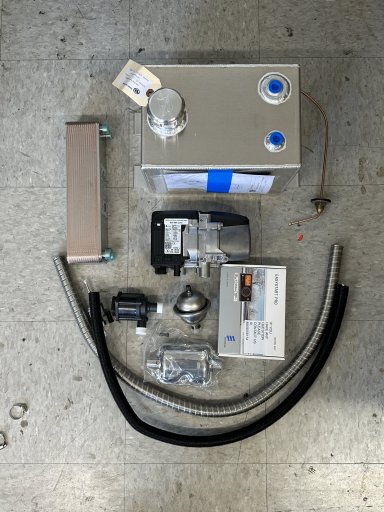

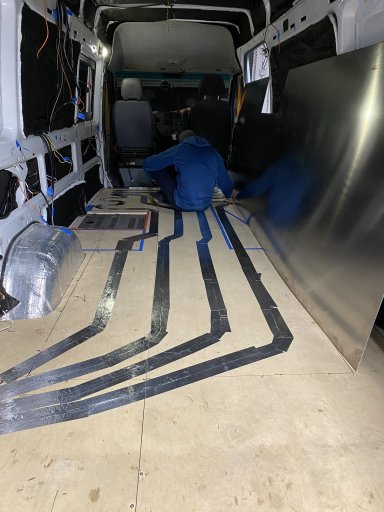

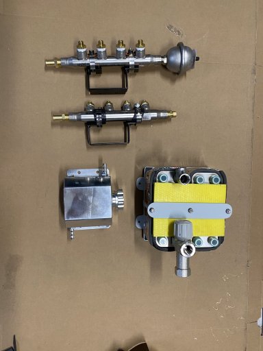

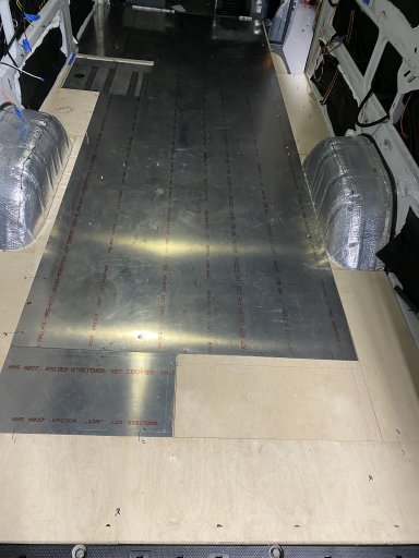

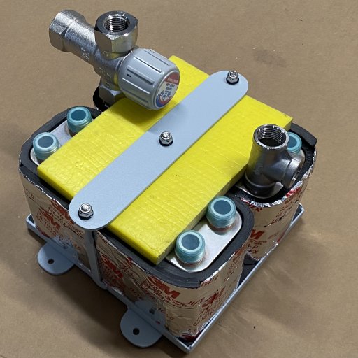

The DH is highly recommended. I’m installing a hydronic Espar diesel heater in a troopy build For water to air cabin heat and instant hot water. We used one in a sprinter van for cabin heater, radiant floors and instant hot water. Troopy will not have radiant floors. That thing is amazing and mounted under the body attached to the frame.
This is interesting. In principle, this is just like a diesel heater to heat the engine's cooling water circuit. But in this case, it's a separate reservoir of coolant and the whole thing remains independent of the engine. So simply a separate hot water heating with heat exchanger and fan for the interior or or a heat exchanger for heating water. Right?
Exactly. In a sprinter van we had one more circuit with a heat exchange for heated floors. Radiator fan heated the cabin in 10 min to 71F and shut off and floor was set to 74F. Thermostatic valve was set to 90F for the floors with an aluminum plate covering the 4 copper pipes. One heat exchange for hot water the second for the floors. Floors had a 1 gallon glycol tank as a secondary circuit. Van was at 74F with 1’ snow on the roof.
