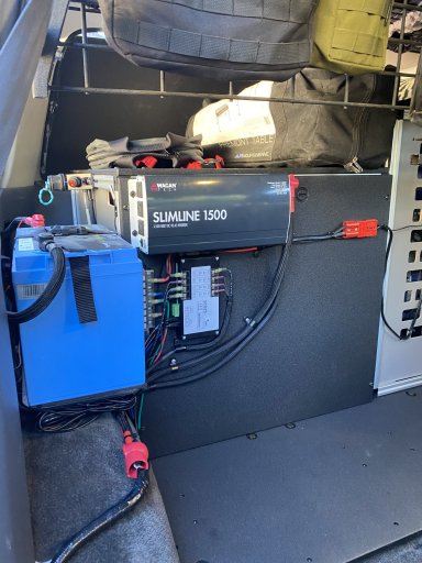

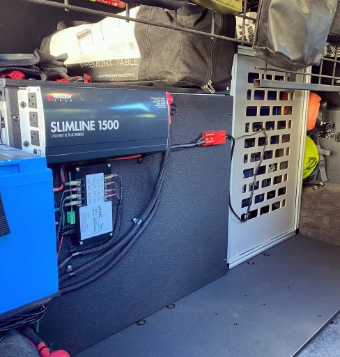

Been running a 100AH ReLion HP LiFePo4 battery for the last year or so as my House battery. We run a compact setup for my family of 4 in our FZJ80, but this easily powers all our needs with no worry. Running 100watts of solar on our roof and have a foldout 100watt panel also if needed. 25 amp dc to dc charger when the truck is running and upgraded my alternator to help with the extra power needs. View attachment 217976View attachment 217977View attachment 217978View attachment 217979

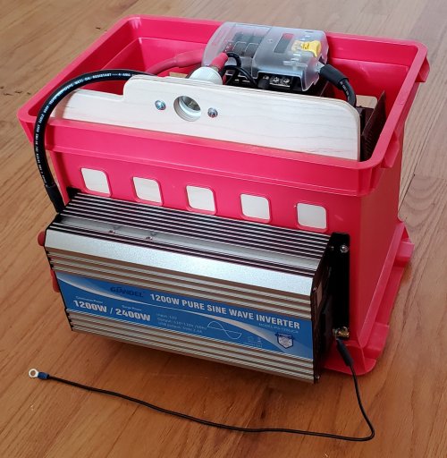

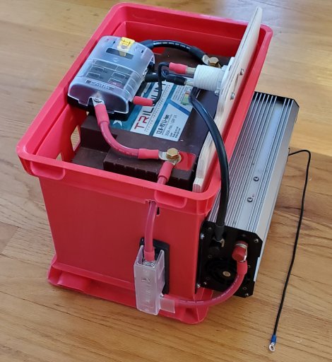

This is my standalone setup. The half milk crate holds a 92Ah Trojan Trillium LiFePO4 battery that provides power to a Blue Sea Systems 12V fuse block, which currently connects to one 12V cigarette lighter outlet. The battery also connects to a 1200W Giandel pure sine wave inverter via an ANL fuse. The inverter has a ground wire that connects to a ground point on the vehicle chassis.
This system worked well powering a 12V fridge/freezer on a couple recent 2-day trips (I didn't need the inverter on those trips).
