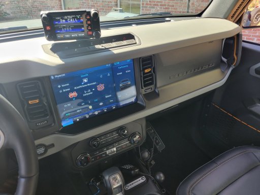

FTM-400 head on a ram x mount, Handset on a steelie ball, and radio under driver seat.
