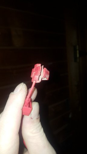

The real culpurit revealed itself tonight, the new sylvania led started hyperflashing on the passenger side(same led that went bad) those cheap clamp connectors weren't making a connection. I cut and stripped the wires and rewired everything my way now it works as it should with no chance of coming loose again. Now i just need to remember to do the drivers side so that dont happen again on that side.158319676040352847296.jpg15831967883471958441630.jpg

I think you should probably differentiate between OEM lights designed around LED emitters, and bargain drop in hokum because they are not the same.
ETA: I see that you have indirectly done exactly that. "LED" isn't a measure of quality, poor quality and bogus wiring will almost always yield unsatisfactory results.

The real culpurit revealed itself tonight, the new sylvania led started hyperflashing on the passenger side(same led that went bad) those cheap clamp connectors weren't making a connection. I cut and stripped the wires and rewired everything my way now it works as it should with no chance of coming loose again. Now i just need to remember to do the drivers side so that dont happen again on that side.View attachment 142704View attachment 142705
Glad you found it. It does look like a piece of worthless crap. I'm also glad it was bad wiring and not the led lights. I think I would cover that connection with silicone too. It looks like a lot of water and mud was in the connector at some point.
No the led was crap too see the photo above in the post. It had bare wire rubbing inside and came apart way too easy. Ive switched from the junk leds over to sylvania leds that have an aluminum housing instead of plastic.
There is always water n mud on my truck everywhere, probably 40lbs of it right now in various nooks and crannies .

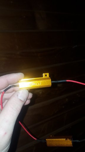

The sylvanias were only like $15 @ autozone . On the rear tail/brake lights did you install a 50 watt 6ohm load resistor on each led? Since your rigs a little older the led specific blinker relay may be the ticket for you.
On the older vehicles, I use an electronic flasher. I refuse to use the ballast resistors. Not only do they defeat the reason for the LED but, they give the conversion more areas to fail. A common misconception on the resistors is you need them to drop the voltage for the LED. Their purpose is to keep the power draw the same as a regular bulb so the flasher is the correct speed. The down side of the electronic flashers is, if you burn out a bulb, you most likely wont see a change in flashing speed.
Well on the computer controlled stuff there is no flasher relay so if you go to led you have to use a load resistor otherwise there is hyperflash and an annoying message on the dash everytime the turn signal is on. The computer sees the led as a blown bulb since there is so little voltage being drawn and that triggers hyperflashing the only ways to defeat it is dont use leds or install a load resistor in parallel.
Sadly, you are correct. I hate having to diagnose these. You ask the person (customer) if they have done anything (modified). The response is almost always no. Once you figure out they replaced the bulbs, they argue that their friend doesn't have that issue with his vehicle and that you obviously are wrong. Your choices at this time are, install the correct bulbs and show them or let them leave mad. Either way, your not getting paid. I not only see this with tail/running lights but with dome lights also.
You use LED because their more efficient. Then you lose your gain by being forced to use a ballast resistor. I'm glad the vehicles I own, I can change to a different flasher.
