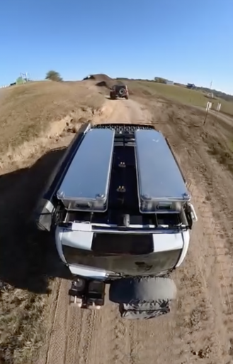

Hope you don't mind me bringing back an old thread, but I've started researching some conversions for my LR3 and I'm thoroughly impressed by your set up here. Also a few extra questions beyond he conversion... what roof rack basket set up for you have on your LR4, and where did you get that shelf set up you have on the ceiling in the back? I've been researching basket racks and yours looks great. Additionally, I had never seen the ceiling shelf before and am very intrigued!

I have a voyager low profile roof rack. It isn't a basket. I have Zarges cases which you can buy through the Overland Bound store via custom order (or you used to be able to, its been awhile). I have a custom made max trax mount on the front of my rack. I have the 23 Zero 270 awning on the driver side and the shower tent on the passenger side. I can store a tent in the middle and I also have a shovel mount in there.
