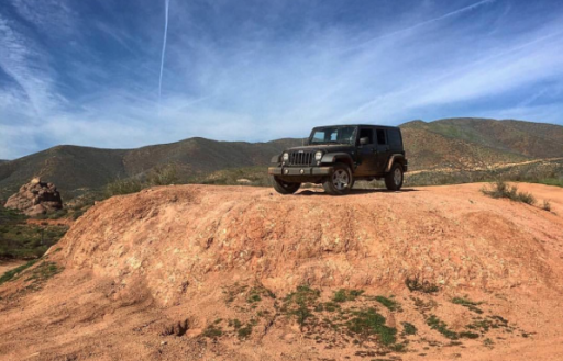

I have a 2012 (3.6L) JKU Sport with a 3" Puck Lift, 19/63 springs, Rancho RS5000X Shocks, 3.21 gears and Auto. I am not locked, nor plan to be for some time, and regearing. I am happy with my gearing as I do a lot of highway mileage for DD. I have been on many rock crawling trails, country roads, overland routes, Death Valley and also tow a 3500LB Tent Trailer to the mountains and beach several times a year. I have been very happy with my rig and although I do not attempt EXTREME trails, obstacles or routes, I am happy being able to successfully complete Moderate to difficult routes with few challenges.
I also run:
-Warn Rock Crawler front bumper, stubbied down on the ends by about 6" on both sides for approach angle.
-Smittiybilt XRC 9k Winch
-ORFab Rear Tire Carrier (unfortunately ORFab went out of business, but the tire carrier is one of the best-carriers one or two 5gal tanks or 1 tank an Ammo can as my setup. It also fits my 35" spare and I have mounted a Mikeybilt (homemade) Trail Rack to the carrier as well.
-RockHard Patriot Sliders/Steps. These have saved the sides of my Jeep countless times and although body mounted, they can withstand the weight of the Jeep and pivoting on them around an obstacle.
-Roof Mounted/Gutter mounted roof rack
-Other bells and whistles.
The JKU are very capable rigs! Go out and explore, see what works for you and what you need for your type of offroading.
