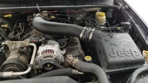

how is the airaid modular tube doing for you? Throttle response or MPG wise..
I have been on the fence about getting one for years. You can also upgrade the inlet from the grill to the airbox as well.
Sorry for the slow response, started a new job 2 months ago.
It has been great, like i said about 1PMG gain and slight throttle response, plus it sounds great!
