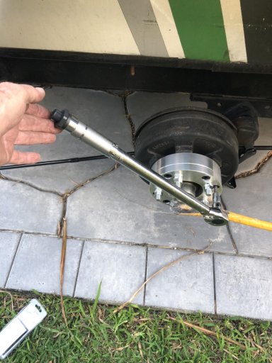

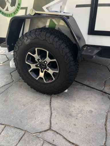

Hey Guys! I have and update! I ordered a set of adapters to fit the 6 lug hubs on the NoBo and the 5 lug pattern for the Jeep. Did the install yesterday and fit my spare wheel from the Jeep on the trailer. Picked up 5 wheels and tires from a 2018 Jeep Wrangler and put two of them on the trailer. That gives me 2 extra spares to use on ether the trailer or the Jeep.
Reactions: 64Trvlr

Hey, you're missing a couple of lug nuts! :blush: I need to go the other way, i.e. adapters for Toyota wheels but it will throw them too far out from the fenders.

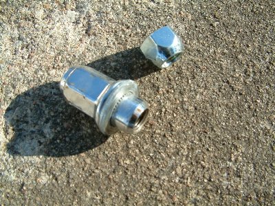

If you are building an axle.... match the bolt pattern, you are using factory rims, the hub/lug centric thing does not matter.
Pick the correct lug bolts to match the rim, either tapered for steel or shouldered for a mag.

2) if you are using mag style lug nuts (which my Rover does) it is CRITICAL to have a hub centric mounting surface because there are no cones to self-center the wheel. is it close? Yes. Is there play? Yes.
