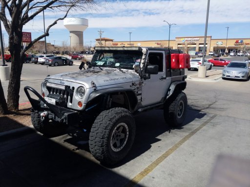

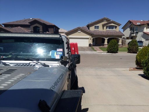

So one of my problems with my Jeep JK is that I have a small gas tank and that means limited range, 200 miles normally. Being a 2 door, not a lot of room. But its mine and not changing it anytime soon unless someone wants to give me something.
So I had done many different things but I think I finally have it solved.

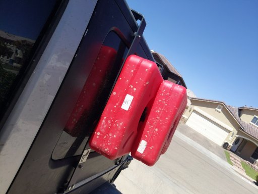

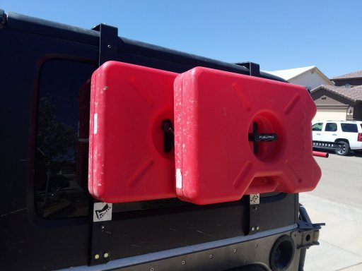

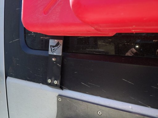

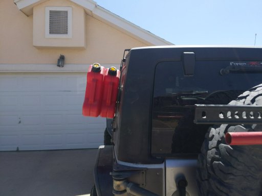

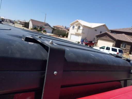

Trailrax, this provides a mounting system on the side of the Jeep that you can mount Rotopax. Whatever you want them to be, its up to you. For me, I have 2 4.5 gallon Fuelpax and 2 3.5 gallon Fuelpax which in turn gives me a tank of gas on the outside.
So I just had these on for the Camino del Diablo and it was nice to not be worried about fuel. Need to fill some up, take one off and fill it.
I will say I replaced the CARB fuel nozzles with a Scepter fuel nozzle I found on Amazon and works great.
