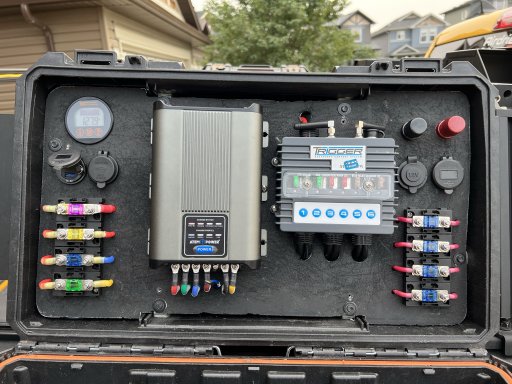

So I had a thought last night ….
I’m thinking of adding a continuous duty solenoid to the charging circuit as a backup incase I have another dcdc failure on a long trip, my thought is that then I can just throw a switch and when the truck is running it’ll charge the house batteries and isolate the start battery when things aren’t running.
Just an old school backup you might call it.
The management panel I built has the space to accommodate this easily.
it still looks a little sloppy to me but I kinda rushed some of the fab work to make my last trip, I have plans to cut a new panel that fits a little cleaner.
I wonder if you could replace that switch with a relay energized by the truck's accessory power so you don't have to remember to flip the switch? Nice work!
Actually,
My trigger system is already wired to an ignition source, and can set to stay on or switch off with the ignition so that part is already covered. That way the switch can stay off unless there’s a failure and then be switched on and not have to be thought about again until repairs can be made.
