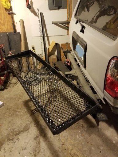

You might be overthinking the weight. After removing the rear hitch and bumper, my custom bumper + swing-out only added like 35lbs. Mine is pretty minimalist, but I still wouldnt expect more than 75-100 lbs added to the rear for even a heavy-duty bumper. And, similarly, adding a 150lb bumper to the front might only add around 110-120 lbs of total weight after removing stock stuff. A winch is another 90 or so with a steel cable, or about 65 with synthetic.

Just wondering, what rear bumper do you have, since it only added 35lbs? That's quite impressive.

I made my rear bumper. I have about 15lb of material left to add for side protection, but overall it is pretty minimalist. This includes the rear swing-out tray. 20180422_033054.jpg
