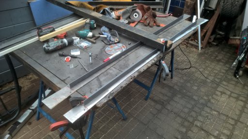

Made simple brackets that are mounted on the excisting mountt holes.
Did cut them and made an extra angle steel to hold the cross bars.
Started welding in the middle, as that is the smallest hight between roof and rack.
Done with welding and painting

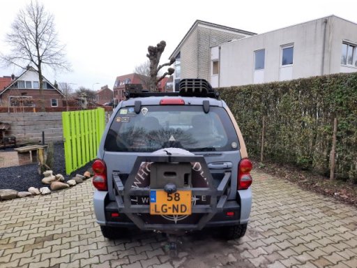

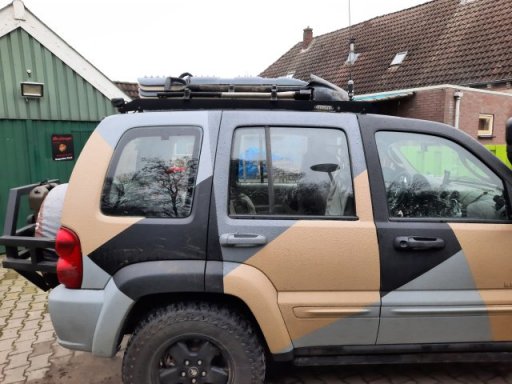

View from the rear.

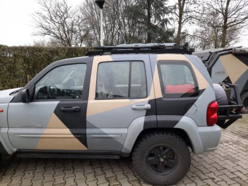

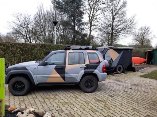

View from the side/front.
See how low the rack is.

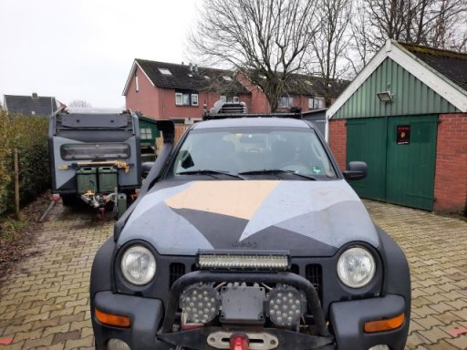

View from the front.

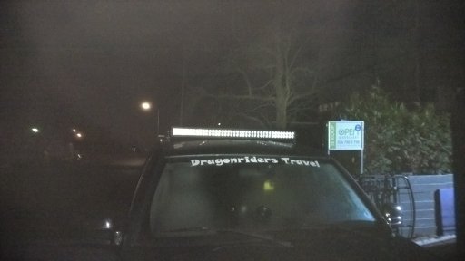

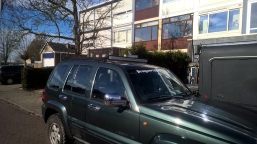

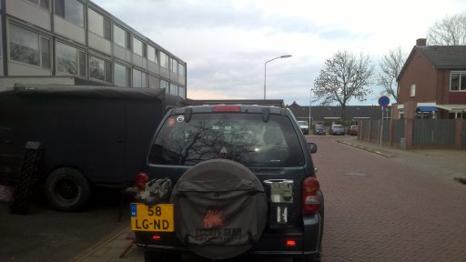

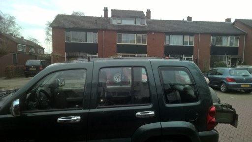

This was the situation with the old lightbar, in 2018.
This is the situation now.
Total height of the rig is less as 205 cm. which 80.71 inch.
Because of that the Rig fits in most parking houses when the antenna is down. including sand boards and everything on the roof.
