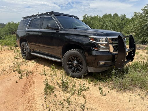

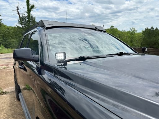

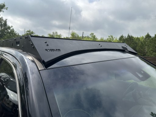

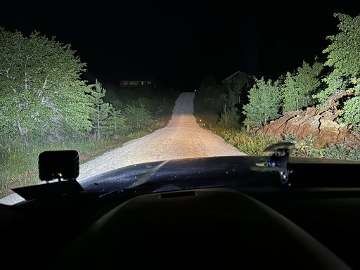

Third time’s the charm for ditch light brackets for thethirdtwin. Third vendor’s product actually is correct for this rig. A little bit of travel rash, but THEY FIT.

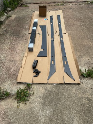

I’m not sure what that last picture is looks like some kind of radio equipment and some long poles but it definitely looks like a project. I look forward to seeing it in person I’ll be out on the trail starting Friday if all timing goes correctly getting the new off-road trailer either heading to Overland Expo west or the high desert get together with @coyoteWorks and @adventureswithRoscoe. Then I’m heading south along the Heading to Northern California area.

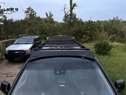

Lol. There’s at least 3 projects in the photo. Main item is the unassembled roof rack.

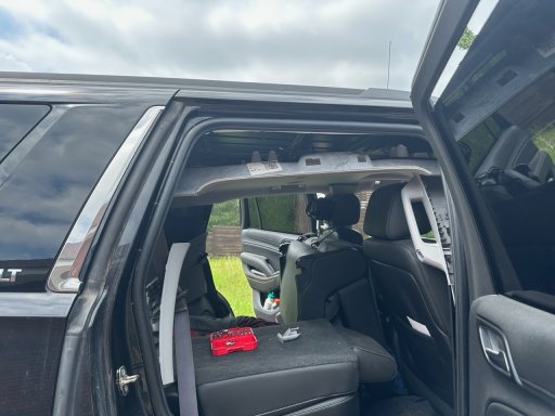

I’m really interested in this roof rack but not interested in removing the headliner and drilling holes.
Depends on your vehicle about the headliner. Thecopcar is all from above using nutserts. GM changed the mounting to nuts from below for the K2 generation. Grrr.

Drove some yesterday, the wind noise at 60 was really noticeable. I slid the deflector closer to the roof, plus added the trim piece.
Got out in it today. That slight position change also made a positive difference in XM radio reception. Plus much less wind noise.
