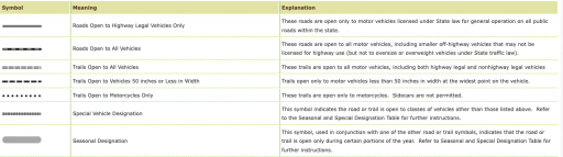

I haven't done it yet, but there is supposed to be a slight detour that goes around the 50" bridge. I know people do it in jeeps, pickups, etc.
The pictures I saw show a normal bridge, with big concrete blocks on it to make it narrow. We have some 50" trail restrictions out here, I believe that is the purpose of the blocks.
Executive Director
Here is the MVUM info regarding 50" ID for tracks
